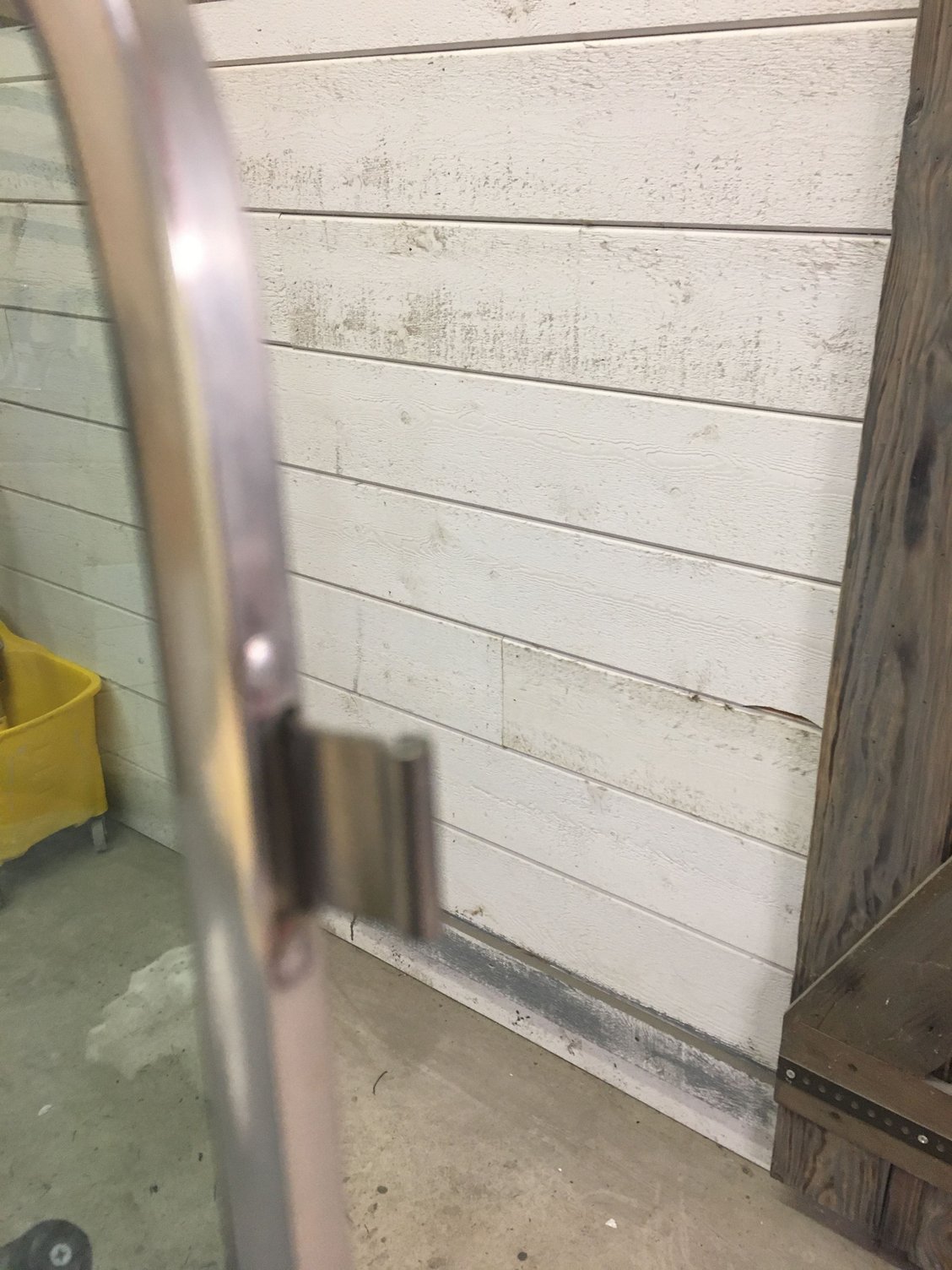

75 Supercab pop-out windows, are the hinge post suppose to be solid??? Both sides my lower post wiggles side to side? Tops are Solid.

You appear to be missing the plastic inserts. Do you have any better pictures?

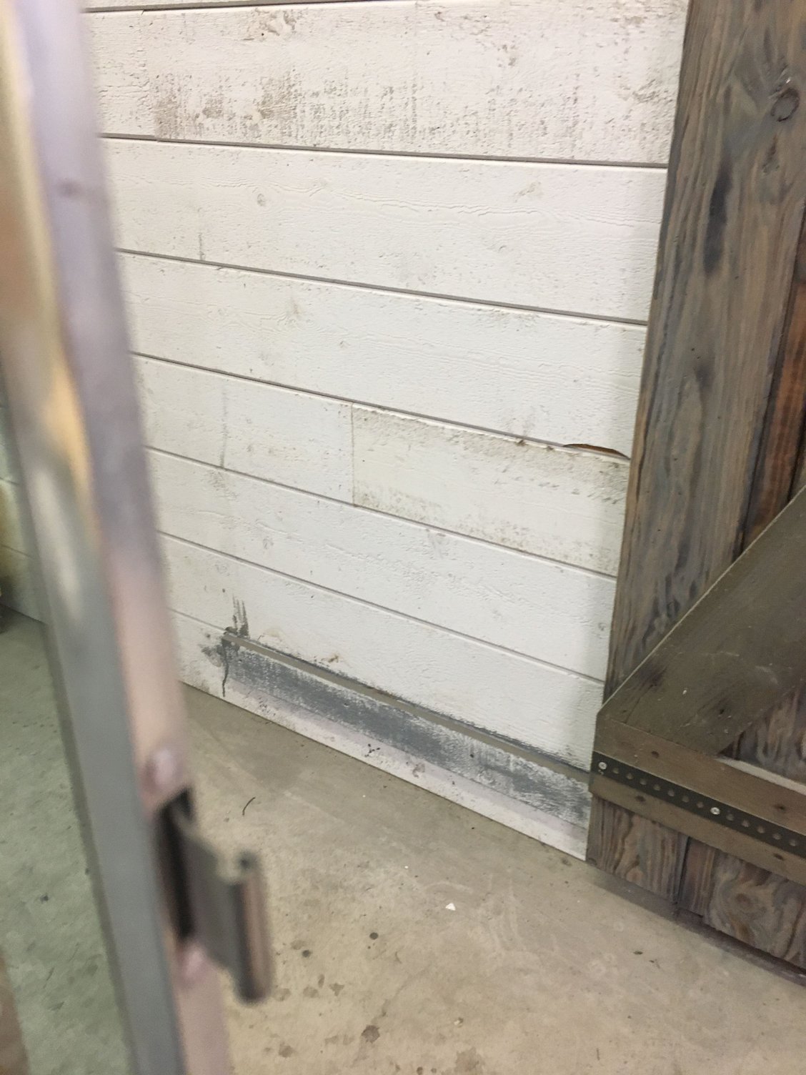

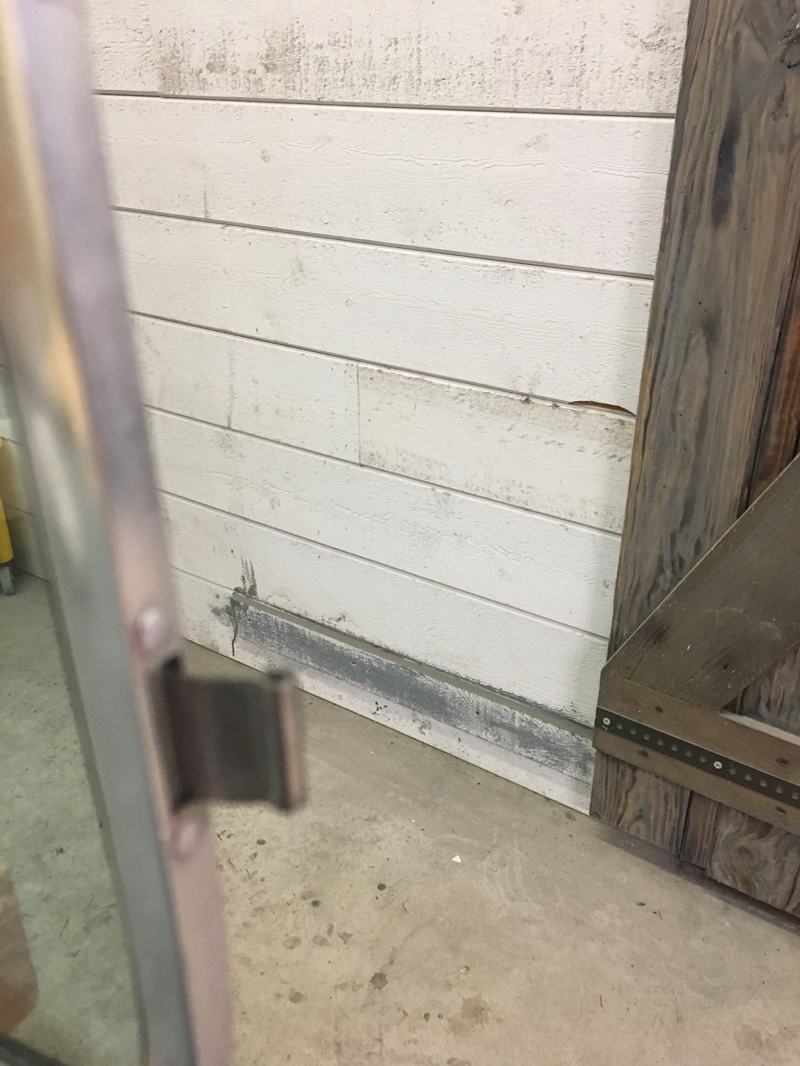

Yes I do have the plastic inserts. My concern it the metal post that sticks out, that the plastic insert attaches to. The top one (top picture) is solidly attached to the window molding and the bottom one wiggles back and forth. The bottom 2 pictures show how much it moves from side to side. Both sides of the truck are like this. Is that normal? Should both the top and bottom be solid?

Mine were the same way! I didn't like it so I mixed up some epoxy and filled it up and let it harden and haven't had any issue's

I can't tell, are they spot welded on or riveted?
If it's welded I'd just epoxy it.
If they're riveted, put the head down on something hard. Use something like a ball bearing, round head screw, etc. that is slightly too big to fit in the back side of the rivet and tap it with a hammer to crimp the rivet more. Or use a small punch and work your way around the rivet. You want to squish the rivet out and down to crimp both the sides of the hole and the face of the trim. If you just hammer it flat, it won't be tight to the walls of the hole and could still shift side to side slightly. I'd probably throw some epoxy on it after recrimping the rivets also, just as insurance.

Thats was a great work around. I didn’t want to disassemble the frame and rivet. The epoxy fix was the trick, great advice, Thanks.
