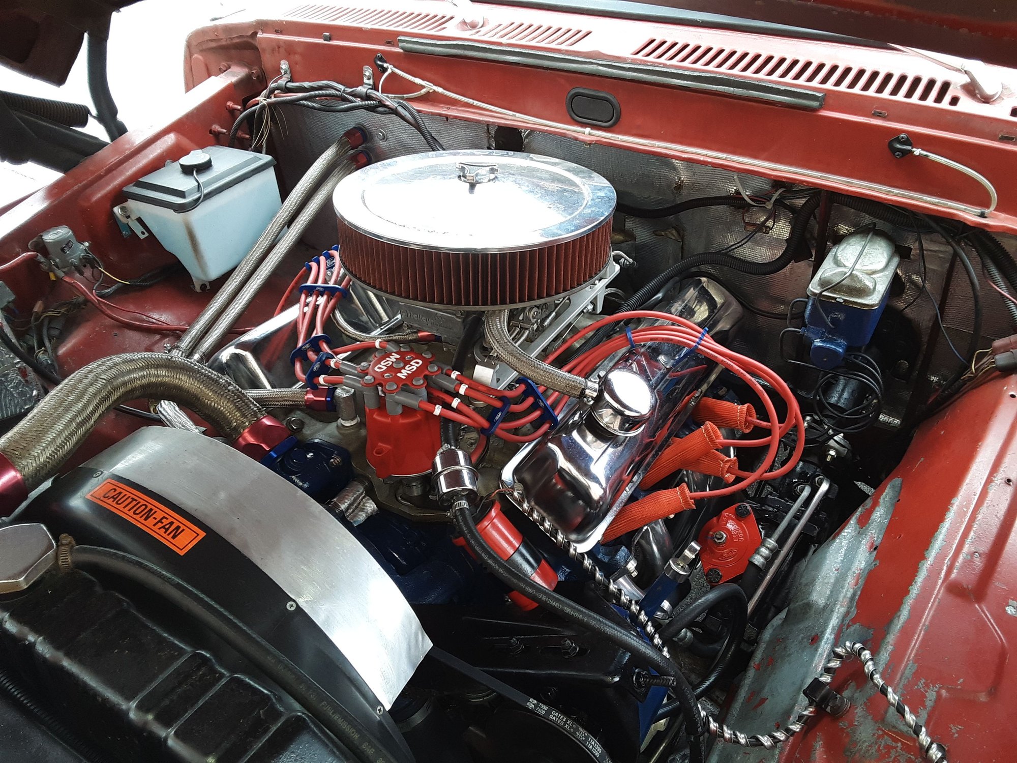

Thought I'd share some of the work I've done so far. Paint and body is all that is left.

Drvie shaft is always turning while in motion along with part of the trans.
Nice looking truck
