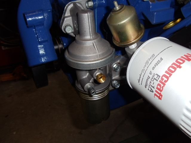

hi ya'll, once again i turn to this great site for help.
i'm working on a 1974 f100 360, c6, 9" rear.
i think i've found the oil pressure sending switch. i believe its on the oil filter spin on mount. is that correct? there is just a plug in it now and the aftermarket gauge is not hooked up nor is the factory one.
also, there is a canister mounted in the core support/passenger side fender area under the hood. there is a hard line that is attached to it and , i think to the fuel tank. what is the can and what does it do?

Correct. On the FE engines (360/390) the oil pressure sending unit is mounted on the oil filter adapter.
On the canister, I think you'll find it's attached to the frame rail. That's the charcoal canister for the fuel tank evaporative emissions control. There should be two lines to it. A 5/16" line goes to the fuel tank, a 3/4" line goes to the side of the air filter housing.
This sending unit is for a gauge, the unit for a warning light is smaller.
