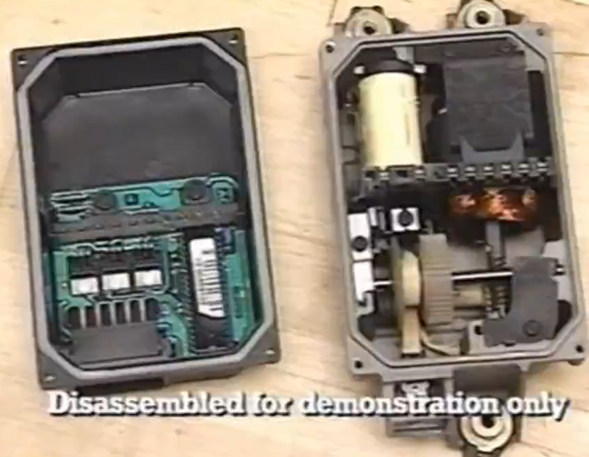

I also do not have cruise from factory, and would probably integrate an aftermarket or try and adapt a GM gear driven tape unit from the 90s-2000s
They were compact rectangular boxes and had fairly universal wiring, with a failsafe tied to the CHMSL on non gmt400 trucks (basically everything else)
would sadly require a switch of some kind to operate, doubt the steering wheels with controls from ford would work because of the features on the GM's stalk wouldnt map to the buttons
