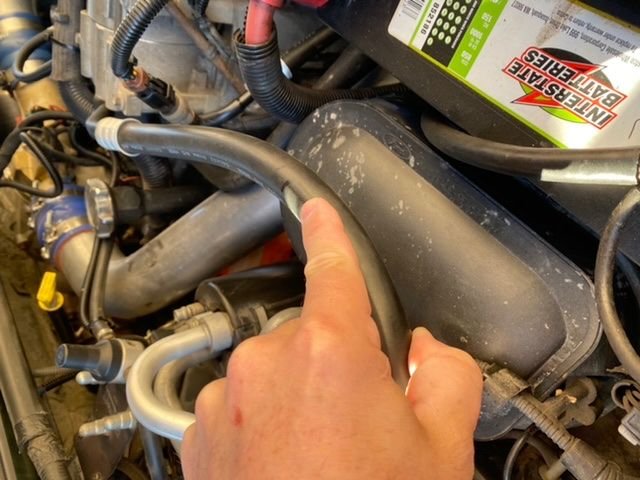

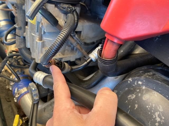

I live in AZ and my A/C manifold hose had a crack in it, also the switch in the picture had a loose connection that would kick the compressor on/off randomly depending on how the plug was wiggled so I replaced the plug pigtail and it solved the problem.
sorry the pics are sideways.
