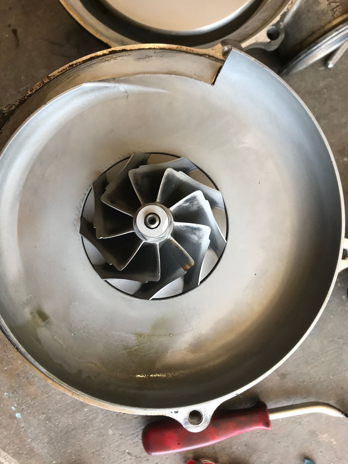

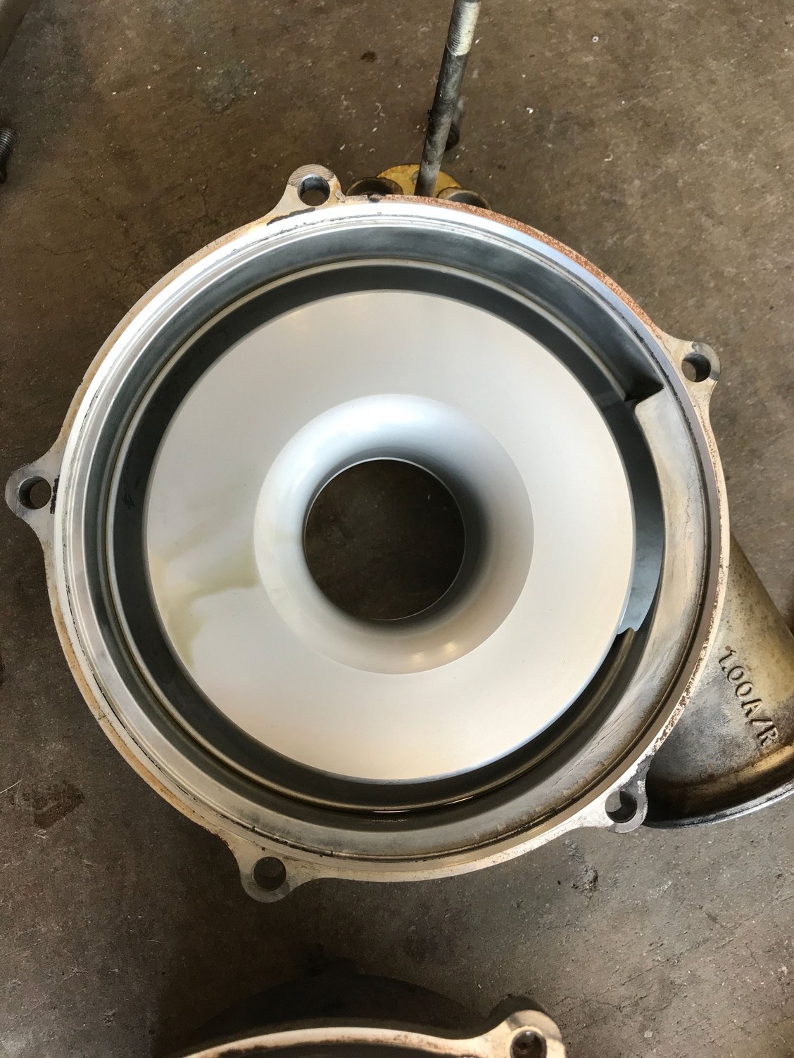

Good news no damage inside the turbo
Old May 17, 2020 | 03:08 PM
Listor's Avatar
Listor
Joined: Sep 2011
Posts: 1,613
Likes: 106
From: Albuquerque

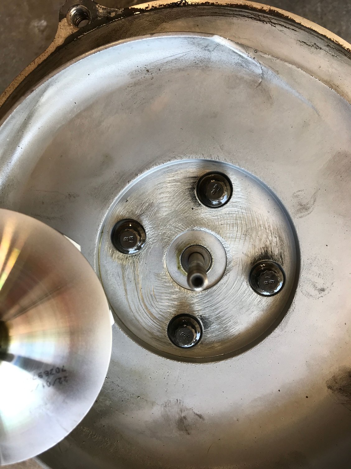

Hmm is that normal?

Yeah that wheel is toast. Stock air box?

Not only is that wheel toast, it's STOCK!
Get a billet wheel from RiffRaff or somebody, please!
Plus the big o ring that seals the perimeter of the housing, best to go new there.

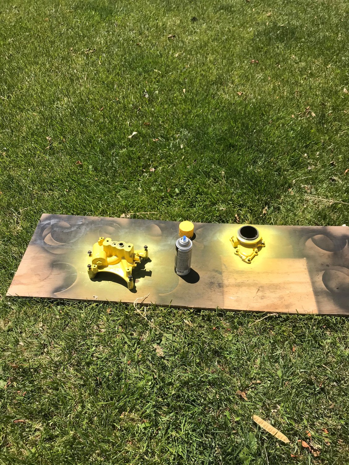

Originally Posted by Listor
got them i figured out i was using a 12 pt socket , of course now i need a tap for wastegate , jason will appreciate the final product
YELLOW!!!?????
Lol.
Youll need VHT Flameproof 2000* paint for the hot parts.
yes stock airbox that is missing parts, will be upgrading that soon too

YELLOW!!!?????
Lol.
got it covered, yellow will look great the the red boots from riff raff, beside i can see any leaks easy LOL
