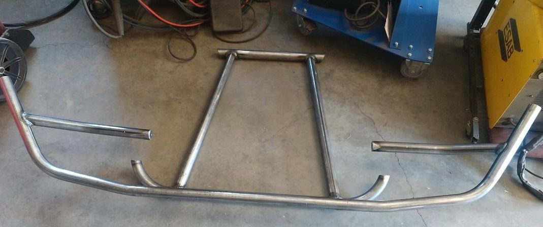

Bumper sitting on the floor. Construction is 1.5" HREW

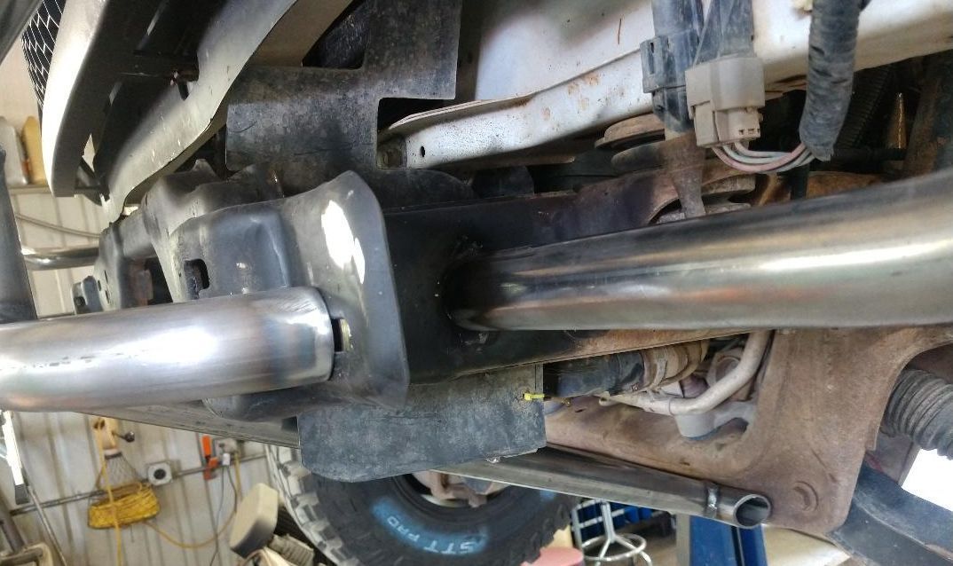

Attaches to a previous forward-facing bumper bracket and a slotted hole in the framerail
Center of vehicle looking toward driver side, framerail bolts are accessed thru hole-sawed windows

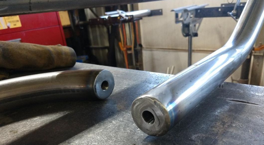

The two attachment points show above are threaded inserts, 1/2-20 in this case. Being that I'm technically a machinist I just made the inserts on my lathe(s).

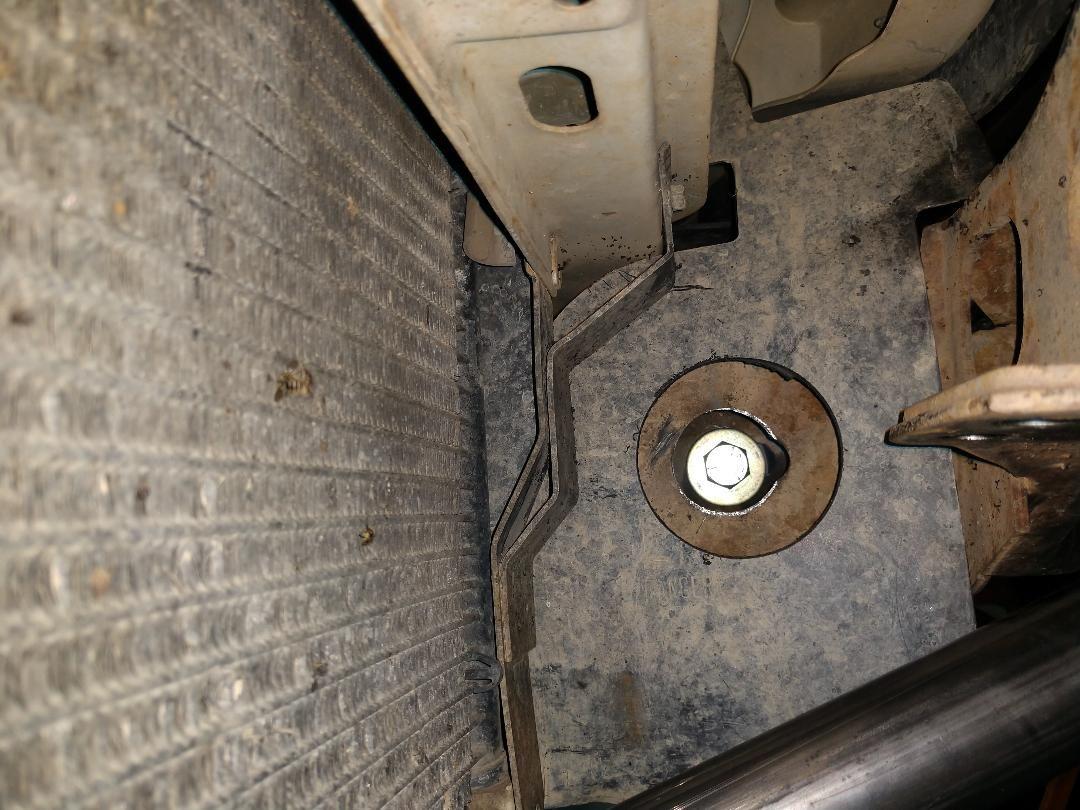

Skidplate bracing utilizes these two existing holes in the factory crossmember. I'm sure I'm not the first to do this but I didn't look at other aftermarket designs.

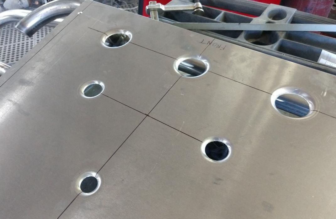

I just came up with a simplistic and minimalist layout for a few skidplate holes, dimple-died. In highsight should have striven for more of a triangle design.
