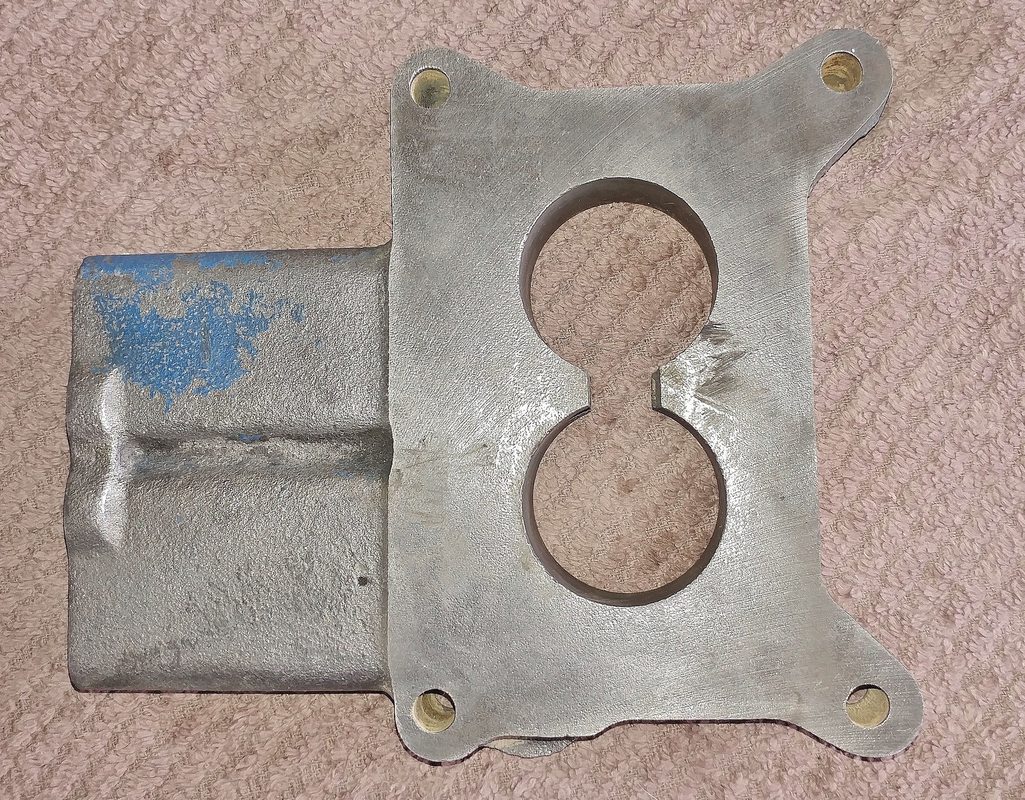

I couldn't find an application by part number for this spacer, any ideas...D7PE-9A589-JA

Spacer, carb to intake manifold
P/N D7PZ-9A589-J marked D7PE-9A589-JA
Motorcraft P/N CM-3035
Fits:
75-76 F100 w/ 360-390 w/ 2bbl carb
75-76 F150-350, M450 w/ 360-360 w/ 2bbl carb from S/N W00,001

It's the EGR plate and they often burn out internally, especially the aluminum ones.
