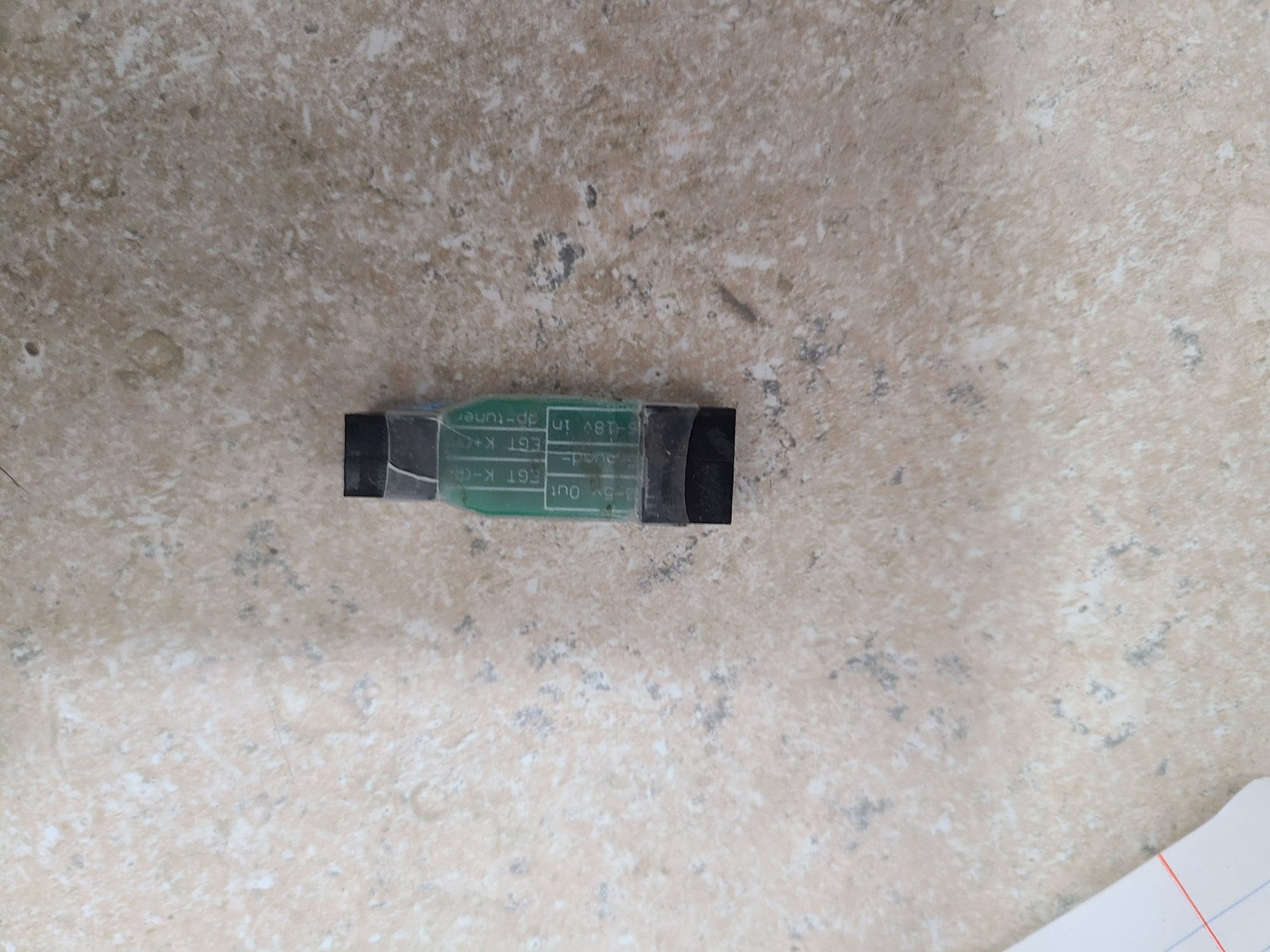

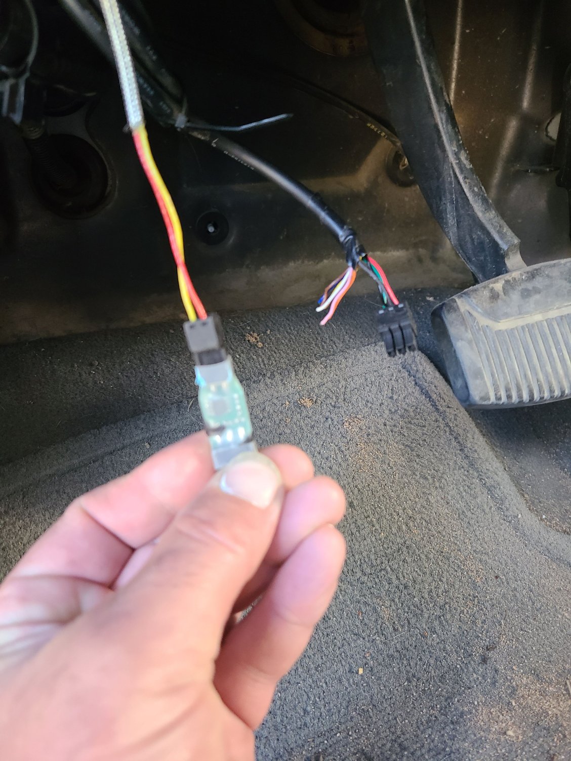

Probe shows continuity and volts climb as i increase rpm. Thinking probe is good.
Whats this. And how do I test it?

That is what we engineers call a doohickey. Almost all doohickeies are proprietary and cannot be tested. Their sole purpose is to be a continuing revenue stream for the manufacturer because you have to buy a new one on a regular basis.
I keed I keed. Seriusly though, that says DP Tuner on it so I would call DP Tuner up and talk to Jody.
lol.
No doubt.
I did figure out its some sort of amplifier.
I'll call jody but he's no longer authorized to work on the infinity tuner. Or something like that.

Allow me to revise my statement:
That is what we engineers call an obsolete doohickey. Almost all obsolete doohickeies are proprietary and cannot be tested nor is there any point since you cannot get them any more. Their sole purpose is to be a continuing revenue stream for the manufacturer because you have to buy a new one on a regular basis frustrate the ever-loving crap out of you.
Well, I would still call Jody since it's a DP-Tuner branded item. That's probably an add-on of his own to the Infinity.

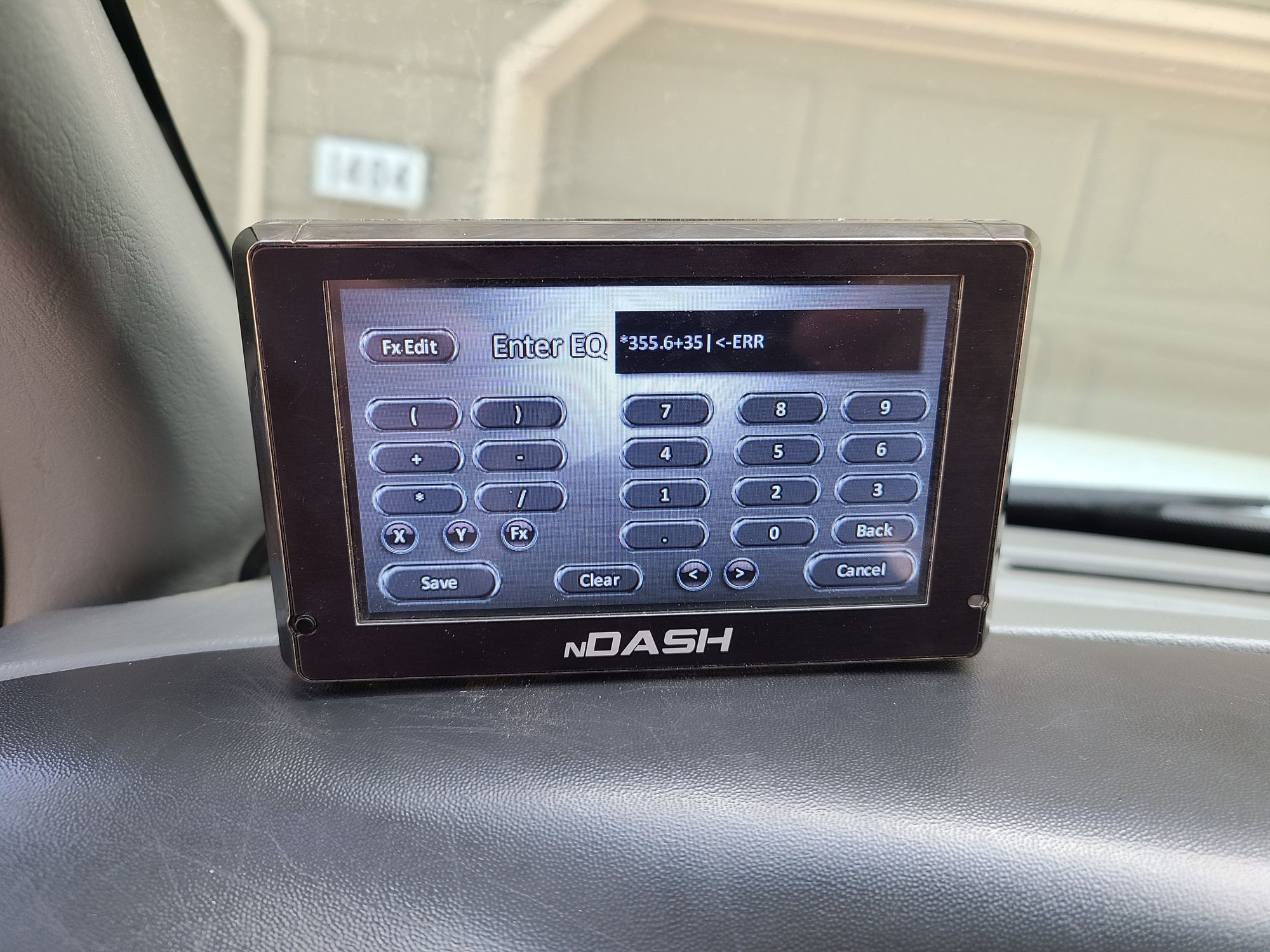

Spoke with Jody.
You can set the formula for the tuner to convert volts to temp. Apparently my formula was wrong.
Corrected the formula and all is good.
