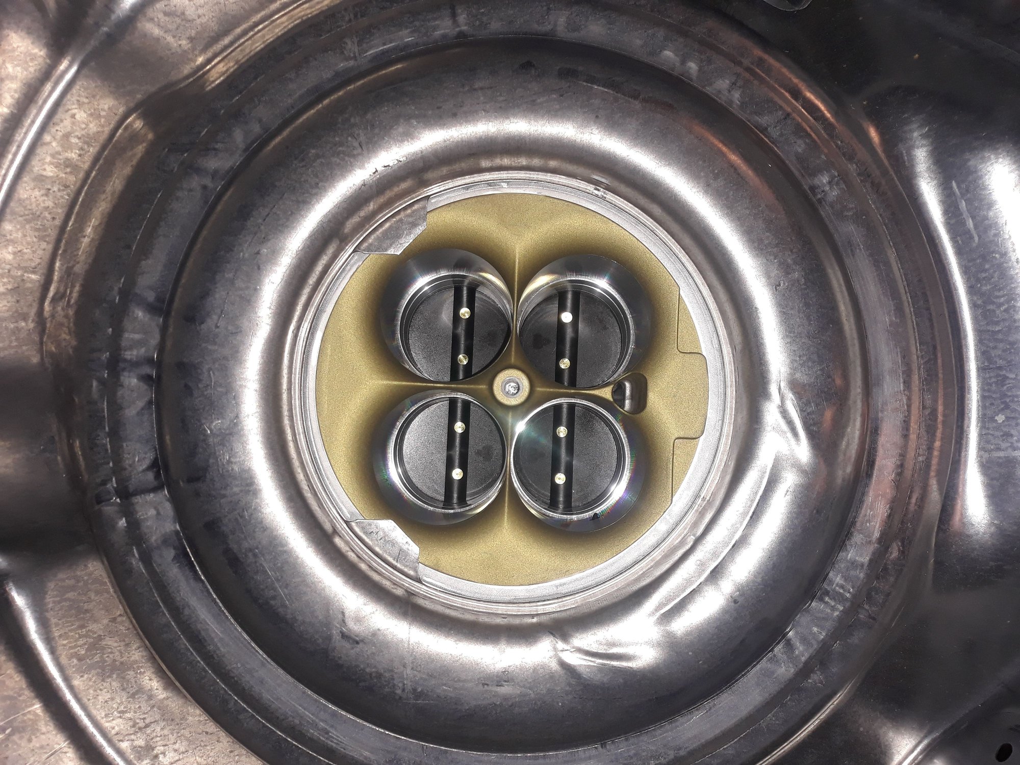

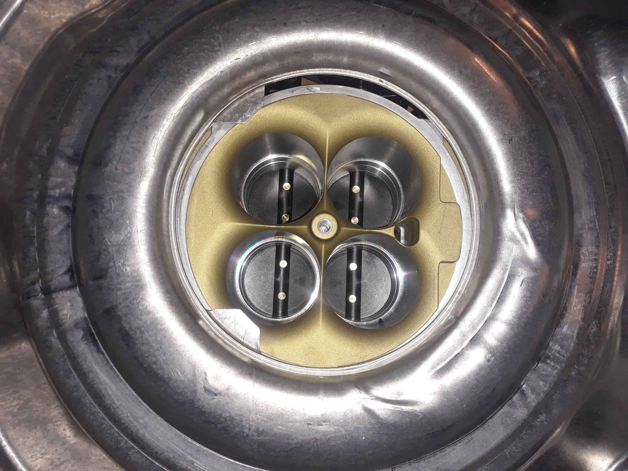

That's the thing I don't know what this air filter is for. the box its in says E1TZ-9600-AJ which is what I need for my 302 and it will also fit a 351w. The sticker on the air filter says E3TZ-9600-TA. I looked at all ford trucks with V8`s on the parts guy and saw no TA code in there.
I measured the air cleaner where it mounts to the carb and center to center shows 5 9/16" for the mount. The Sniper Stealth I have which is basically the same size as a 4150 carb measures at its smallest of 5" and at the edge of its flange 5 1/2" which puts this aircleaner very close to fitting. I think to make this one work I would have to make an adapter plate that is 5" to fit the throttle body then have it circular out to 5 5/8" to give the aircleaner something to sit on. But to do this would require I position the aircleaner then mark the inside of the adapter to place locating pegs to position the airfilter properly.
This is a photo of the airfilter base sitting centered on the 4150 Sniper Stealth.
And this photo is shifting the aircleaner all the way over to one side to show how much larger the aircleaner carb mounting is compared to the 4150 Sniper Stealth.

I think the air cleaner you have is for a variable venturi carb, I am pretty sure they were bigger. You should have no problem finding a air cleaner to fit your throttle body. I am not sure why you would want to build a high performance motor and the use a single exhaust and a single snorkel air cleaner?

I take a look at that, I dont mind if the air cleaner sits up slightly, probably need to anyways as it feels like the simulated float adjustment screws are just barely touching the NOS aircleaner.
