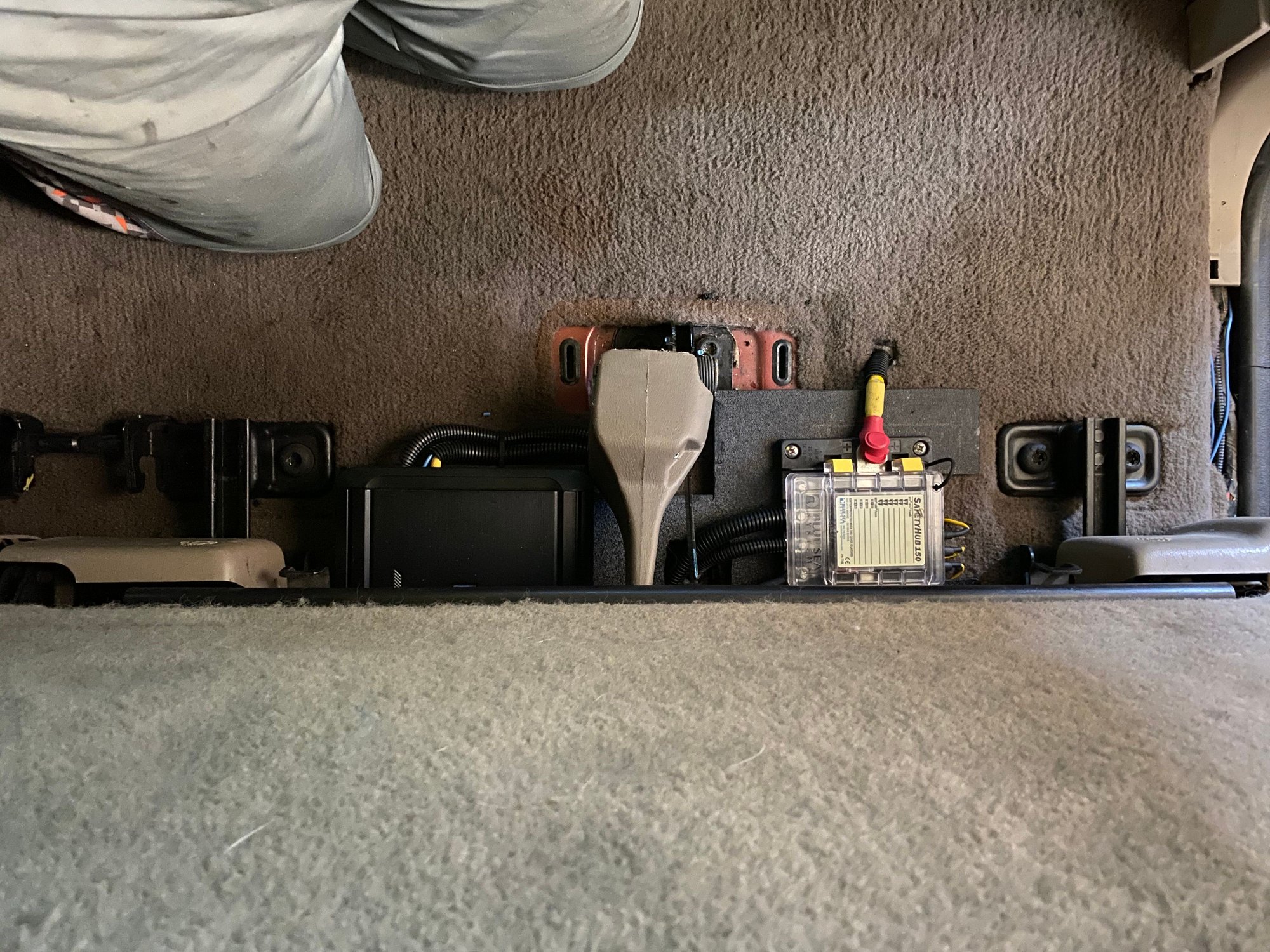

2nd row power distribution project is a success. 2g power cable good for over 125A. 2g ground direct to existing frame hole, I just tapped it for 3/8-24 fine thread. For good measure there is a lock washer and nut as well. All floor holes were painted then I added grommets, and auto grade loom. Don’t bother with the crap from autozone or walmart, its wont survive the heat. Auto grade is denoted by the white stripe.
Black mounting plate is just 1/4” ABS plastic. Non conductive and easy to work with common tools.
Those who contemplate this project remember a few of these tips:
The belts fold flat with the seat. The seat slider mechanism is just a bit wider than the track. I forgot and had to turn amp 90* so nothing would be caught by the seat track as we camp in the back.
Questions comments
