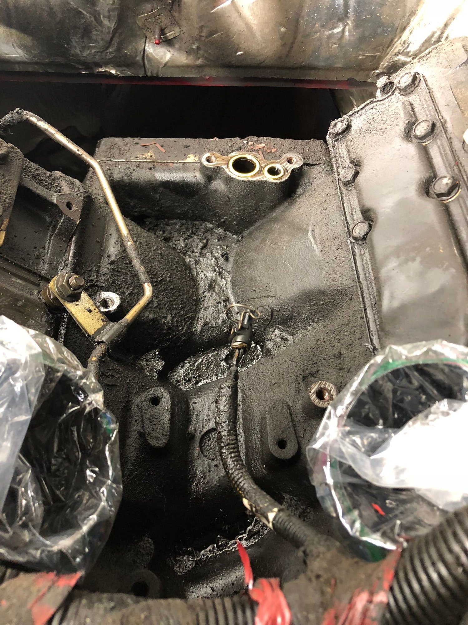

There's lots of parts you can just throw at it to cover all your bases for your leak and we can help spend your money but if you want to save the blow to your wallet, clean the valley real good and monitor where the leak is coming from. Inspect passenger side fuel line. The clamp can rub a hole in the metal line (make sure that's not your leak mixing with old oil on the valley. If truly fuel, also look at fuel bowl potential leaks and reseal kit.)

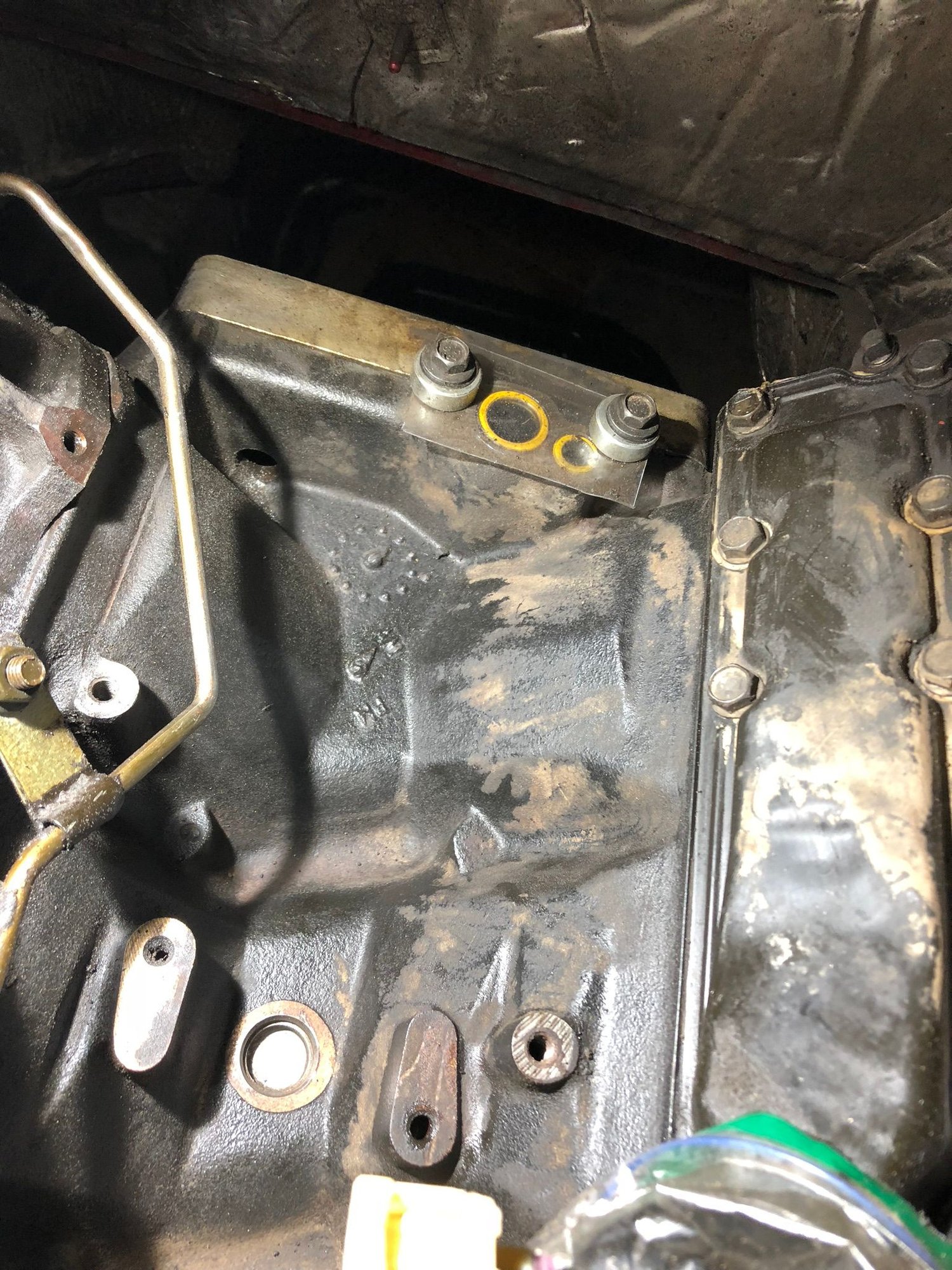

I basically upgraded, rebuilt or replaced everything I touched when I fixed my EBPV leak.

Here is the all clean shot. Can see the block casting date back there. Still dry as a bone. 1 year later

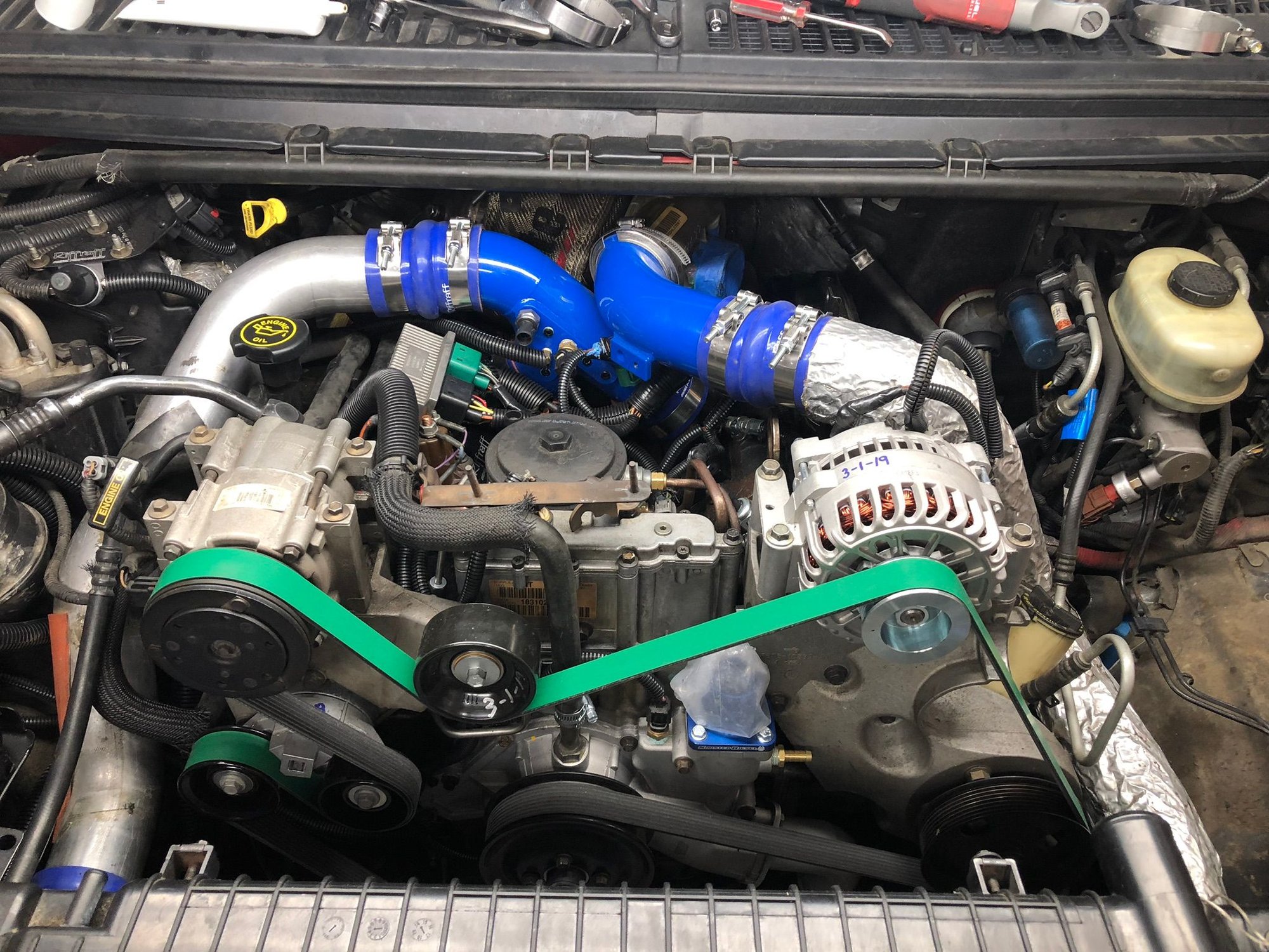

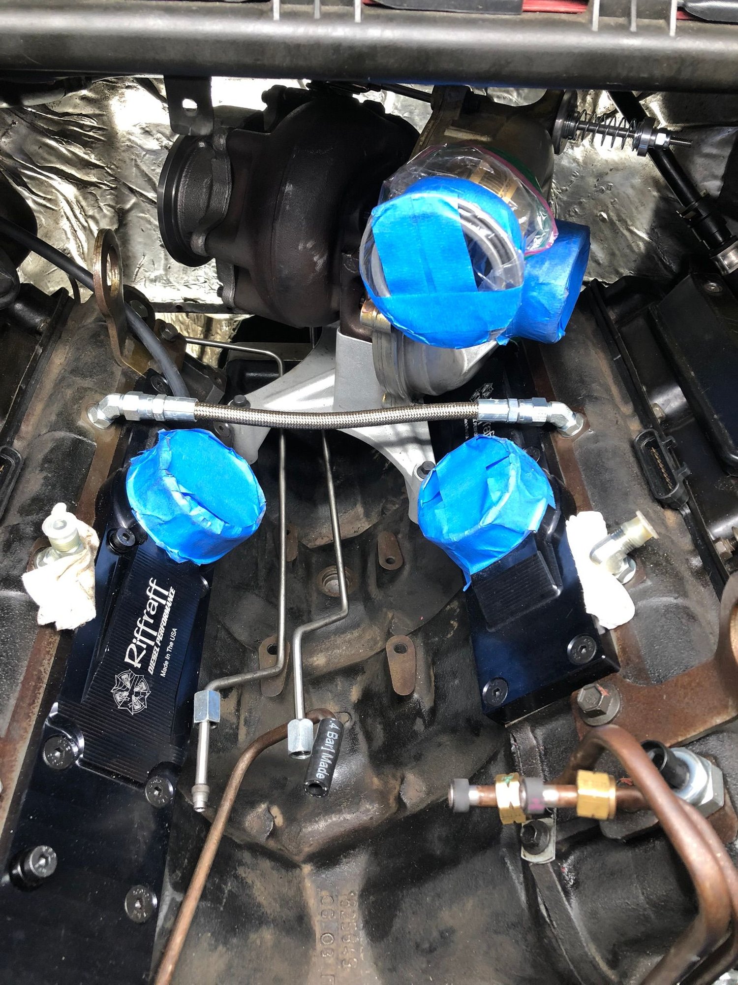

yeah look up in the first set of pics. I did glow plugs, new UVCH, $.50 cent mod, Riff Raff Valve covers. CNC Fab 4 way fuel and HPOP Lines. Tons of other stuff as well. My injectors seem to be fine and I jad to draw the line on cost effective mods at the time. Some day if they act up Ill replace them
