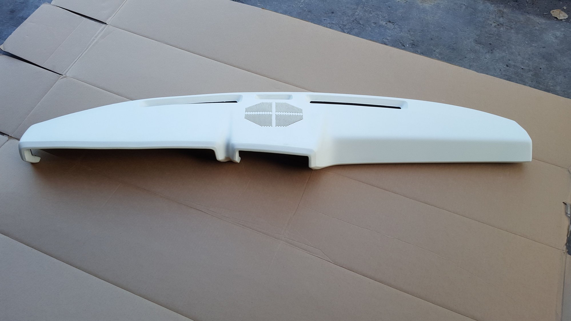

I installed one in a customers truck. You will have to remove the clips from your old dash pad as the reproduction ones do not come with them. But they fit perfect and look right.
This is the white one we got for the '82 I built with the 5.0 Coyote at work.

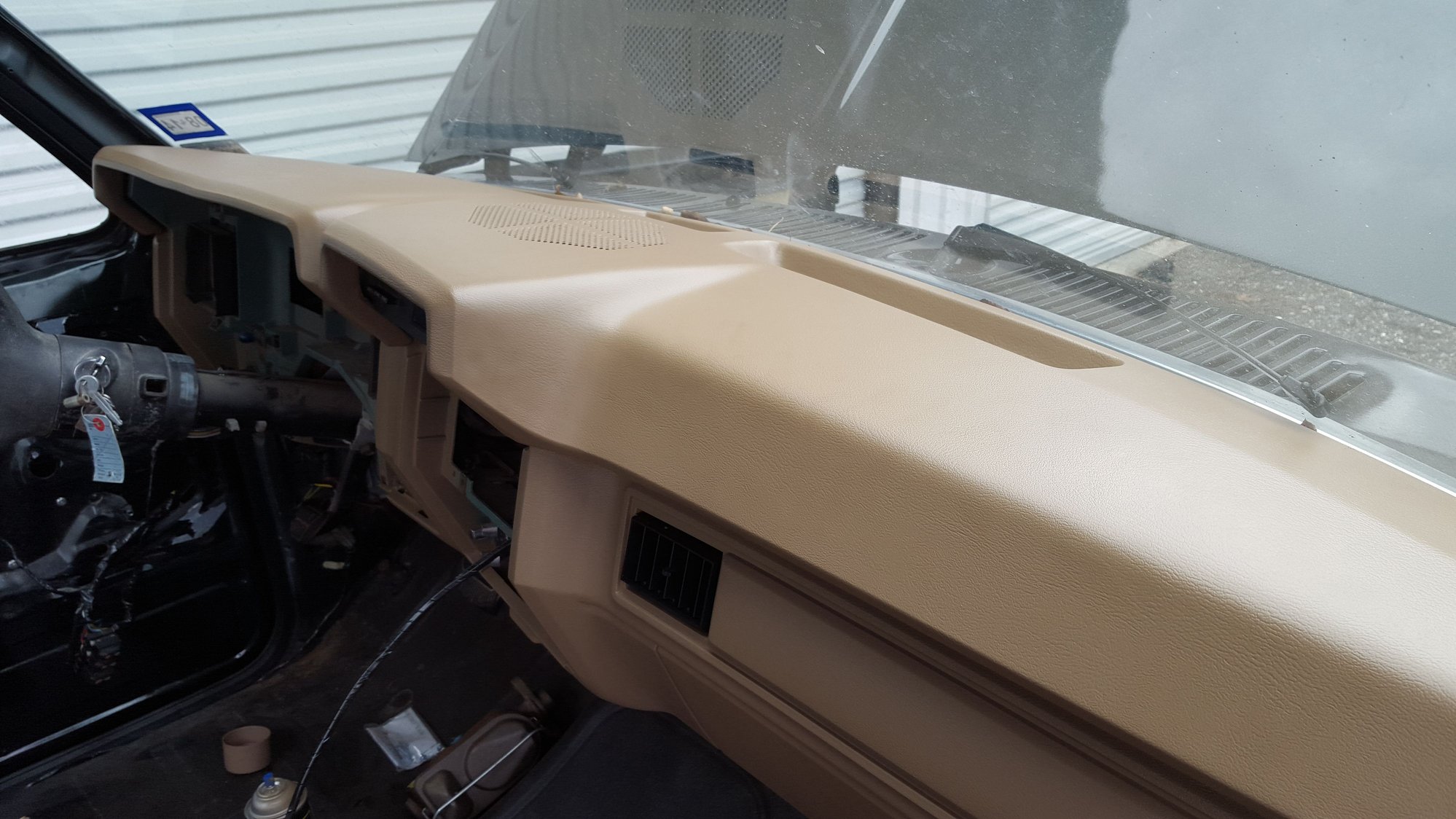

And this is after I sprayed it with the SEM adhesion promoter and the SEM buckskin upholstery paint/dye.
SEM is the same stuff I used on my black door panels I picked up from Dennis-Carpenter for my '82 and will be the same stuff I will use when I get my dashpad. I will be getting the black dash pad since my interior color is Midnight Blue.
Only thing is the reproduction pads do not have screw holes in the defroster vent region. I will be correcting this myself by using my old pad as a pattern to drill the dash pad out. The washer headed trim screws ford used will cover the hole up if I have to drill slightly larger to get the screws to line up.

Where did you get the white one?

LMC sells them unless they went to just black. Dennis Carpenter sells them also as well as NPD. I'd personally will pick mine up from Dennis Carpenter or NPD.
