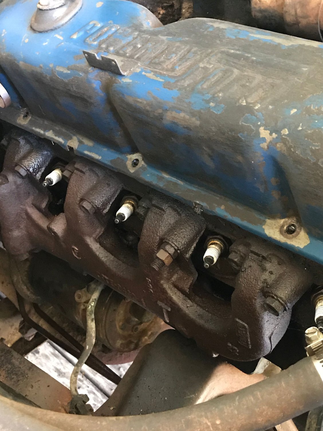

Here's a pic showing the fit with the exhaust manifold temporarily in place..maybe use the stud for something. .ground, etc..

On my ‘69 with a 302 the 2nd bolt from the front on the passenger side head has that extended lug.

Does anything bolt to it? Thanks for the reply.
not on my truck. Someone replaced the battery cables and attached to a different point on the block. I’m going to be out working on the truck so I’ll snap a pic a bit later.

I was incorrect it was the header bolt.

That's an exhaust manifold bolt, not the head bolt that ecumscumguy was showing. On my 87 Mustang, there was such a double studded bolt on the manifold, and it was used for holding a bracket on the dipstick tube, which went into the side of the block. If a cable was bolted to that, I'd worry about insulation being burned up by the heat from the exhaust.
On the double studded head bolt, I'd worry that whatever is bolted to it might loosen it up.
