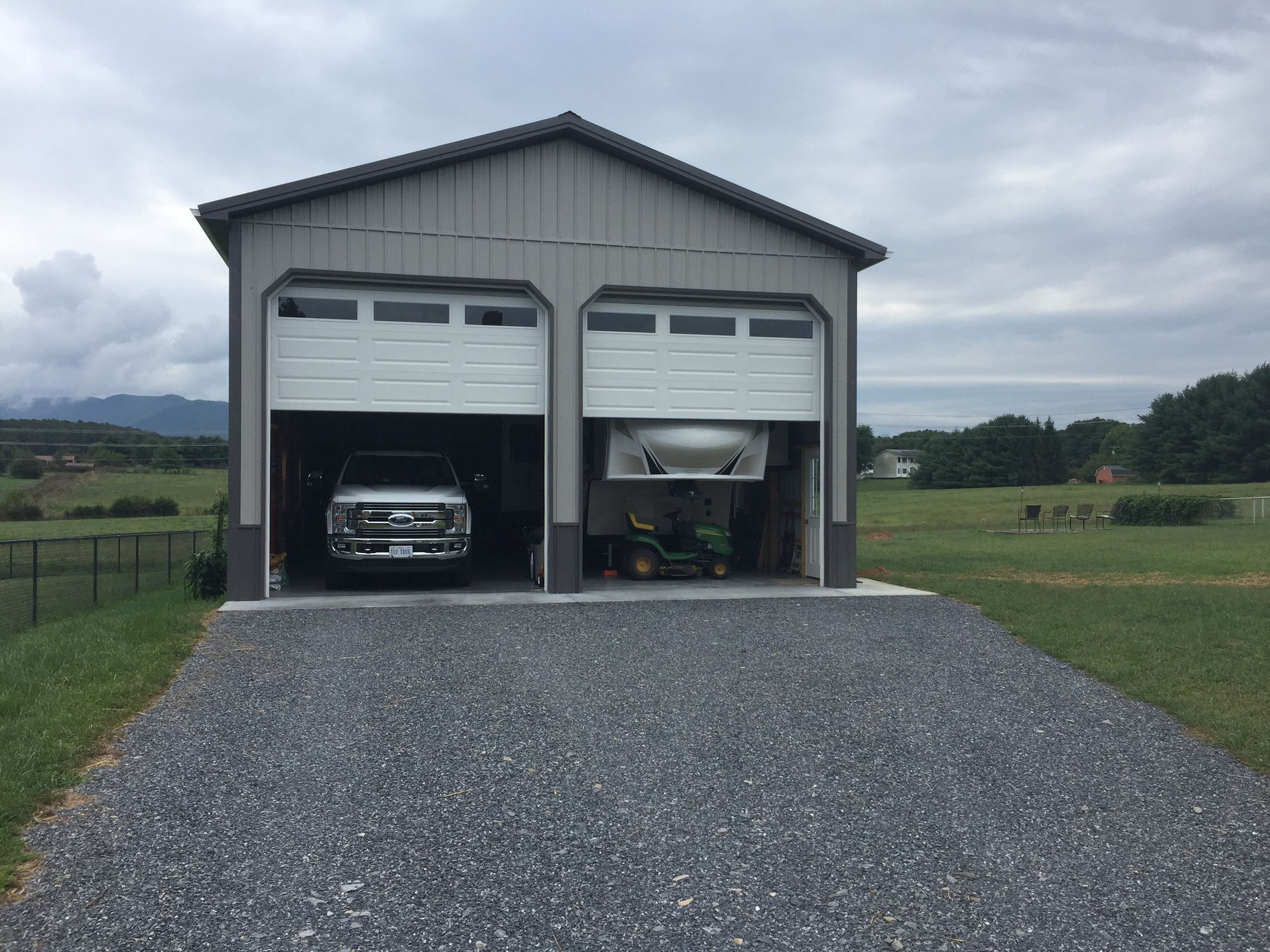

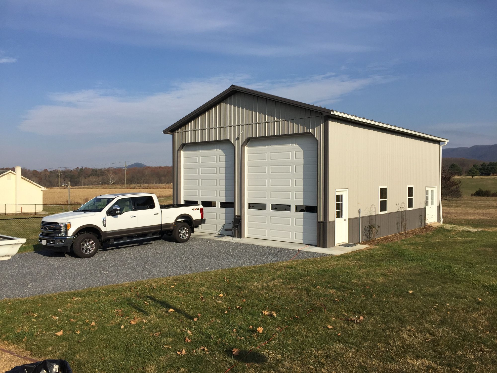

We went with a 44’x28’ double garage. I wanted to have a 48’x32’ building, but I needed to avoid a sewer line, plus I wanted to keep the building on the smaller size so it didn't overwhelm the neighborhood......it still looks big.
We have a 16’ ceiling with 12’x13’9” doors. The 12’ door width allows me a little wiggle room when backing in my 36’ 5th wheel, and the 13’9” height allows anything road legal at 13’6” in the door.

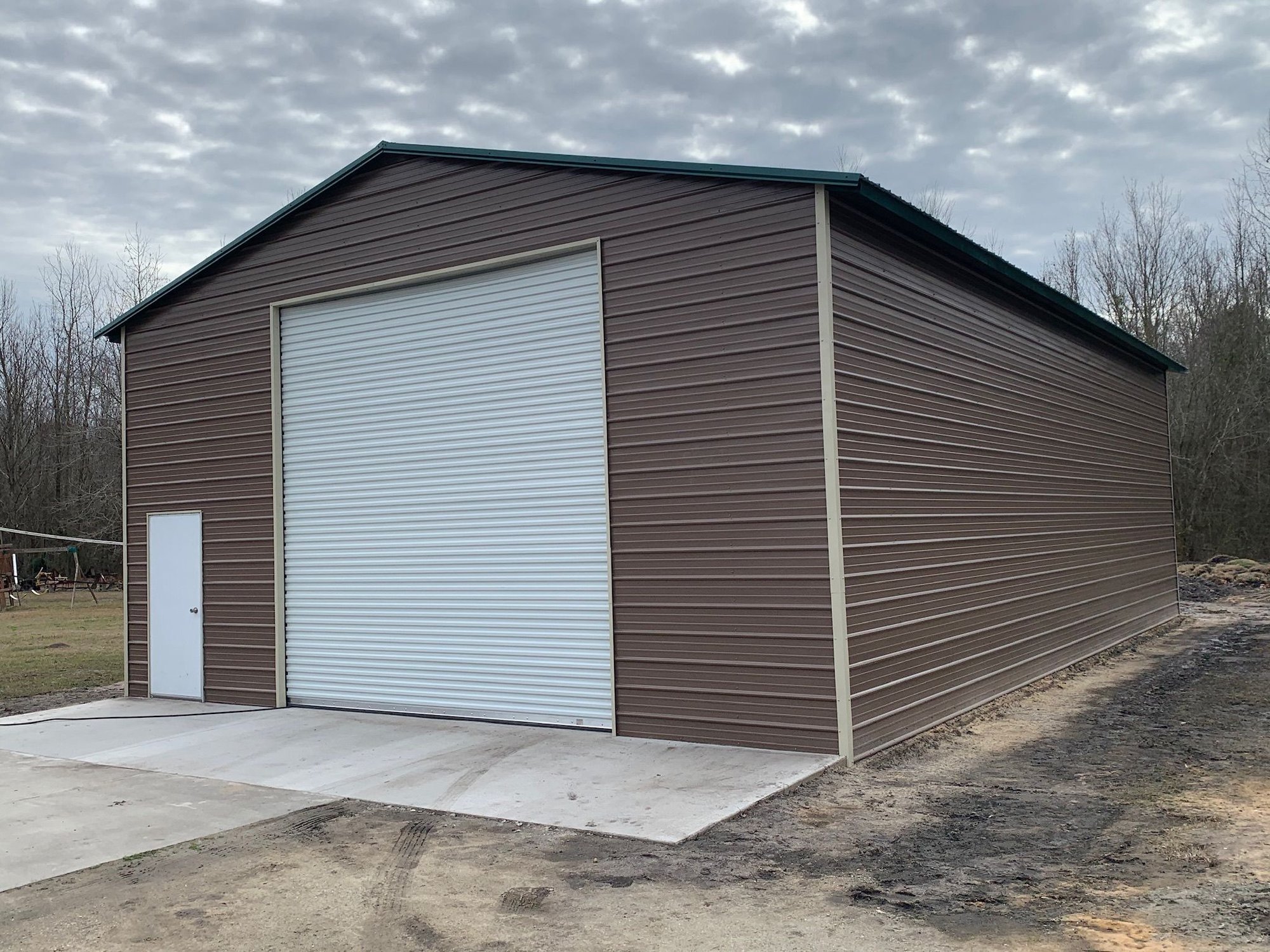

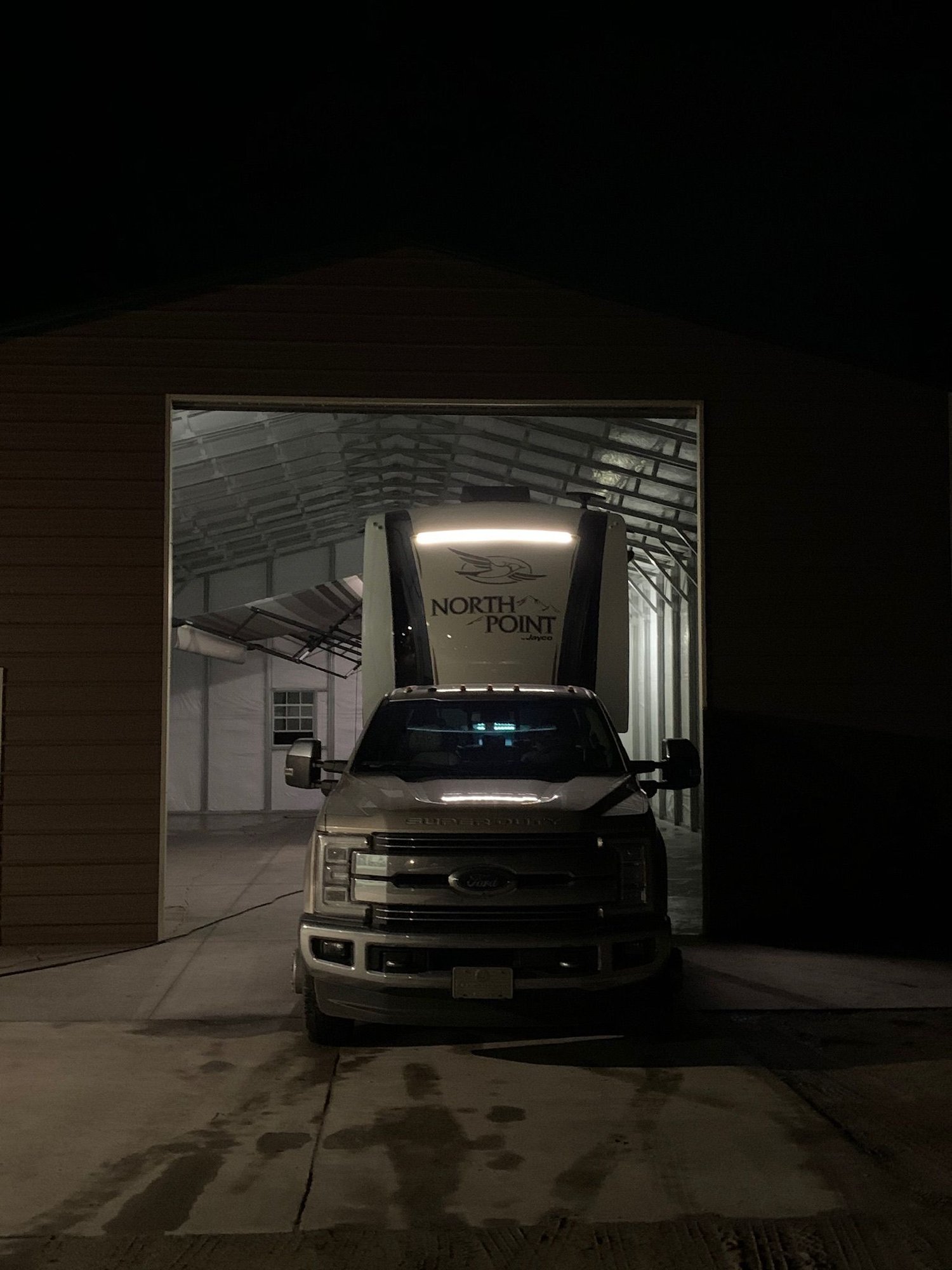

We had our structure built earlier this year. 30x50 with 14’x14’ rollup door. I start backing in straight and then angle back end toward driver side wall. With the rollup door up the opening is actually about 13’10”. The rollup door is not centered with the end of the building. It is about 7’ from the corner.
In the second picture I am backed straight in and not angled.

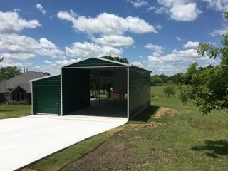

This is what I’ve been working on for my new 5thwheel I’ll pickup in a couple of weeks. Overall it’s 30’ x 50’. The RV part is 20’ x50’ the opening height is 14’ at the header. I have a 10’ x20 ‘ storage and the rest is patio area . I’ve added a 50 amp hookup and sewer isn’t too far away when needed. I still need some convenient plugs and lights but that will happen after I get the 5thwheel.
Wow thats a great setup! Looks amazing! If I can ask what did that run? Not the land obv, but the building, concrete, and electric?
The building was 17,000 and the concrete work was 27,000 which included dirt work 30x50 slab and close to 90’ of driveway thats 30 ‘ at the building and 20’ wide to the street. The electrical I haven’t totaled everything up but I probably have about 1500 in it so far . I’ve done all electrical work my self . The aluminum steps were 750 and I have about 600 in the pipe railings . It would have been cheaper if I had a level lot , not as much concrete.
