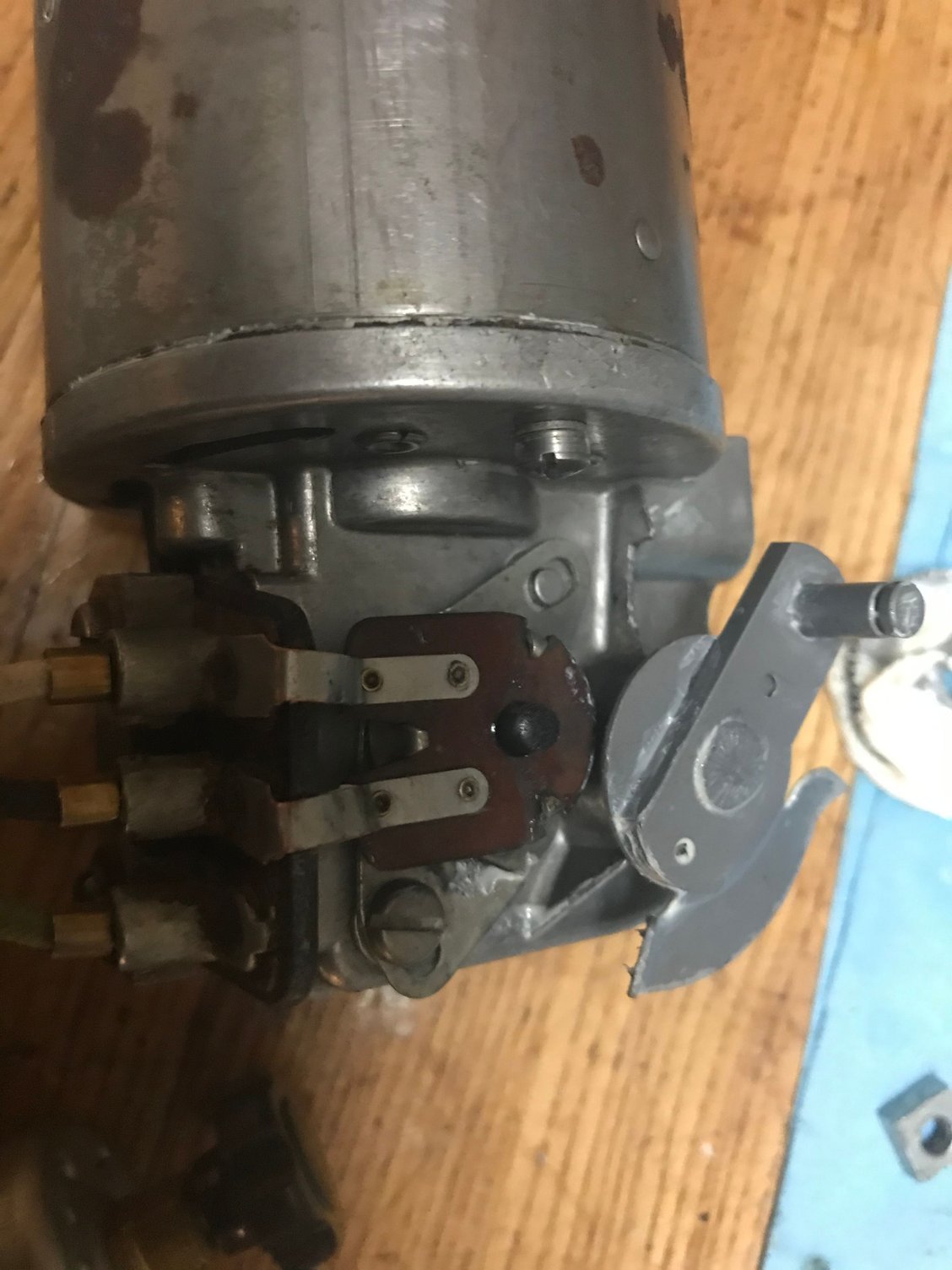

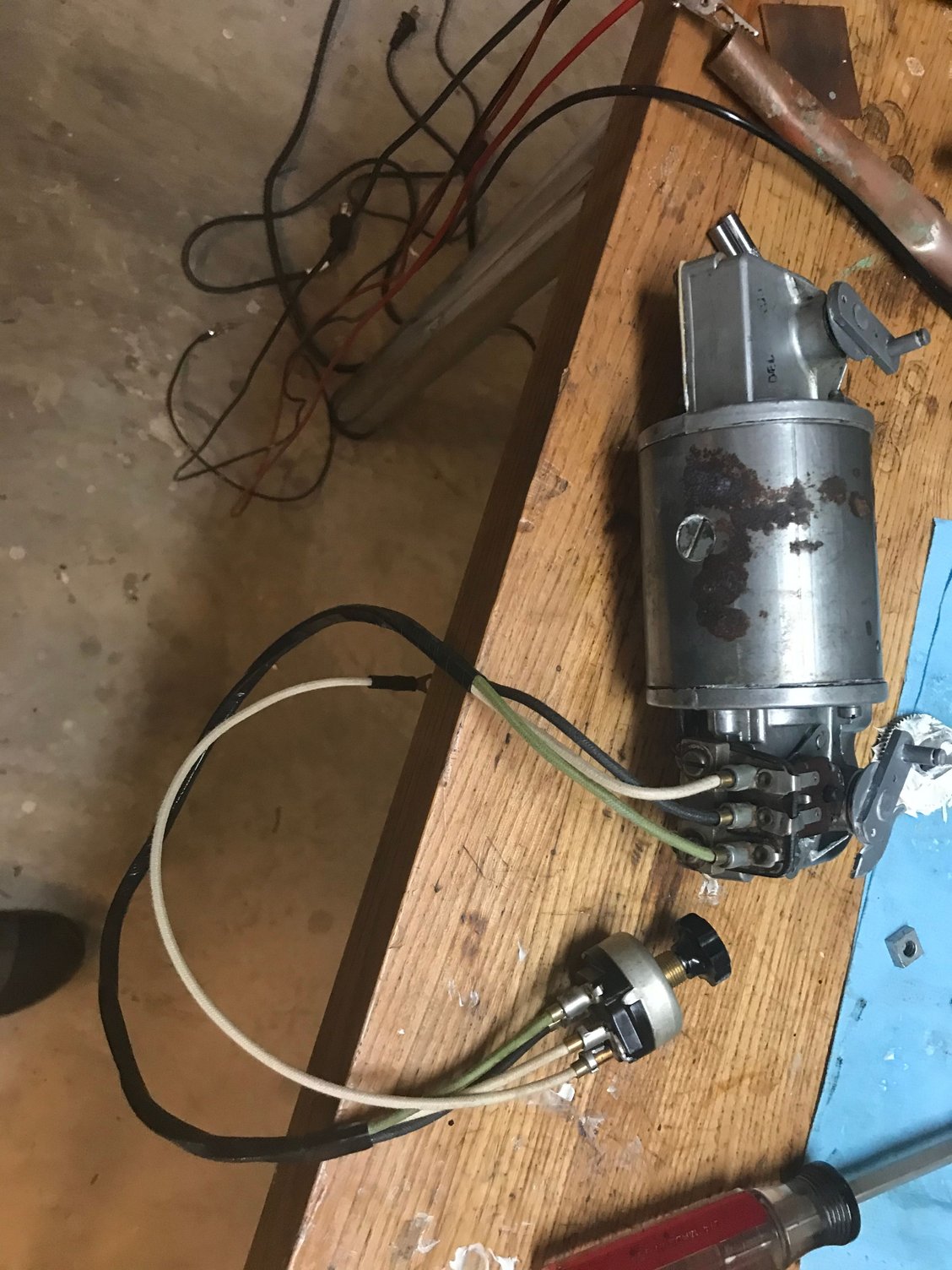

Guys been looking at the electric wiper on the floor so decided to tear into it and see if it worked. I have it cleaned and working but it doesn’t appear to be working as it should. Both sides spin but the pivot with the little button switch doesn’t do anything, it just spins in one direction until power is removed or the switch is turned off? It seems like when the rider goes over the button something should happen or that is where it should stop?

It has been a while since I've gone through my electric wiper setup, but that switch is involved in parking the wipers. If my recollection is right, the black button overrides the wiper control switch and powers the motor until depressed, stopping the motor parking the wipers. It does not change direction of the motor if that is what you were expecting.
Be sure to open up the gearboxes and check that you have good fresh grease and not hardened gunk. Also check that the plastic gears have not degraded or are cracked.

One i had would only Park about half the time. Some tweaking of the ramp that pushes on the button fixed it. You can remove the switch portion, but before you do, check to see if pushing the button breaks the circuit between the two leads.

Thanks Ross. I played with it on the bench, seems real finicky, works 50% of the time etc. Gonna pass on the electric setup and stay with vacuum. Will put it aside for later/rainy days.

The original gaskets had a hole in them, guessing for excess grease to squeeze out. I didn’t add that hole to my gasket paper so guessing I compressed grease into the motor fouling the armature and brushes when I tightened down the gear housing covers. Quirky thing and time to move on to other projects.
