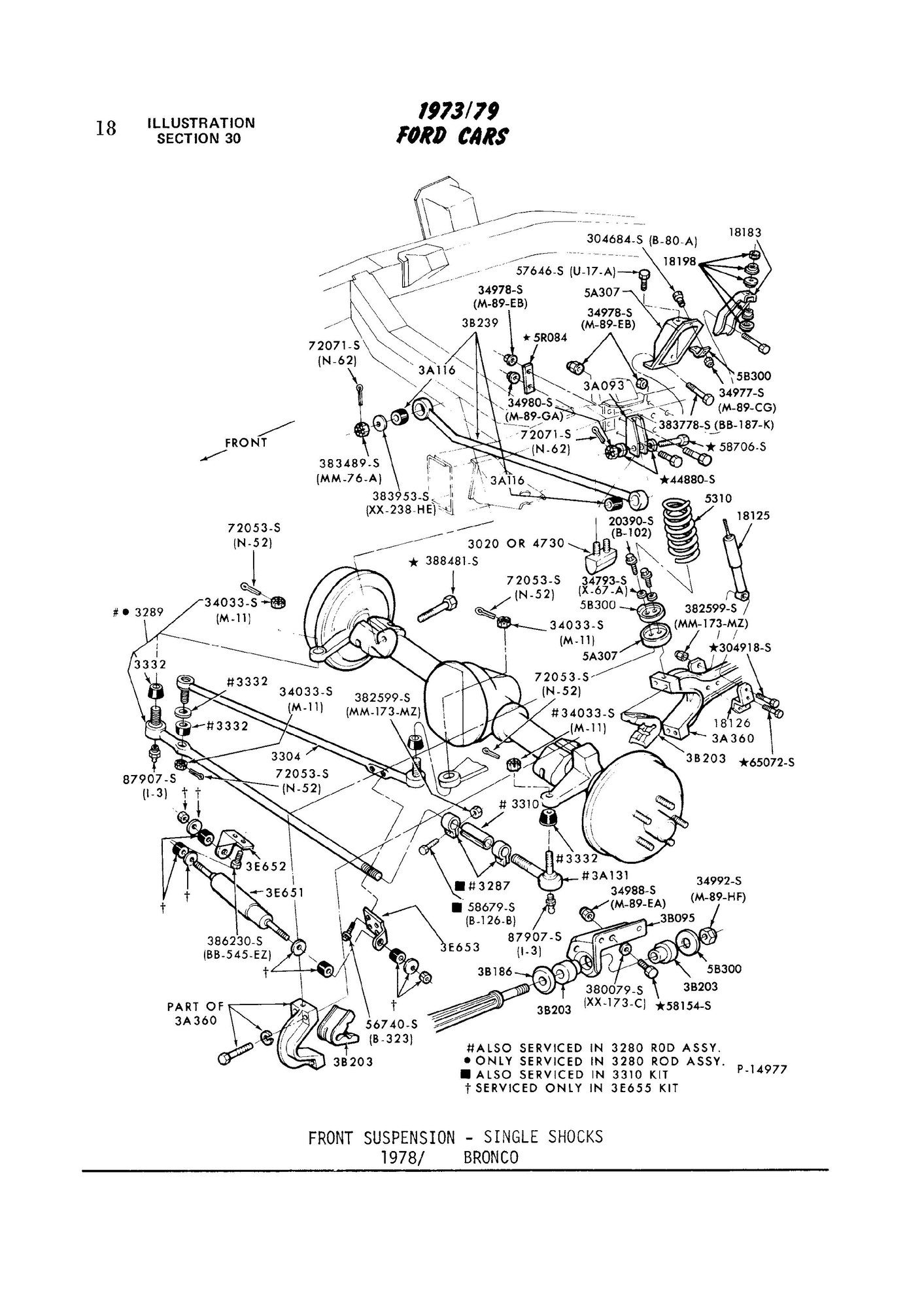

And when you get a new trac bar, prior to installation, insp the mount holes at each connection point (frame and axle). Alot of times the frame connection point (bolt hole) will get worn out/oblonged. And even a new trac bar and rubber bushing put in there will not fix that. #3B239 is the trac bar and the upper connection point # 3A093 is what I am refering to. Yea that is a 78 Bronco diagram, but same as a 4wd F150.
Thank you, I've been looking for something like this to help me eliminate as I go.
