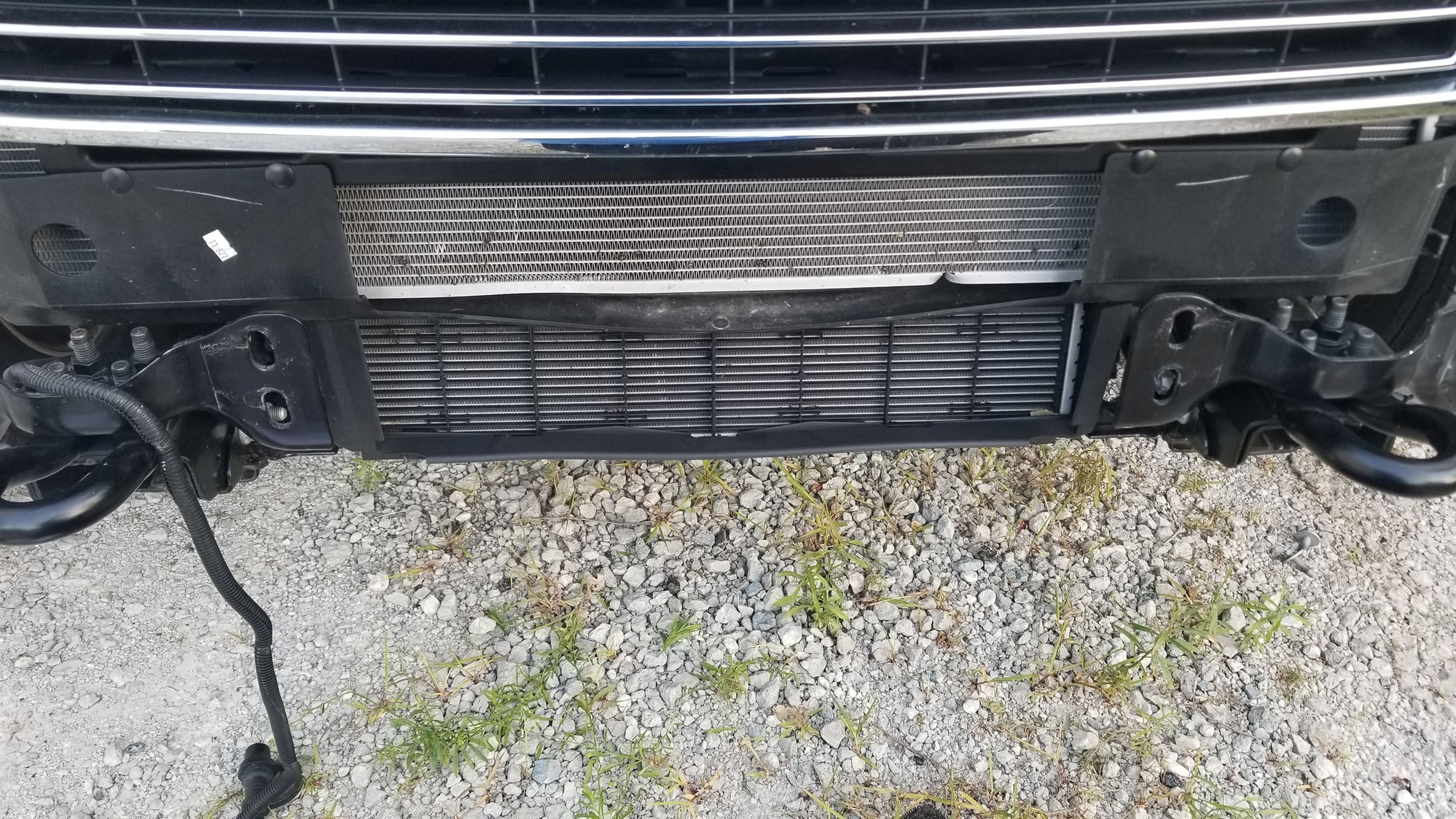

Just an FYI, I attempted to install an ECO-HITCH on my 2020 F-450 yesterday. Yea, that's a no-go. Looks like ford made a change to the heat exchanger. I have an air-liquid small radiator where everyone has a liquid-liquid transmission cooler.
The mounting points are being used by the updated F-450 cooler and will not allow any space for a hitch. This may include any hitch because I loosened the mounting bracket to see if the curt model would work and that puts a ton of stress on the plastic end caps of the smaller radiator. I'll post pics.
I emailed the manufacturer, and I'm not entirely sure if it affects all 2020's or just a 2020 F-450 issue.

As promised I'm reporting back.
I am getting a refund for the torklift hitch. They noticed their error and I'm getting a refund. It seems like this is DRW only. So DRW F-350's and F-450 pickups are affected by this. All other trucks are not affected for the 2020 model year except for tremor (winch) package.
Also reaching out to curt and draw-tite they're aware of the issue as well.
I'll have to fabri-cobble a custom one for my truck for now.

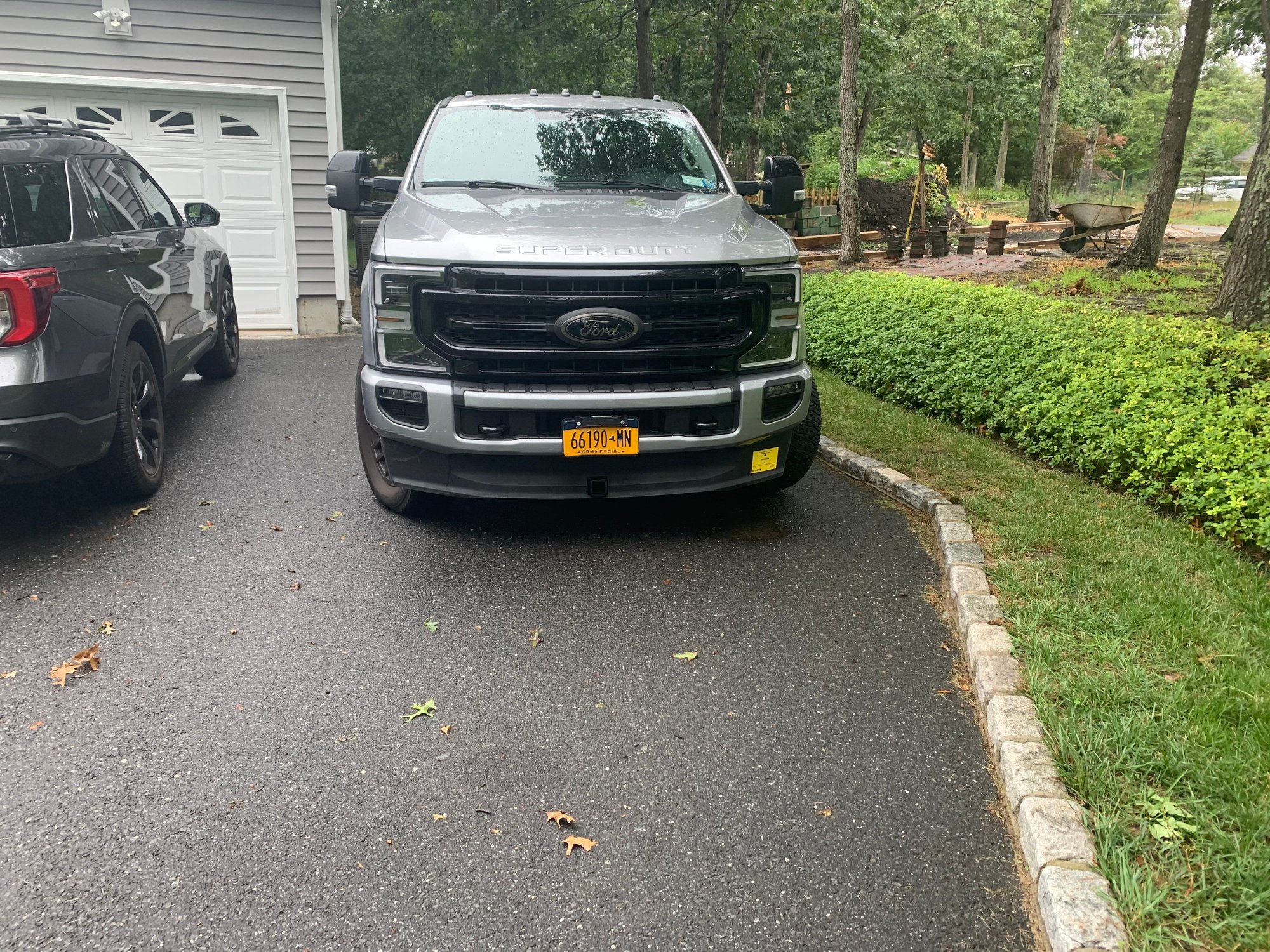

Curt install
Here are photos of my installed curt front hitch. I am very happy with it.
