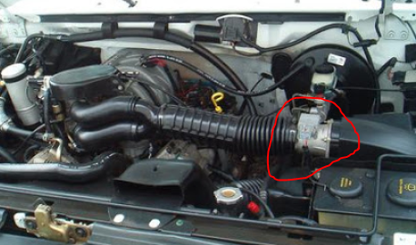

So I checked for the map sensor it's not on the firewall I can't find it? And the guy removed the air filter box so I'm not sure what's going on

Does the truck run?
No air box, probably not MAF.
If its SD, then there will be a Manifold Absolute Pressure(MAP) sensor. MAP is located to the right of the heater box, on firewall.
Take some pictures of under your hood, and attach them.

is this your turbo truck, if it is it will be hard to tell if PO cant answer, if switched to Mass Air or not, even if MAP sensor is still on firewall
Speed Density has MAP on firewall
Mass Air sensor is connected to Air Intake Filter Box
Good catch, in the other post, doesn't look like there is a MAP or MAF in the pictures.
I say, pull the ECU, see what electronics is running this thing.

I found the map sensor and plugged it into the vacuum tree, runs much better
