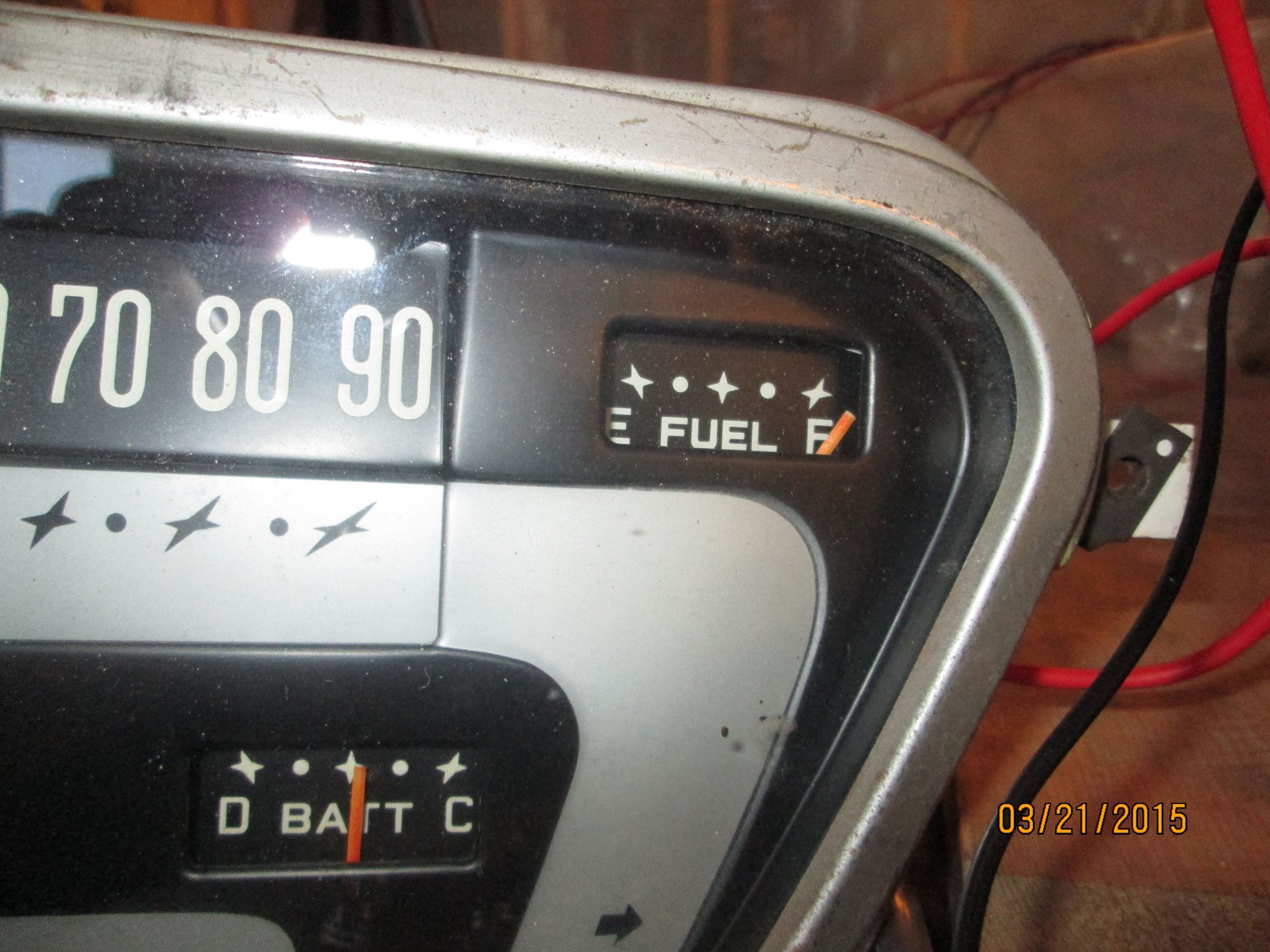

I have a gas gauge in my 1955 ford f100 that reads full. No matter what the gauge pegs full.i have taken the stock sender out of the tank and wired it to my ez wire 21 circuit harness. I tried to manually manipulate the float but nothing works. Is there something I’m doing wrong? I tried to see if there was some kind of bad connection. Any ideas?

It is a possibility that your gauge is making a ground contact before it gets to the sender, thus acting like you are getting a ground thru the sender. If this is the case, the ground would be coming after it goes thu the gauge. I am going to try and post my pictures of how I tested mine. To eliminate any EZ harness mix ups, try hooking it up with out goint tohru the harness. Just try to see if the gauge is working and the sender is working first

I had hooked up my fuel gauge to a full 12 volts before putting it into gauge panel. it worked it went to full. I placed extended wires from my harness to the sender unit. I moved the float arm various ways with the reading always full. Also I had a 1/8 tank reading on my gauge before all this and now it just goes to full. Im thinking sending unit.
