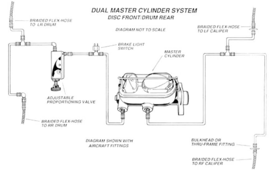

Does not show the proportioning valve, but shows the disc/drum setup...

As I understand it on the drum or disk brake front end, the small (front) resevoir on the master cylinder goes to the rear. The larger (rear) reservoir goes to the front brakes.

Correct Large reservoir is for the front discs. The dual piston caliper requires significantly more volume than the small wheel cylinders for drum brakes. If there was no fluid in the reservoir, you have a leak in the front plumbing or calipers. Storage is horrible on brake systems. Not sure how long it was in storage and how long before that the brake system was serviced but if you are planning on driving it, you should consider a full brake system rebuild.
