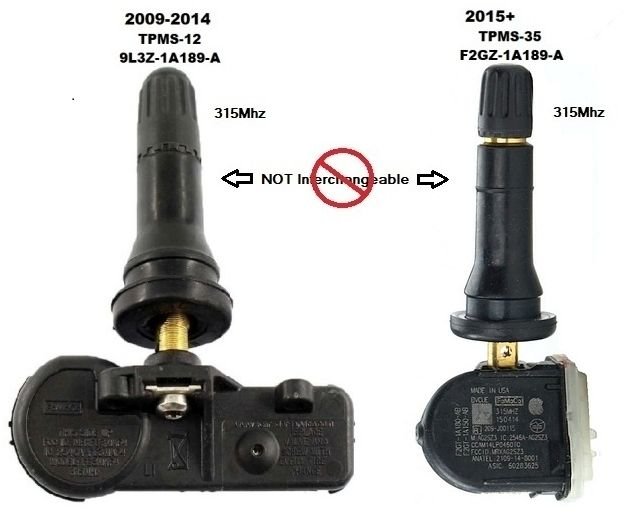

The TPMS sensors will also need to be replaced ...
Also ... Because of the change in the gen'13 (2015+) F-130 rims' mounting surface and stud hole, the lug nuts will protrude slightly more. NBD, it's a cosmetic issue.
Example ...
Additional reference information ...
Example ...

carolinaborn82 ... I can drive without the new TPMS, right?
Sure. They'll trip the but will cause no harm or issues.
I'm gonna get them replaced, just not right now.
Would recommend getting Motorcraft sensors rather than any aftermarket - quality and less activation, reset hassles.
NOTE: Consider buying -new- from reputable ebaY® sellers (high satifactory ratings) - much less $$$.
Over the past ten years I've purchased 5 sets from various sellers and had no issues.
