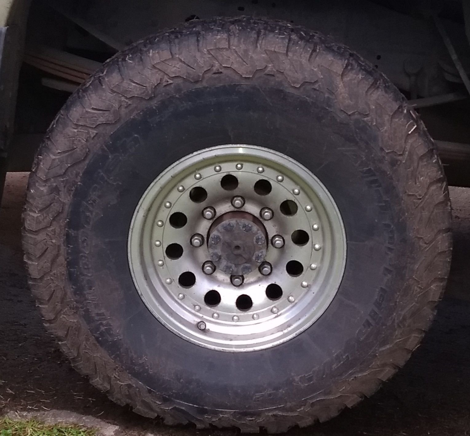

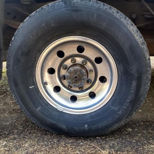

Working on a new to me truck that will eventually have a slide in. I have a couple sets of rims and tires. My question is what set will provide more stability if any or should I focus on load capabilities? Tire tread on both are at the end of usefulness so regardless of what set I use I'll have to buy new rubber.
One set is LT 265//75R16 E rated 3415 lbs @ 80psi
The others are
LT 315/75R16 E rated 3860 lbs @ 65 psi

Tire comparison chart says, 315's are 3" taller and 2"wider than 265's

I was running 295-75-16 on my last truck. LI 129 rated at 3950#. Very beefy.

Thats about what I get doing a quick compare height wise, so the 315's would raise everything about 1.5 inches, probably 2 with new tread.

I've been driving on the 265s since a few days after I got the truck. Ive got about 1000 lbs on board on a regular basis so I'm going to switch to the 315's and see if I feel any substantial difference. Not quite the same as any camper Id be interested in but if its noticeable then Id be leery going with them.

2,400 pounds will normally mean 3,200 to 3,400 ready to go adding the normal 800 - 1,000 that is typical and going with the larger tire, I think is large enough so you will feel it in acceleration and where you are in the torque curve while driving.
Figure normal rear axle weight unloaded, add the weight of the camper and added pounds, You can figure almost all the total is on the rear axle. Then decide if you need that much tire. When I size things, I always go big enough, but not big for the sake of being big.

You might also want to check the wheels’ load specs. My recollection is Ford’s 16” SD wheels were load rated for 3415 lbs., but I can’t find a spec online.
The specs may be located inside the wheel.
Also note that physically larger tires effectively reduce the truck’s axle ratio.

Yeah, the axle ratio was my thought too. With those big tires you can calculate the reduction, but I bet it is enough to feel the lag in acceleration and more downshifting in the hills.

I was just looking at all the CAT slips for my truck and noted the stock tire size that comes on the truck exceeds the rear axle rating for the truck by 250 pounds. I'm not sure there is much value in having tires that exceed the axle rating. I can't say it is that way for all Ford trucks, but I bet it is.
