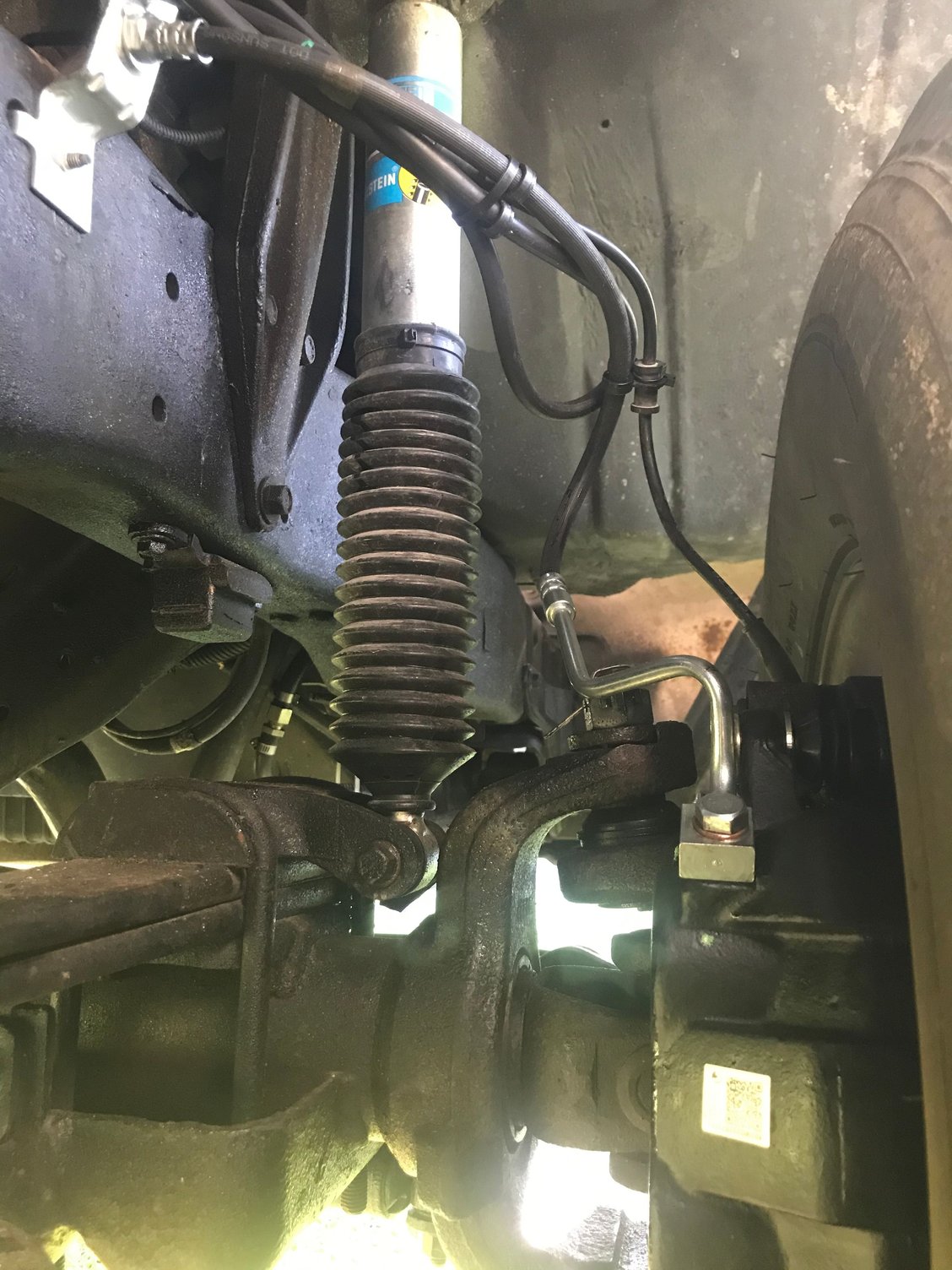

A buddy of mine helped me with the truck last night. He actually had a extra set of lines on hand so that’s what we went with. SS ones sure look nice but these were here and he wouldn’t be again for weeks , so beggars can’t be choosers... just glad to get up and running. Had to put a whole new set of calipers on the front end after work today. Definitely should not have done anything today. Hand is killing me. Will be paying for it.
not best picture because forgot to take before getting tire back on.

looks good! I'm more interested in your hand. What happened!?!?
