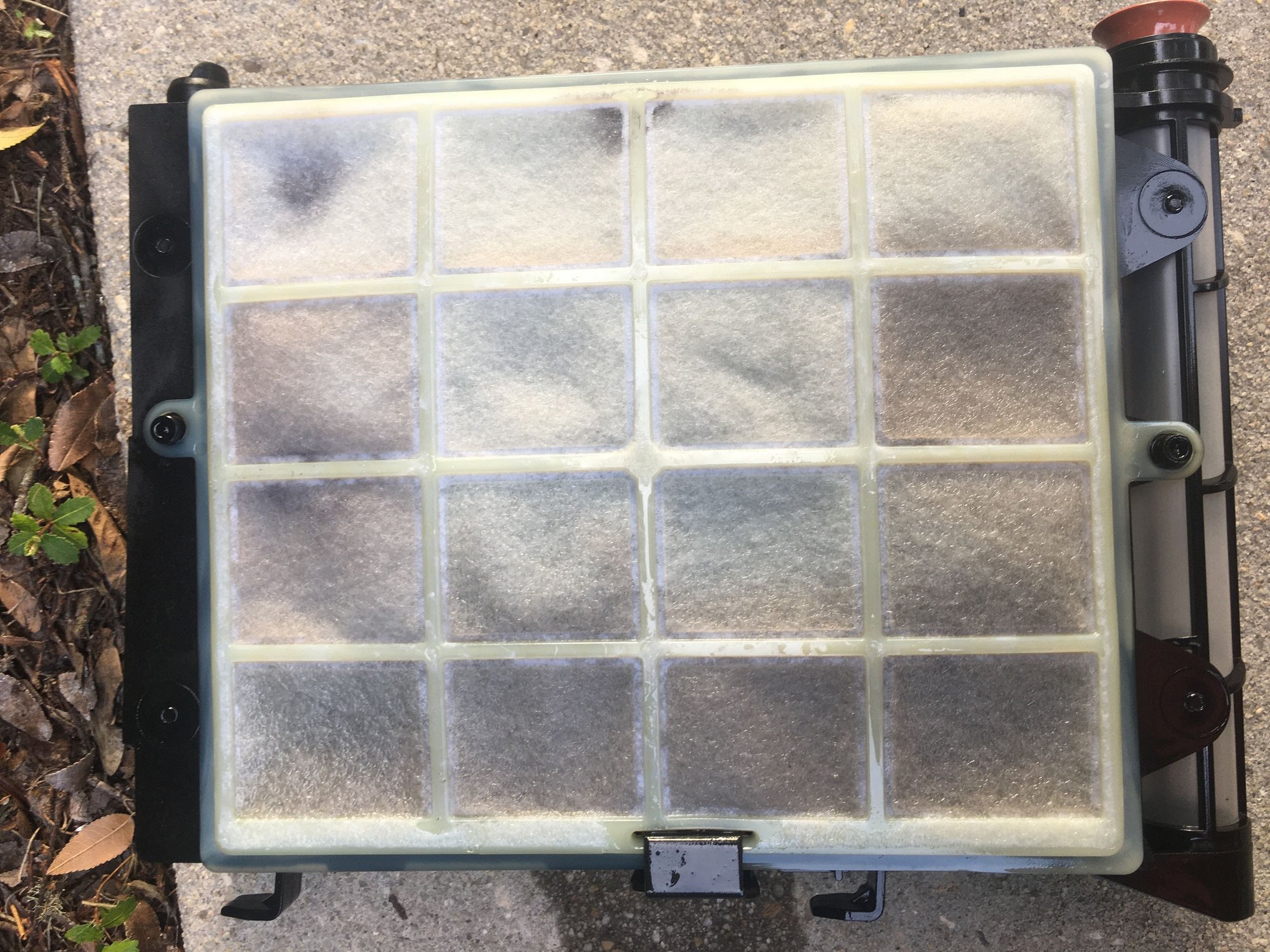

Did my first fuel filter swap today. Took about 30 min due to being nervous as heck! I did purge the filters 6 times before cranking the truck up. So far I see no leaks 🧐
some fue did spill when removing the canister from the engine bay.
truck has 21k miles. Is this considered dirty?

Mine don’t look that dirty when I change them at 600 engine hour intervals but I have seen photos of them way more dirty. I think those are about the average level of dirty.

Changed mines at 32k miles and I had trouble differencing the old and the new one. I almost put back the old one haha

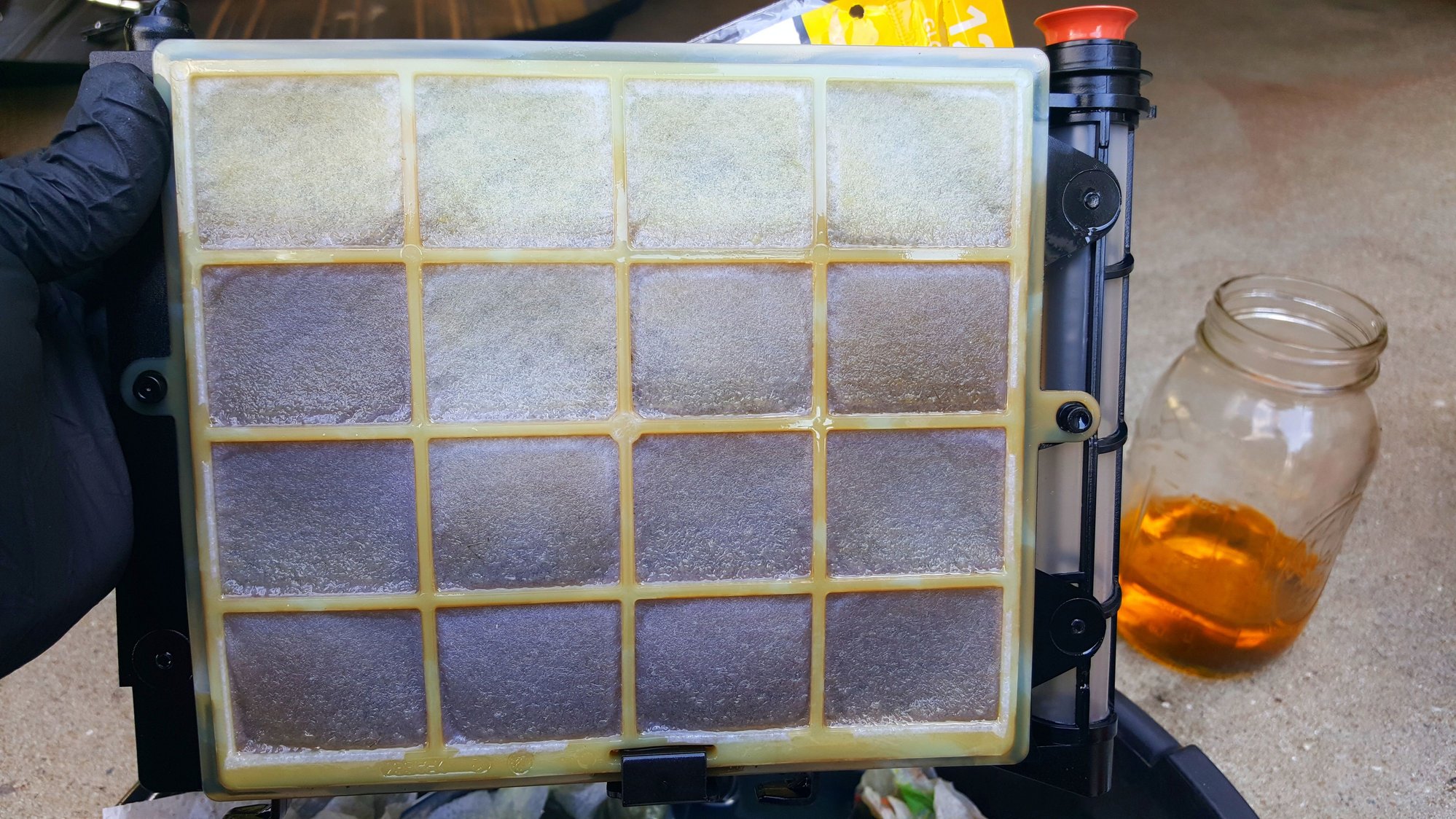

They look fairly normal to me. When I changed my filter last, mine were about the same.
This is a photo of the first time I changed mine at 43500 miles (bought it at 34500 miles so I don't know how many miles were on it). I also broke open the engine mounted filter and it was dark, but I don't know how the filter media looks when new.

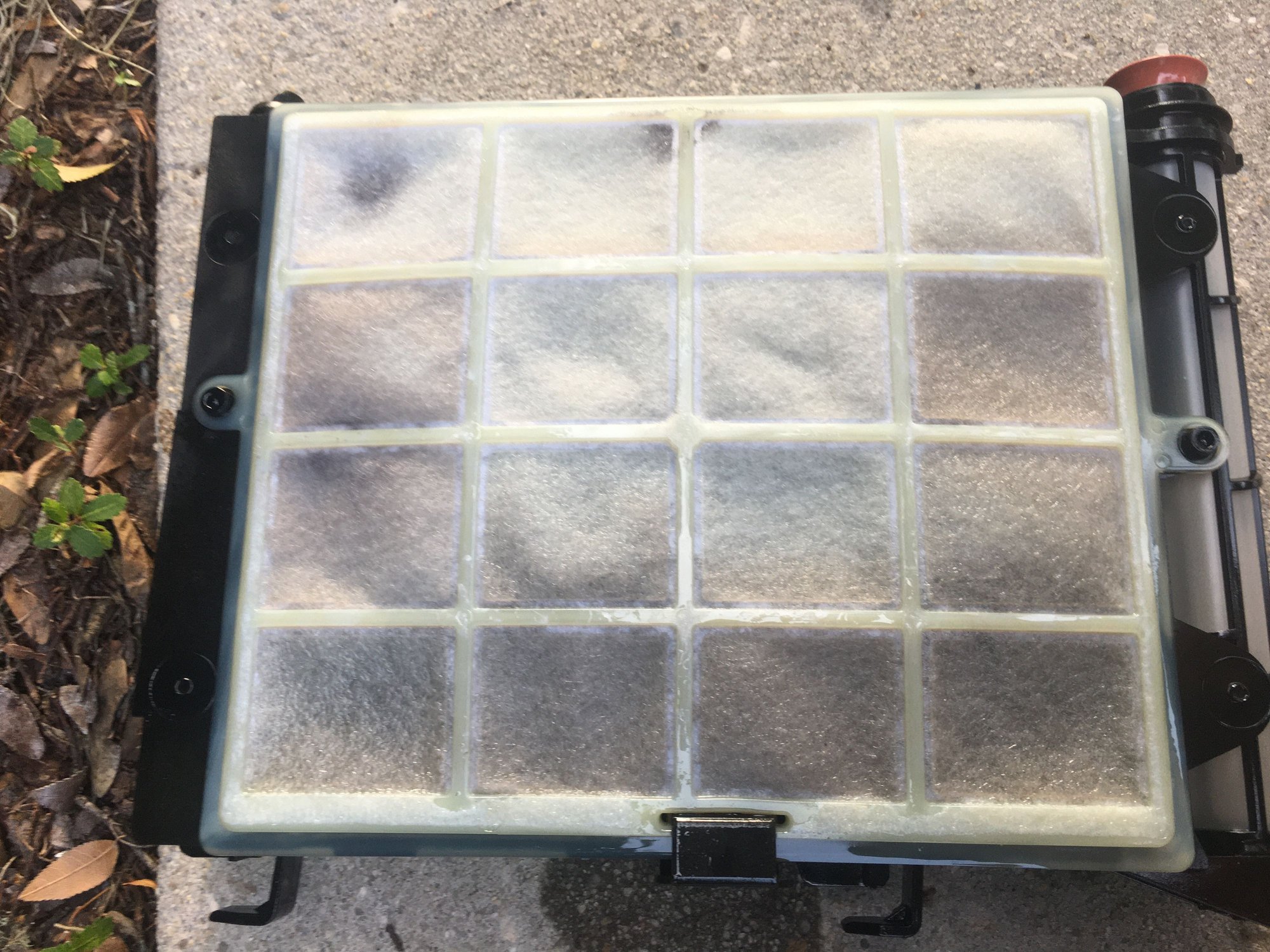

This was my fuel filter @ 15k miles. Almost saved it for a backup....

Keep buying fuel wherever you have been since it looks clean!

Right? If I laid it flat it looked perfectly white. I'm almost considering buying a larger fuel tank just to ensure I can always get fuel where I prefer to get it and not get stuck buying fuel because I need it... Seeing how clean that filter is from buying fuel mostly at my local station, makes me a little warm and fuzzy.
