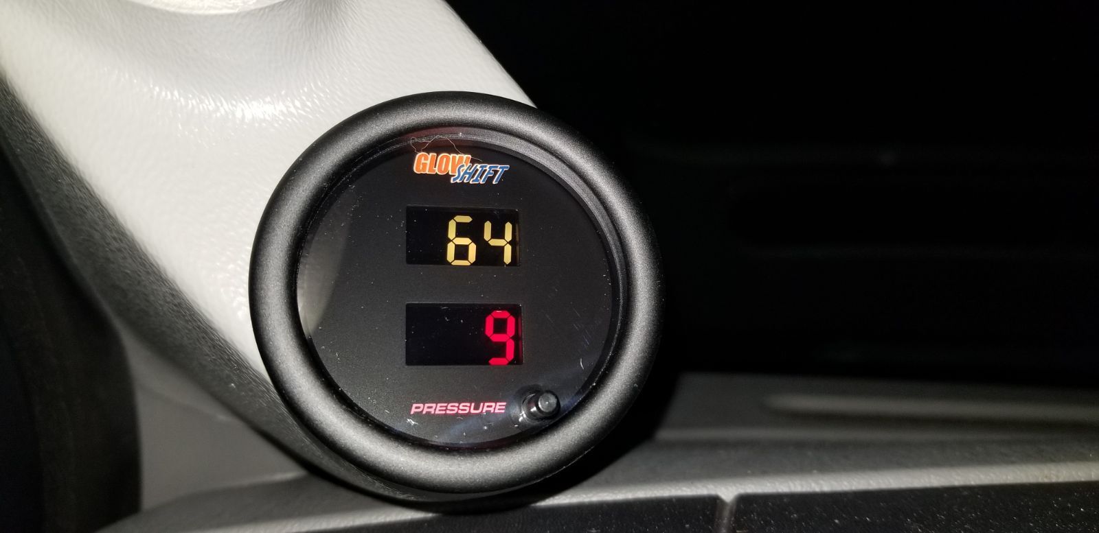

In addition to what you plan on running already, I run coolant pressure gauge too. Actually I cheated and run BOTH fuel (wheat color for fuel) & coolant (red color for Rotella coolant) in one gauge so really you could monitor everything that you want to. I'm never concerned about low pressure oil because if there is no low pressure oil it will not run anyways since the LPOP feeds the HPOP.
