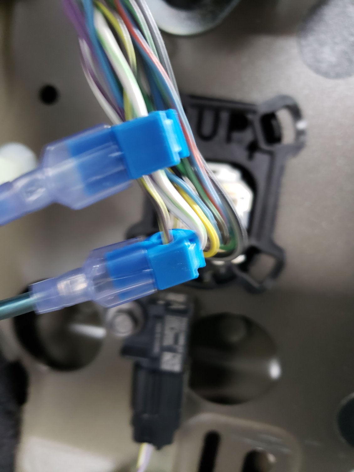

I have a 2019 f250. Bought a kicker VSS sub woofer. Everything is done except I can not find the brown & brown white wire I am supposed to tap into. Pulled tape back on wire harness like the directions say on driver side panel. Anyone have any idea where I can find them? I have a non Sony. Just sync with base system

i found mine behind the rear panels behind the doors.

You should find them in the pillar between the front and rear door, both sides. unwrap the tape of the wires going to the rear door. the two wires you seek will be spiral wrapped around each other. both sides

were yours white and brown white? I found the wires spiral together but they’re not those colors. Mine is a 2019

your left side will be brown/yellow - green/white +. Right side brown/blue - Brown/White positive

Those things are the devil, an auto wire stripper in the middle of a wire pulls the insulation back where you can perfectly weave a wire around the strands and then seal it back up.
