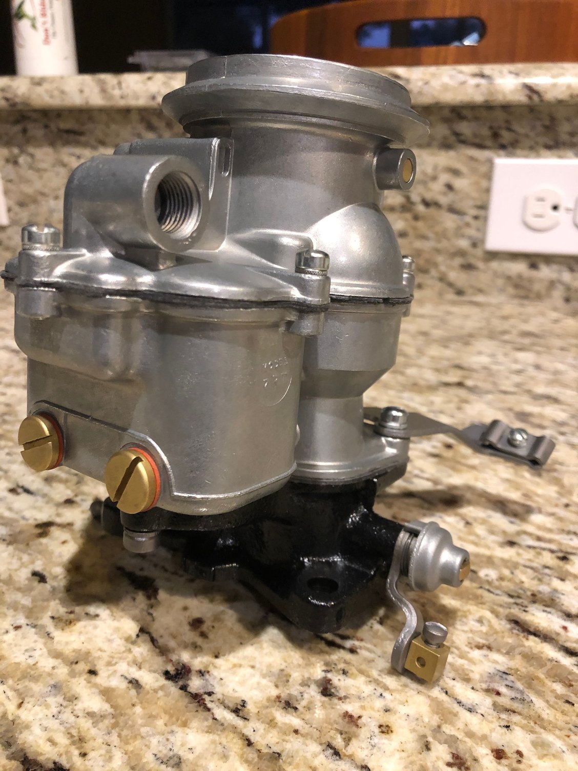

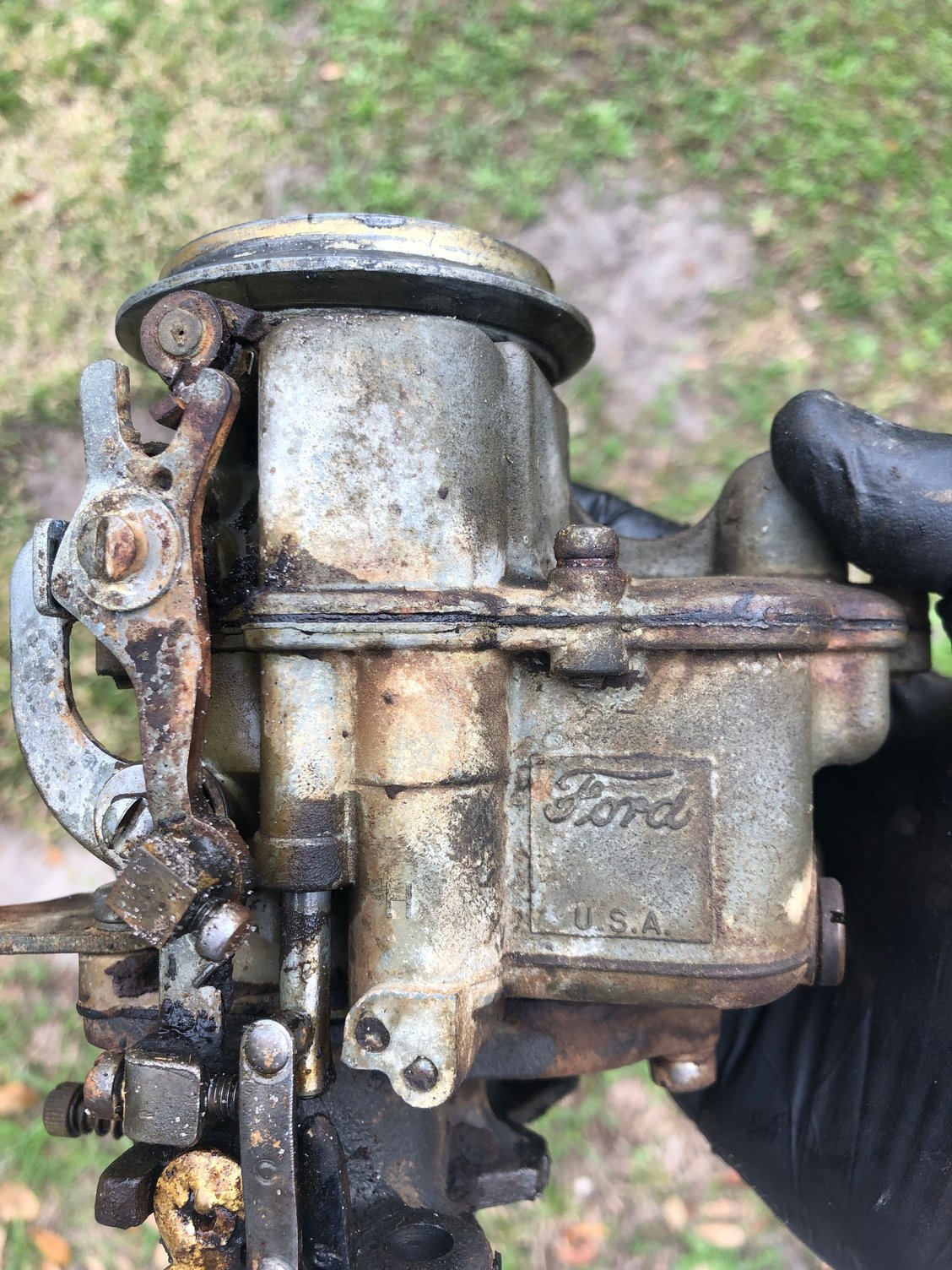

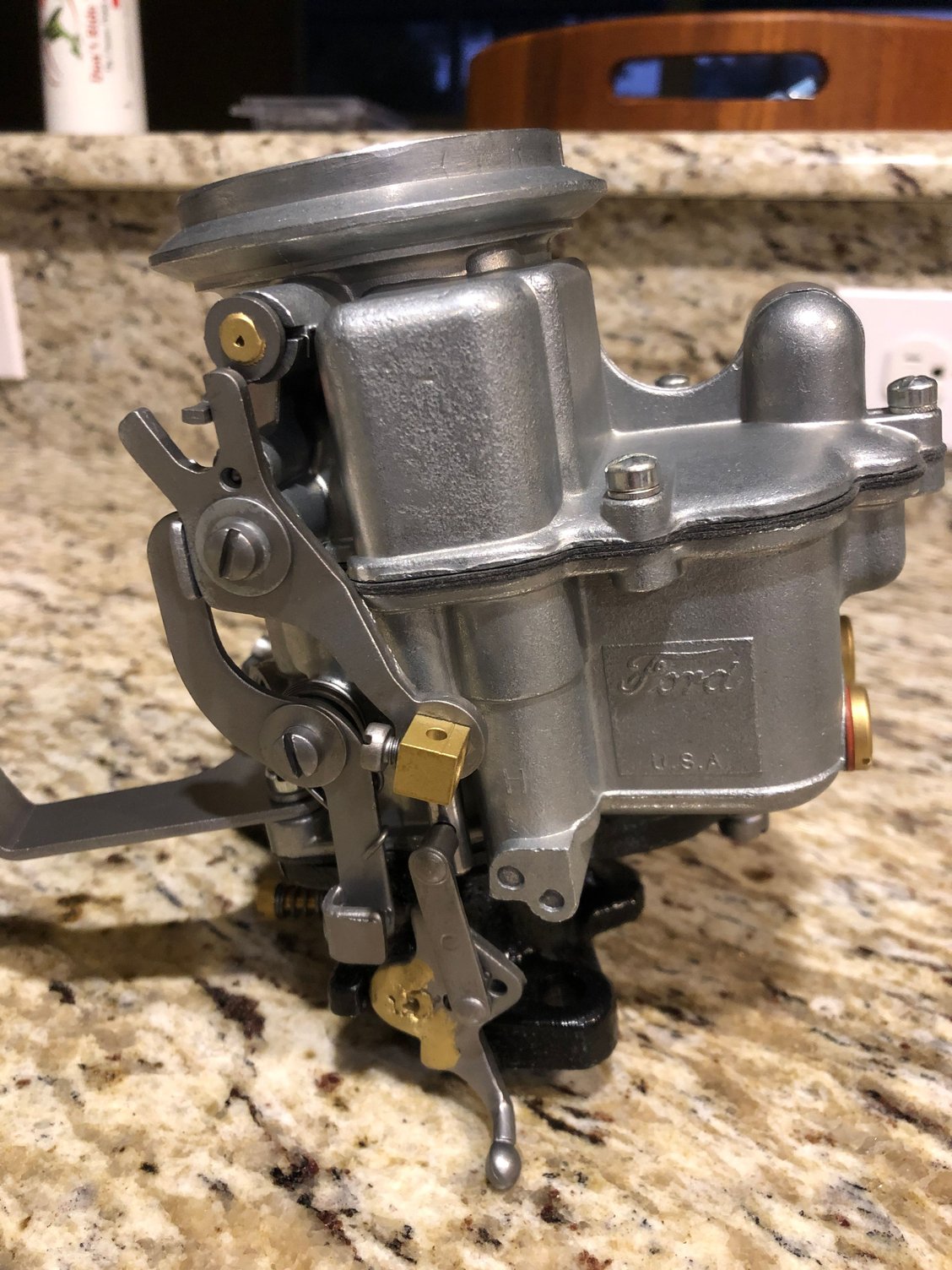

Check with Daytona parts Co. They are strictly a carburetor rebuilding and parts company. Had them rebuild my Holly 94 a few months ago, and it turned out great. They may have the parts your looking for in stock, without having to send them the carb. But if you want to have rebuilt, send yours in. Daytona Parts Home is their web site.
Before pic
After
Looks new!!!

52 4x4 - They actually bought that to my attention when I picked up the carb from them. He said in his years of doing thousands of rebuilds, they have simply learned that having the thicker gasket by using two, enable a better seal and future tightening should that ever be done by the carb / vehicle owner down the road. The rebuild estimate was $250, and the same when I picked it up. They even went thru the importance of having the proper fuel pressure if I went with an electric fuel pump. kinda nice both dropping off the old and when picking up the rebuilt, how the two I dealt with (Original owner and his son) were in absolutely no hurry to quickly get me back out the door. Any and all questions were more than just answered, they would actually grab mine or other carbs to demonstrate what they were talking about.
