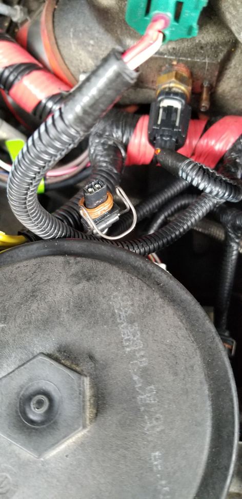

Hello everyone,
I had my 2001 excursion go down a few weeks ago. The dealership wanted 2400 to get her back and running. They were only going to repair / replace a few items. I decided since she has 285K miles I'd give her a refresh. A new engine harness was top of my list, where a lot of my problems have been.
I got the new harness installed and have one leftover pigtail. Its the same connector as the IPR. Any idea where this may connect?
Thanks much

VGT solenoid on turbo

7.3l's do not have a VGT. That is for the exhaust back pressure solenoid mounted on turbo pedestal.

He didn’t specify 7.3 but I should have known by the 2001 part...sorry

Not a big deal. I work on these trucks daily so it's easy to tell by the picture it's a 7.3l. Definitely they same connector for a 6.0l vgt solenoid.
