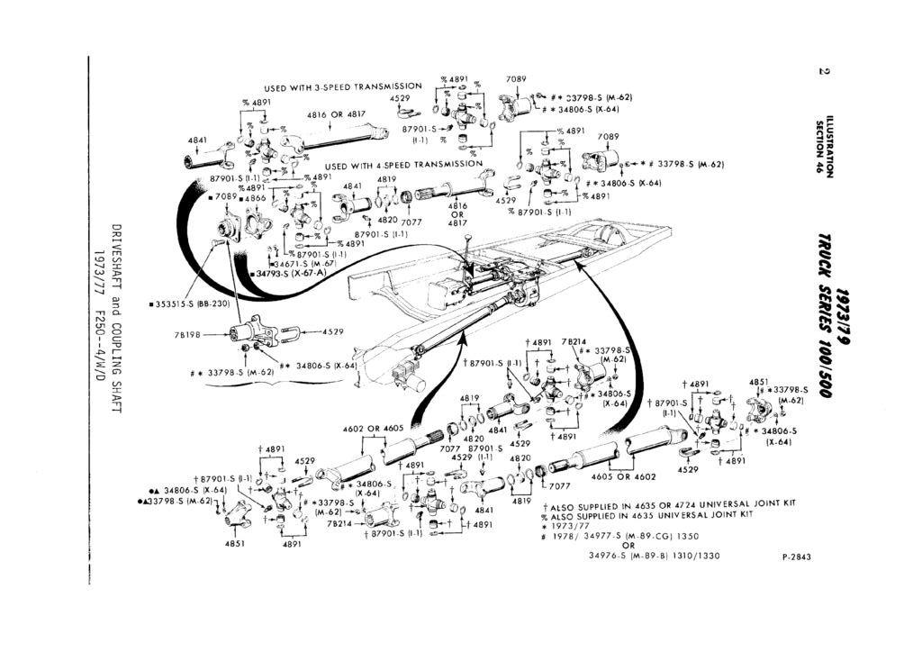

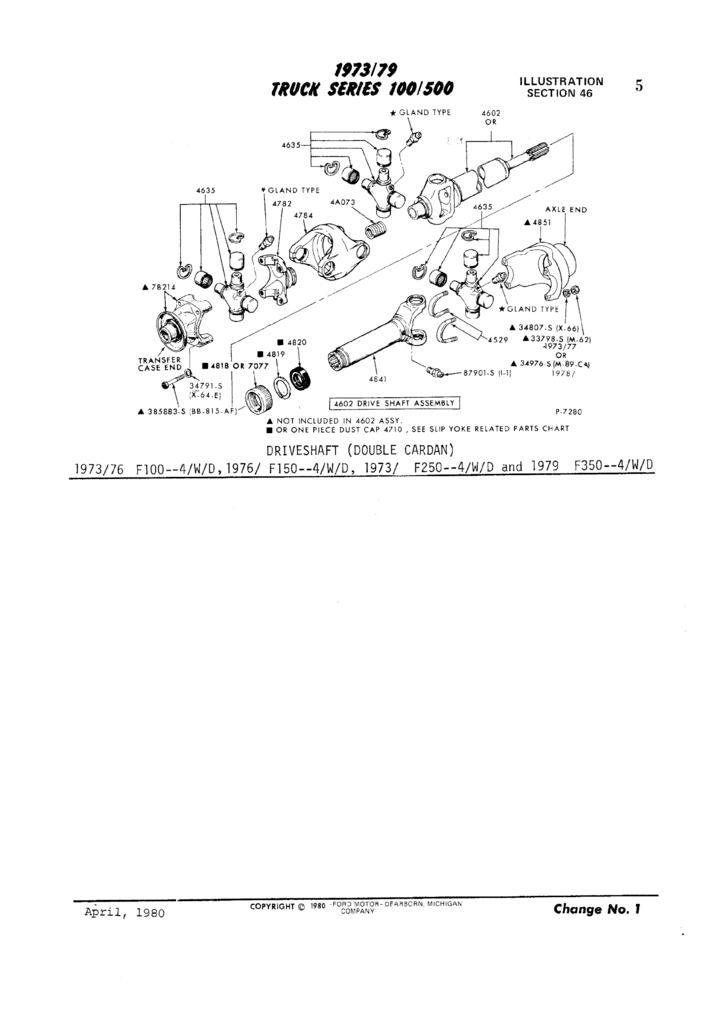

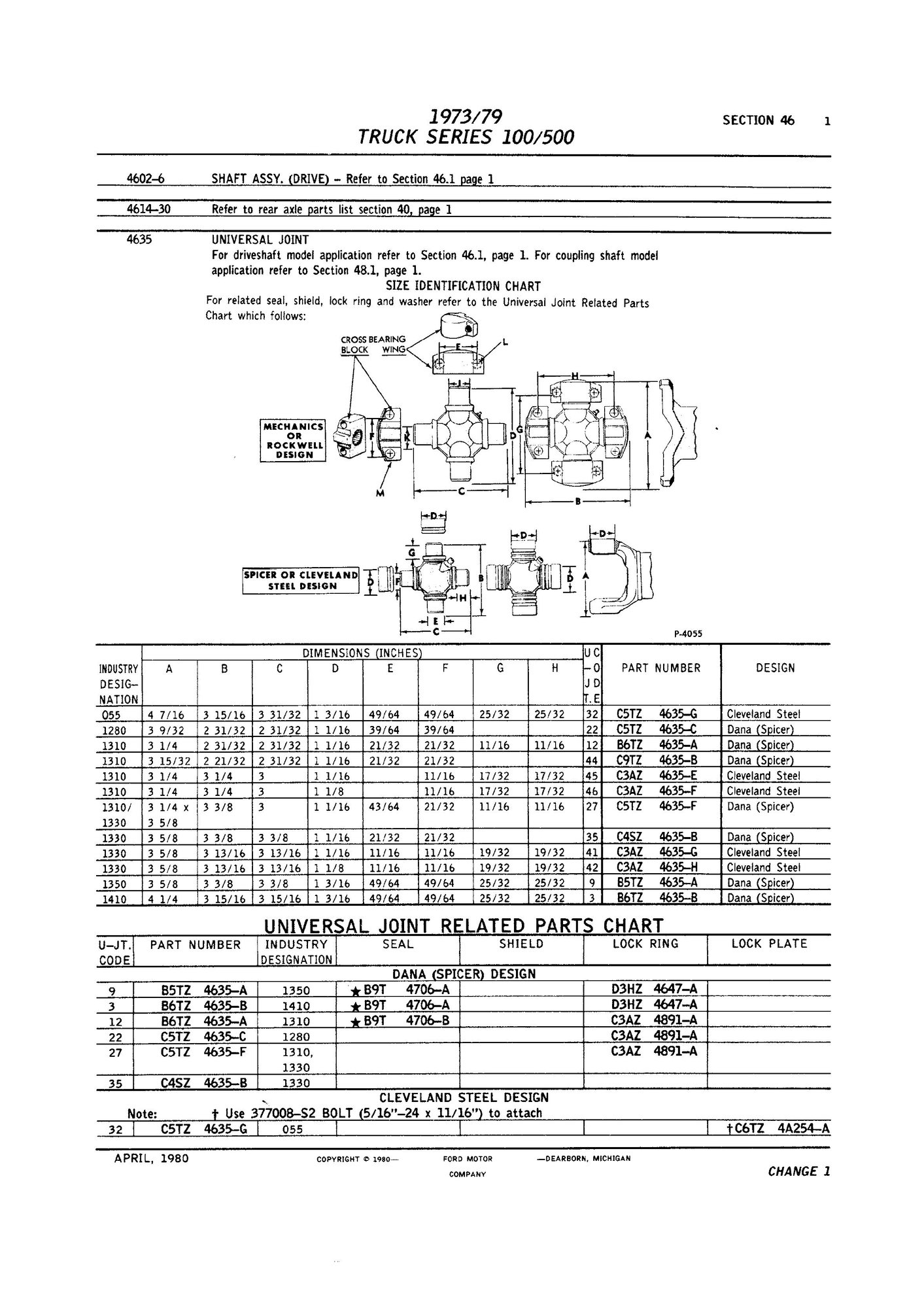

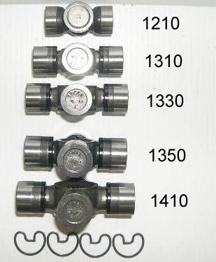

I have a 76 F250 4x4 with a 460, C6 trans, and divorced NP205 t-case. I have searched high and low for all of the correct U-Joints to use. It seems that they are all different and nobody has been able to give the correct answer. I am positive it has been asked here before, but I have had no luck finding the info. Any help, part numbers, pictures, ect. would be greatly appreciated. Thank you in advance!

Here you go. Cheap u joints are not always the best get Spicer joints if you can.
In
In case it is a married set up. But I bet divorced.
