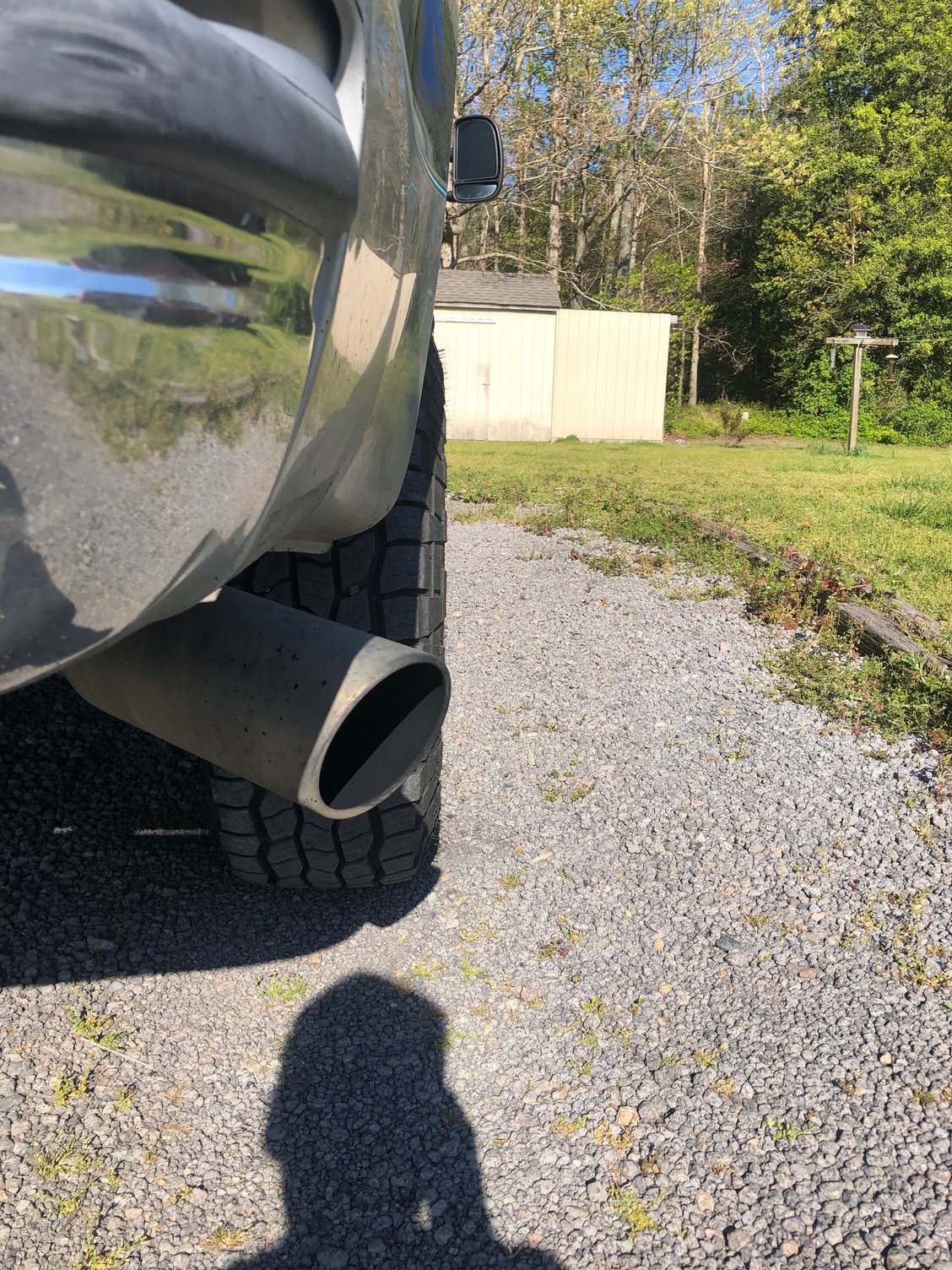

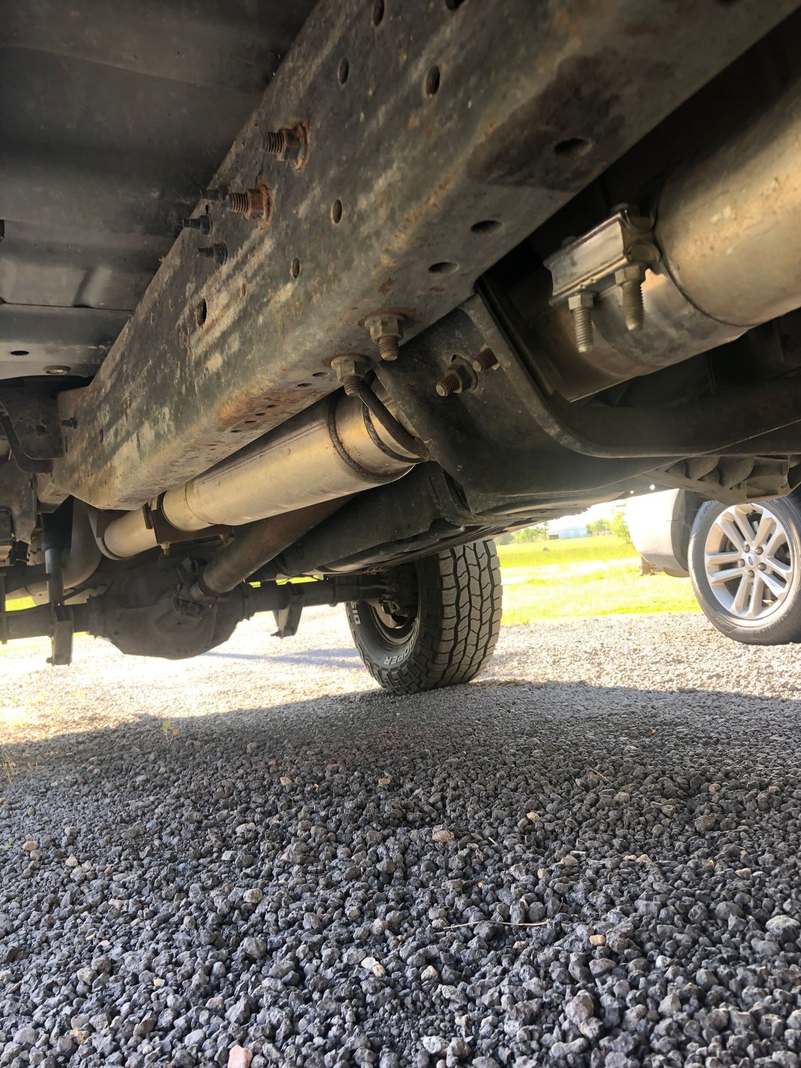

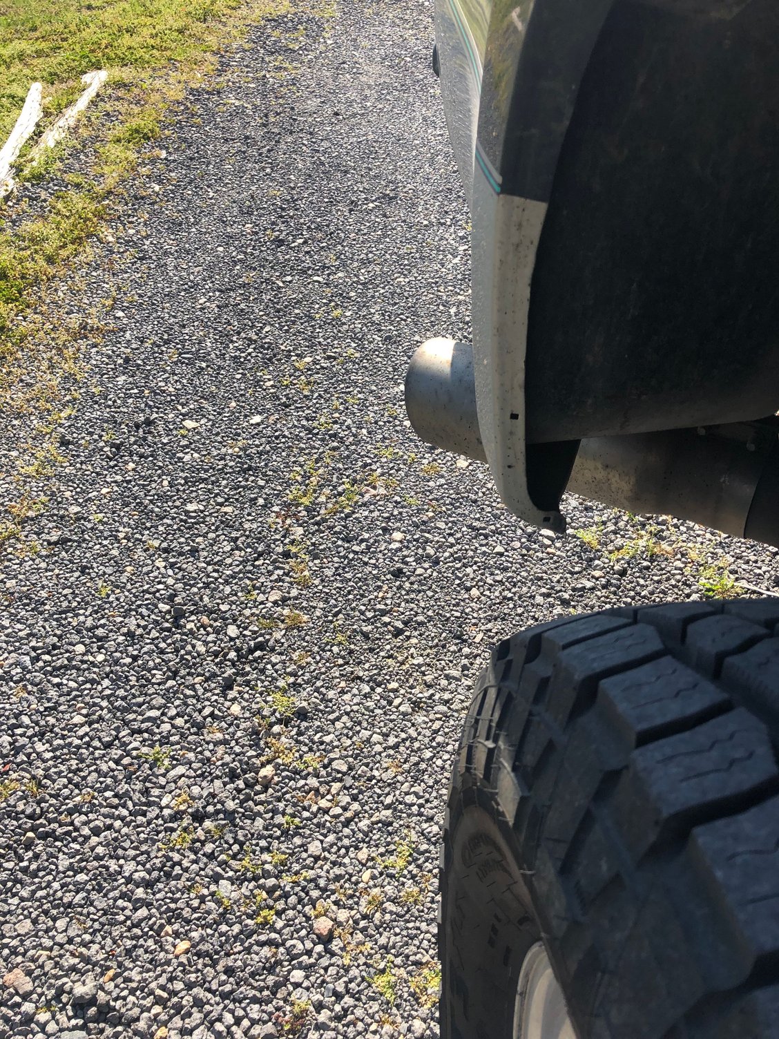

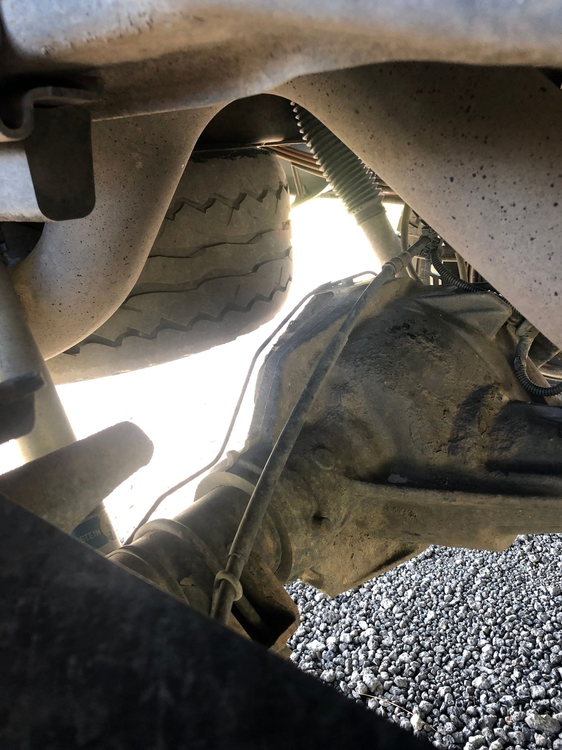

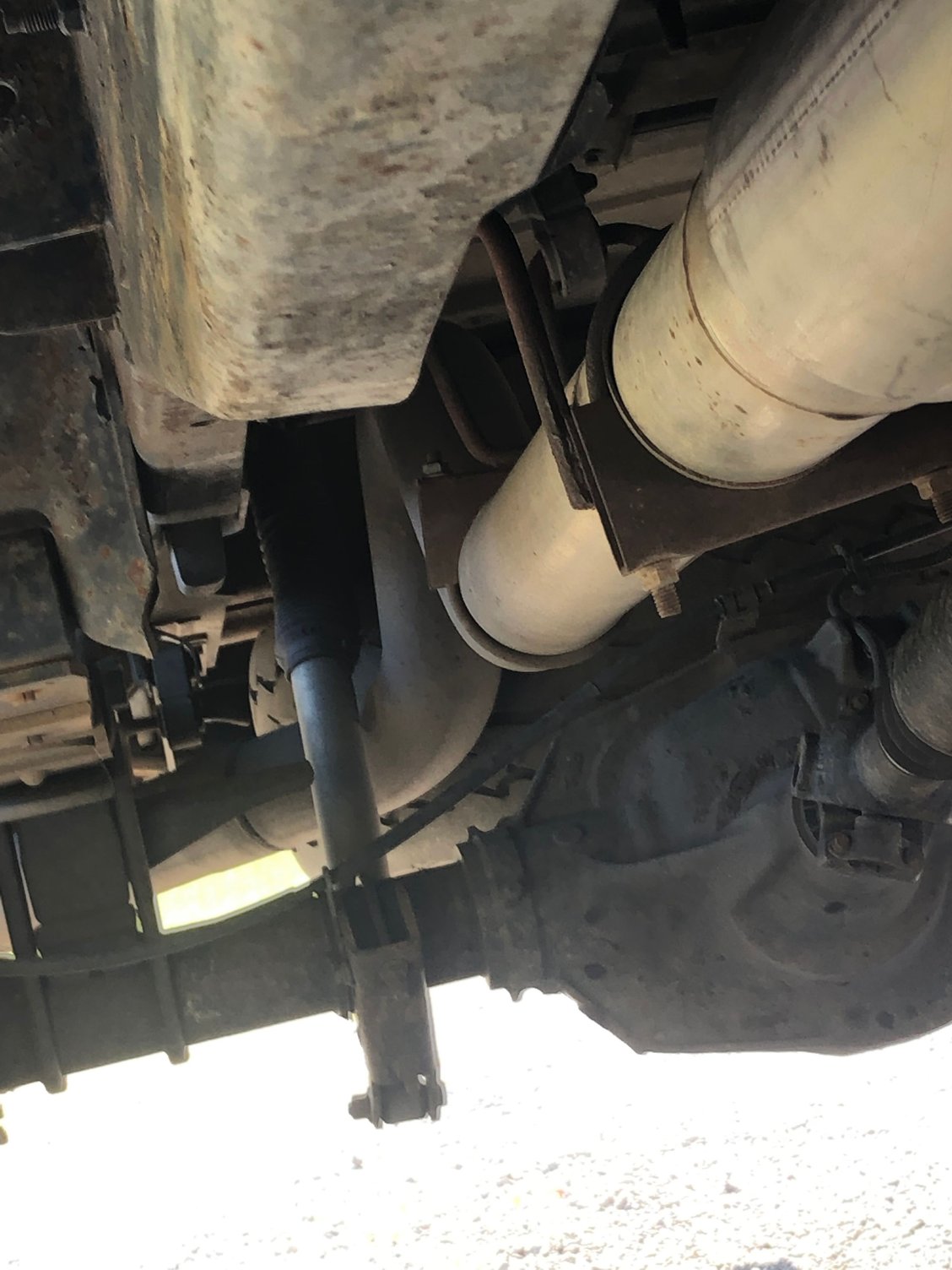

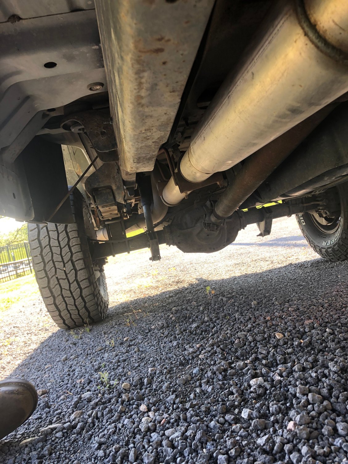

that leak is minor and shouldn't be causing any issues related to drone. I see the exhaust appears to be stitch welded together in addition to the clamps which is good.
Your had absolutely no drone before the tire install? Seems odd this started after you installed tires. I was thinking they put it up on a lift and broke or knocked something loose. Did you go to a louder/larger tire? What cab configuration do you have? Sende a pic of the whole system looking front and back if you can? Is the tailpipe out past the fender?
where in your exhaust is the resonator placed? if its a crew cab your going to want it back close to original muffler around the back of the cab, you want to minimze the "whip" in the exhaust pipe"
Likely you can add a small straight through resonator, glasspack style muffler to stop the drone, but being you already have one that shouldn't be necessary.. You could go to something straight through with a resonator chamber in it like a 40" or 51" Donaldson muffler. But that is a last resort.
I got alot of practice with this building systems for the much more drone prone(lol) 5.9 and 6.7 dodge cummins trucks. I got to where i could build a straight pipe system with no drone. Or a system with a small muffler with no drone. Its all about making the system tight, muffle placement and getting the tail built right.
If I had drone with the old tires, I couldn't hear it because of how loud the tires had gotten (they were toyo at2 305/70/16). I have an extended cab short bed. I went to a slightly taller but also narrower tire that is much quieter than the old toyos I took off. The new tires are cooper at3 xlt in size 295/75/16. Tailpipe is out past the fender. The resonator is placed as far forward as it could go since that is what FTE recommends.
