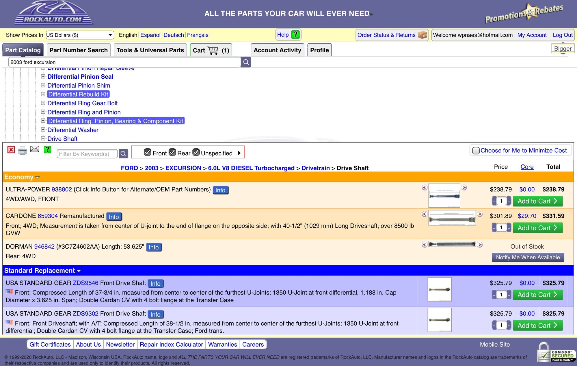

Old Apr 20, 2020 | 06:34 PM

Mine is approximately 42 1/8 flange to center of front joint. I'm at 27" ride height though, so mine is not stock.

I’m at about 28 1/2” so same here. I think I’m going to the LKQ salvage route and just rebuild with my still new Spicer u joints and keep the double cardan in one piece. Measurements are good peace of mind though.

I just put the front driveshaft together. I measured right at 41 inches from outside of flange to center of u-joint cap on the other end, with slip-joint fully compressed. Sorry it took so long, the to-do list is long!

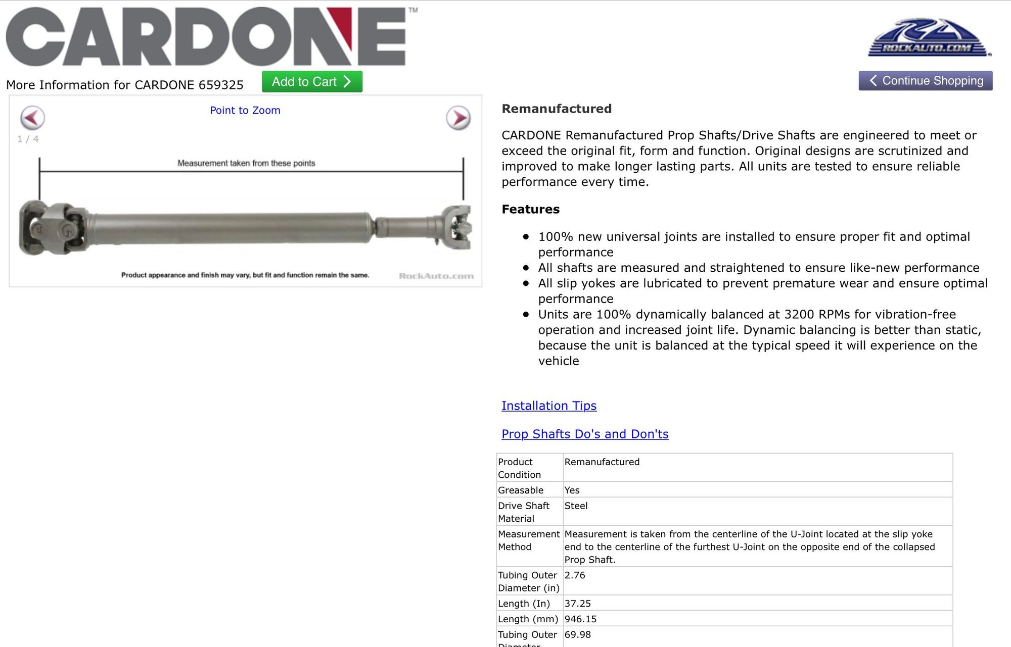

You don't want to measure the shaft. Measure the gap between the flange on the Xfer case and the flange on the pinion...face to face. The driveshaft shop will then build the new shaft to straddle that measurement so the slip yoke can do its work.
