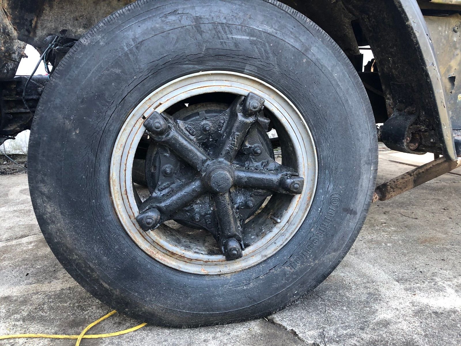

Those are Dayton wheels. Not widow makers. I can't see them clearly on my phone what size tires are on there?
If they are tube type, you can change to tubeless with just different rims and tires that bolt to the spoked center section.

Thanks for the reply! They appear to be 9.00-R20, and after you were able to help me out with calling them out as Daytons I was able to dig up plenty of info regarding the 22" swap with modern tires, so thanks a ton for that!
Also, the PDF you mentioned should help me ID that rear axle today so I'll get working on that and start looking at my best bang for the buck for alternative trans/tire/rear end combos to get that cruise rpm down to 2000 revs. Thanks again for the help, this is why I wanted to post and reach out and help find problems before they start haha!

That wheel is a spoke 3PC SPLIT RIM - TUBE TYPE

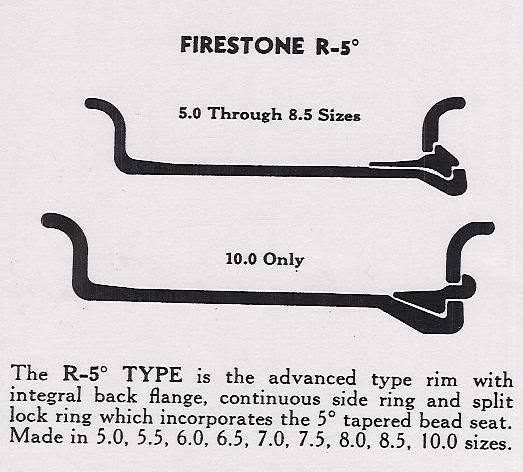

The three piece rim was originally called the Firestone R-5°. It is still in production today by Accuride for use on the demountable (Dayton) 22” size, and is now called the 5° Radial Commander. There is no reason they can’t be kept in service if you want to save them. Stu
Has quite a ring to it. I can hear little kids saying "Daddy, when I grow up, I wanna be a Five degree Radial Commander".
9.00R x 20 tires seem to be an oddball at this point. "Off brand" and ebay sellers. Hhhhmmm.

Feel like we need to ‘splain that the 22” I mentioned is a different animal than the 22.5” you mentioned. The 22.5” tubeless is the size equal of a 20” tube type. The 22” tube type is the size equal of a 24.5” tubeless. So, if the member doesn’t want to keep the stock rims the 22.5” tubeless variety will mount cleanly on his cast spoke Daytons. Stu

Put the engine in before tires. That way you can check the rpm at say 45 mph. I wouldn't want to go any faster on the old tires.
You most likely will need to go to 10.00R/20 if you keep your rims, or 11R/22.5 if going tubeless. The R is for radial. You can still get bias ply tires, but your butt will appreciate the radial.

DAYTON is the name of a wheel manufacturer -
Dayton is like tissue paper., All tissue paper is Kleenex, just as all spoke wheels are Dayton.
