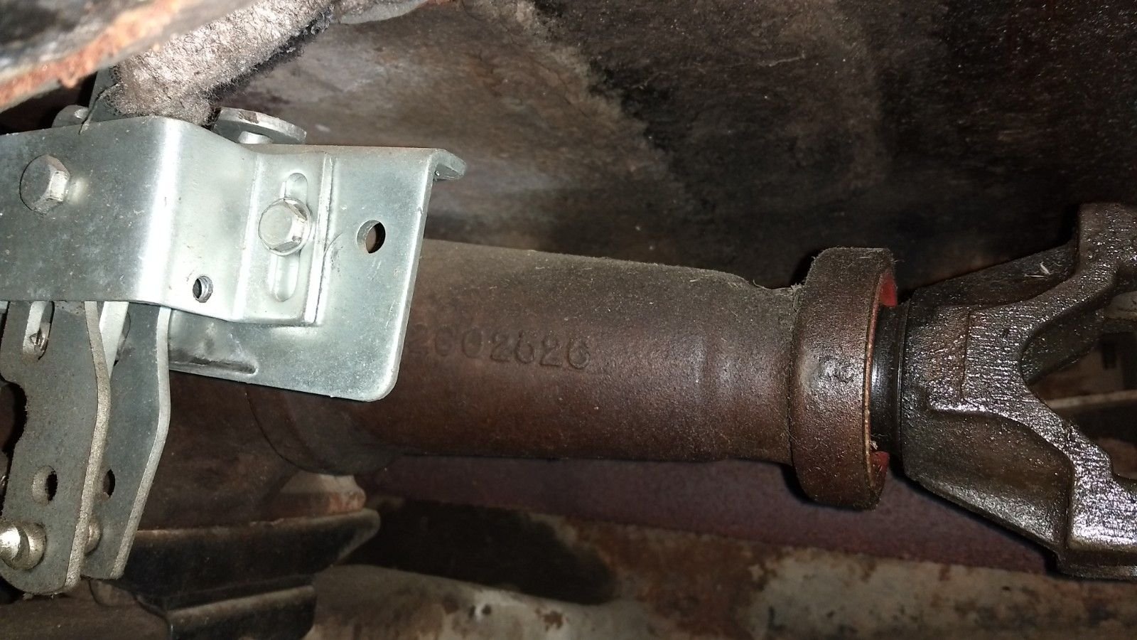

I'm looking at the drive shaft on my 66 F100 longbed and one of the welds looks pretty ugly. That u joint is also tight. I'm suspecting someone shortened the driveshaft.
Front drive shaft is 25.75" long from u joint center to the end of the spline.
Rear drive shaft is 39.5" long from u joint center to u joint center.
I would greatly appreciate it if anyone that has this drive shaft could please provide similar measurements....

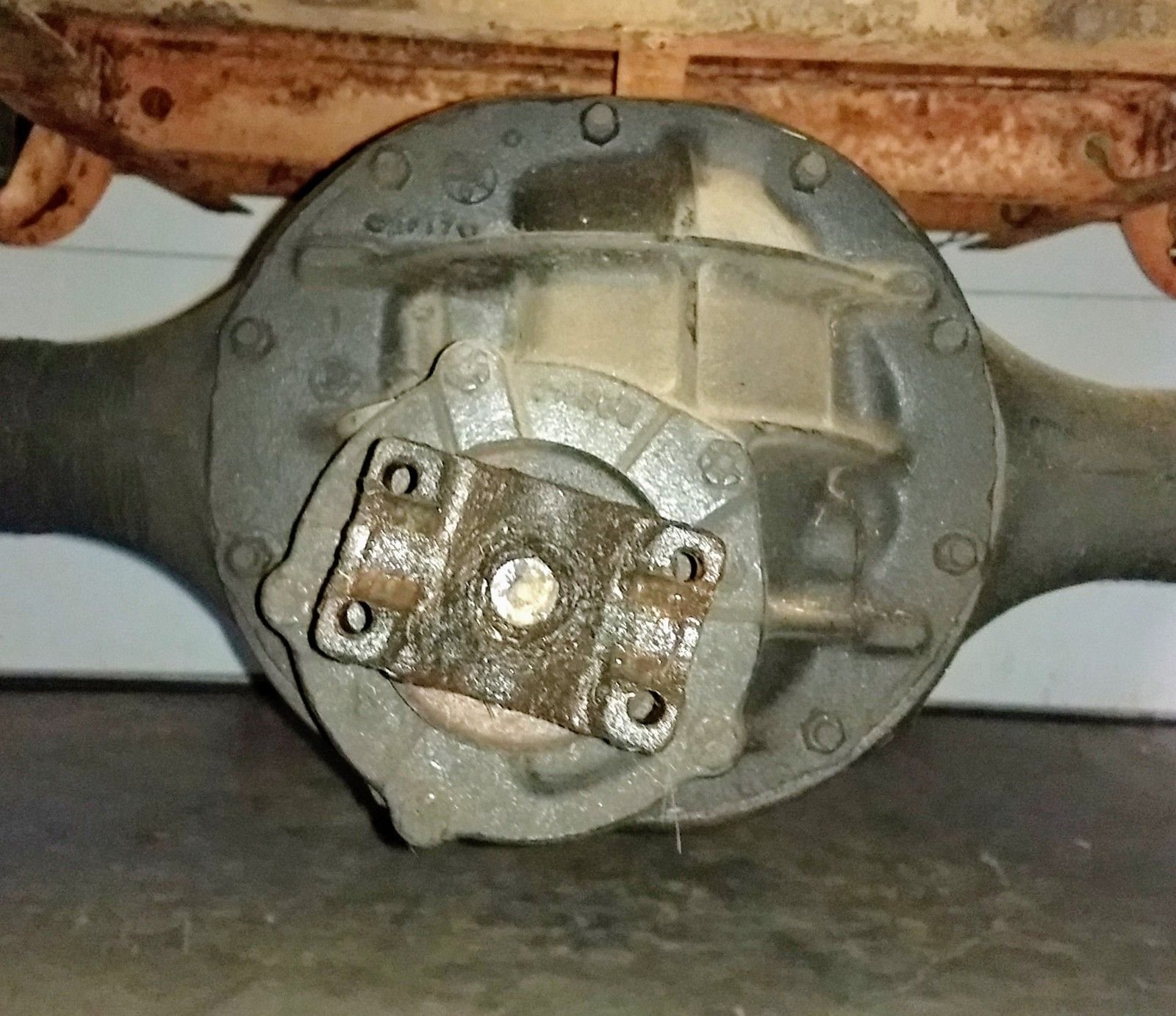

Wheelbase is 129 inches. Maybe the transmission and rear end are not what I thought they were?
Old Apr 21, 2020 | 10:02 AM
Crop Duster's Avatar
Crop Duster
Joined: May 2015
Posts: 4,474
Likes: 974
From: Tri Cities, TN
That's not the transmission that came in your truck. I'll let someone else take a swing at what it is but this is what your transmission should look like. What end of TN are you in.
