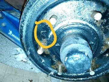

I was driving the truck this afternoon (around the yard) and noticed a small brake fluid leak on the front driver side wheel, just started today.There are 3 large screws on the drum any tips on getting these out. I sprayed them and the lugs with heat and PB blaster. Letting is soak a but more before I try again.

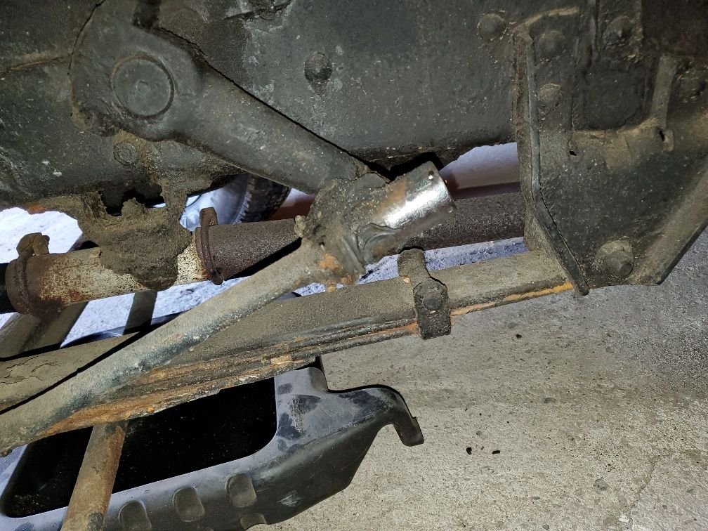

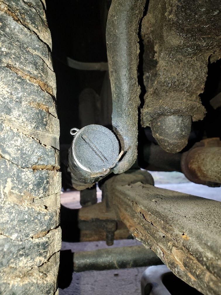

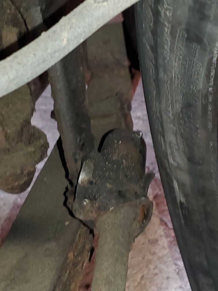

I had rims made using original centers where the machinist strived to make them as close to stock spacing as possible. The truck normally would have 235/80/17 on it but I was able to get a set of 245/70/17 for free so I could get it off blocks. The tire is rubbing when at full turn to the left and hit the part in the picture below, if I turn the opposite direction about 1/2 of the steering wheel I get about half an inch clearance. Any way to adjust this so it stops prior to rubbing. Anyone know the name of the part with the split pin the boot was bad to begin with and now it is toast.
Rubs tire at full left
I can't find this part online anyone know the name. The boot is no good and the rubbing made it worse.
clears at 1/2 turn of steering wheel

That part is the drag link. There is no adjustment there, except to take up wear in the ball and socket. Steering stops are located on the bolt on arms on the backside of the spindles, but if you can only turn the wheel half a turn before a tire hits... You have other issues.

If you have 3 screws in the face of the drum they are definitely removable . I would pull the hub assy. with the drum, that way you can get to the screw threads with the penetrating oil and you'll have an easier time removing the screws. And if you don't have a manual impact driver, get one, they work great on stuck screws. Then you can never-sieze them when you put them back in. This will also give you the opportunity to inspect, grease and adjust the wheel bearings.

Drag ink boot
Mid Fifties has the drag link boots Its listed in the 53-56 section. I`m not sure if the boot is the same for the 64 but it looks close.

It did have dually's at one time but the previous owner told me they got stolen Vin shows dually from factory. Finding a set of dual rims is like finding hens teeth. I may someday swap it out for duallys but for now SRW. I will try as you mentioned pull the dust cap it was late when I put her to bed.
I have attached a image of the screws.

Perhaps my explanation was poor, If it turn hard left it will rub, if I then turn the steering wheel 180 deg to the right (1/2 a turn of the steering wheel) I get 1/2 in clearance. It only rubs at hard left.

I use the BFS for removing those screws.

Heat the screw until red, then remove it.
