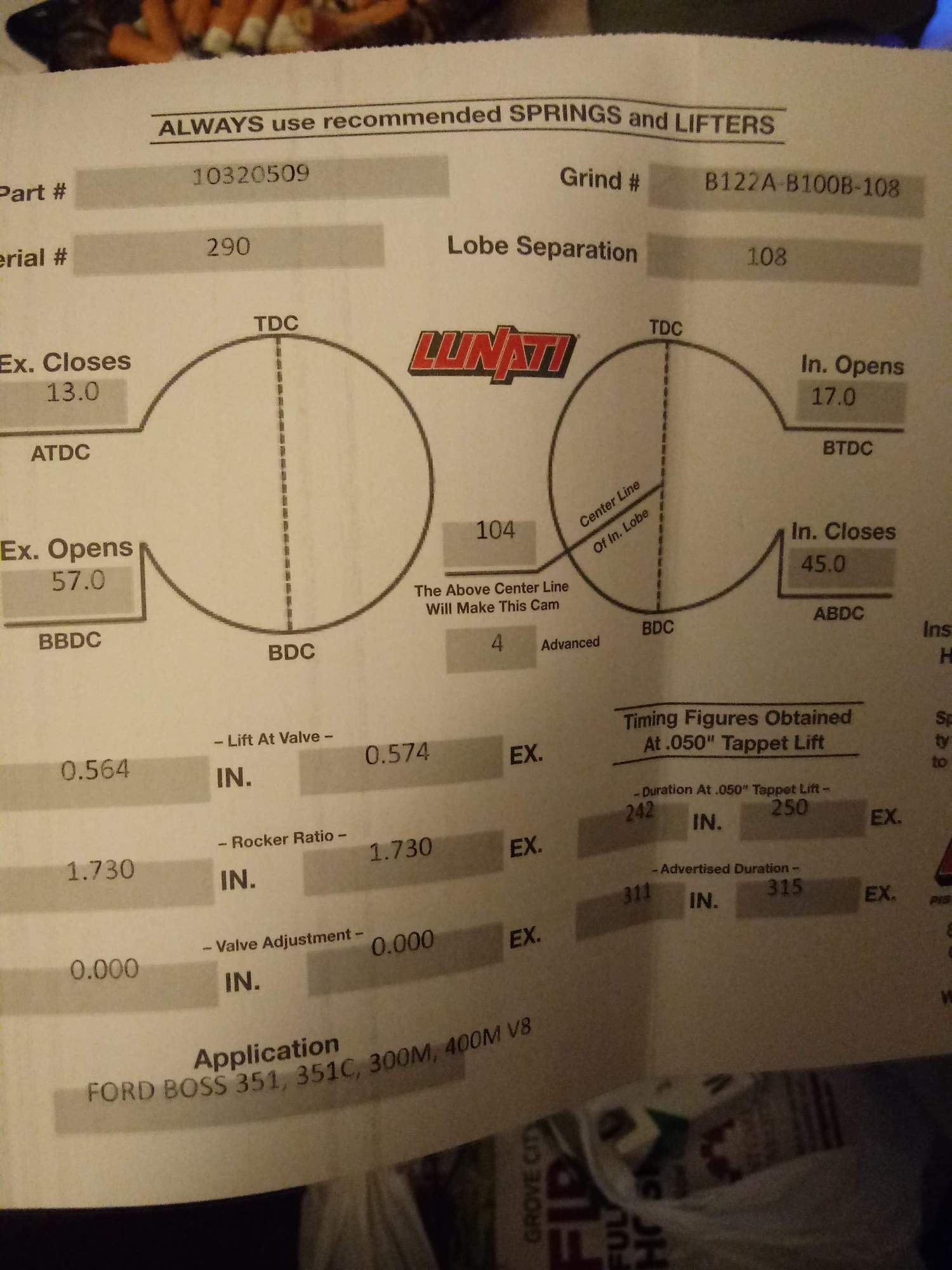

Aaaand now shopping for a cam since I just remembered this thing won't like a 6-71... Recommendation? Heads are set up for flat tappet up to .580 but realistically more like .525-.550 intake side with boost

It's not going to be street driven very much... TMI is estimating 13.61:1 and my numbers come out 13.862:1 (different gaskets) so it's pretty high. I'm looking at methanol as well but if I were to use the Lunati I have it'll bleed down considerably.
