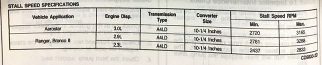

I stumbled upon the answer in the service manual. I figured it would be in the A4LD section but i was wrong. It was in the Automatic Transmission General Service section. I never thought to look there.
