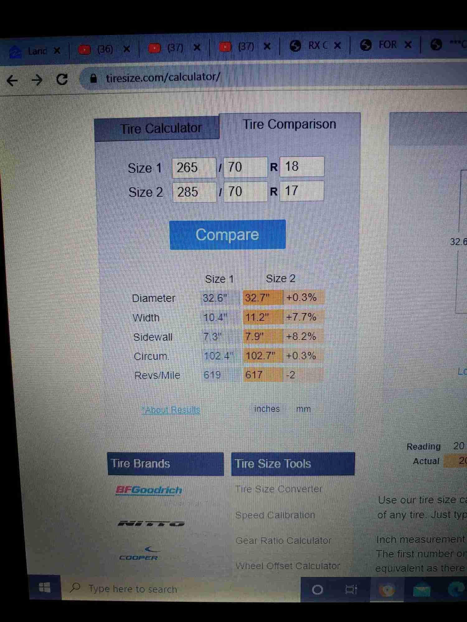

One cheap way to drop the @$$ end a little is to get rid of the 350 OEM lift blocks and get the shorter 250 lift blocks. But anyways, I'll assume here for this discussion you want to drop down to a 32 inch diameter tire. Using the Cooper XLT AT3s, I chose a size in the 18 inch size, LT265/70R18 and a 17 inch, LT285/70R17.
Using this site, https://tiresize.com/calculator/, you can compare sizes. There isn't much of a difference between the two except the 17 and 18 inch sizes. Check it out:
You can see they are about the same diameter, but the 17 inch has more sidewall and is wider. You can go with the 17 or the 18 in a smaller size. It all depends on what you want to do and how much money you want to spend.
