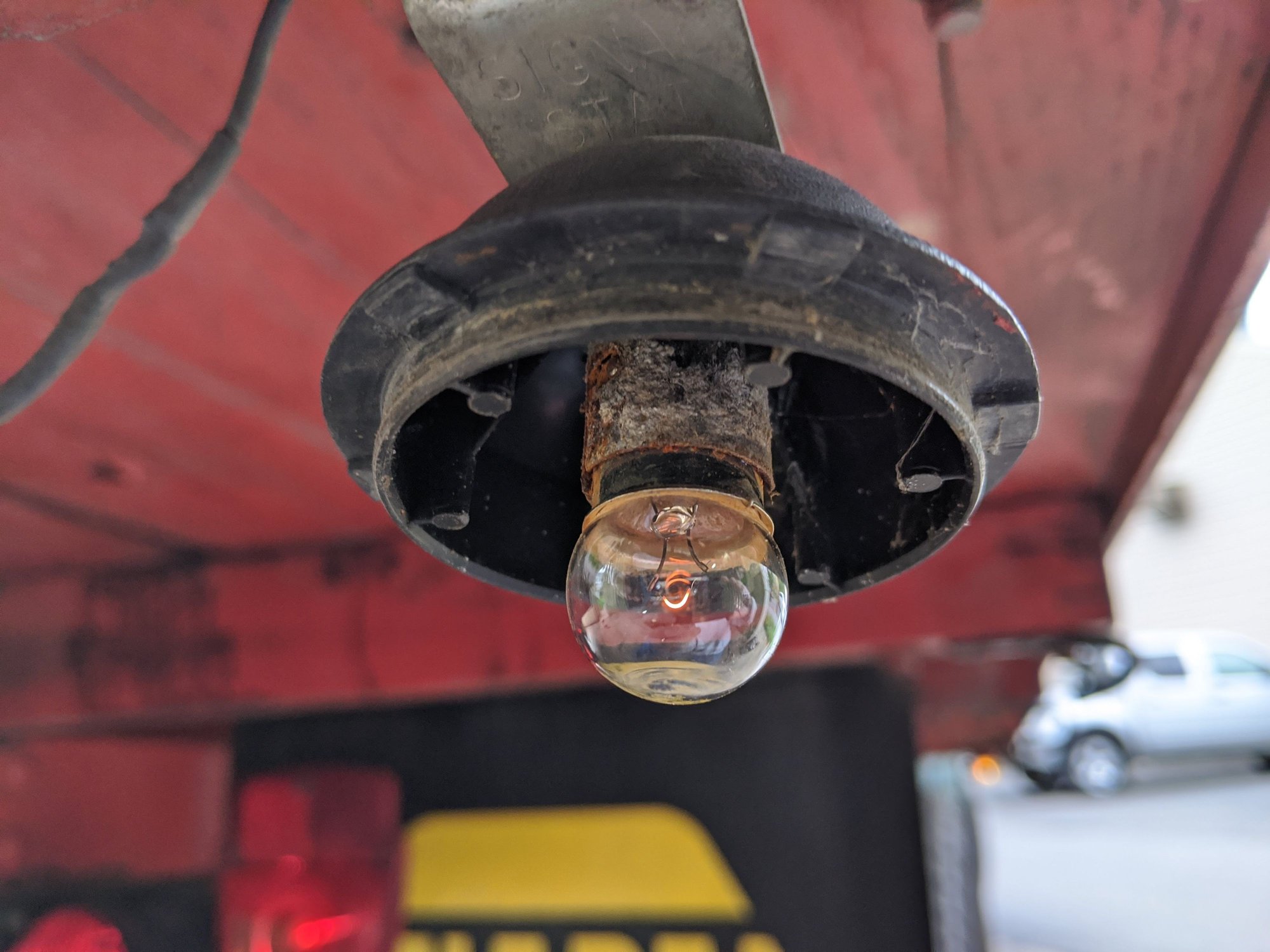

I'm getting my 55 F350 ready for state inspection. I had a left rear marker light out and the right rear was dim. I was hoping the left light was a burned out bulb....
Well it wasn't. The light and socket were so badly corroded that I couldn't get the bulb out.
Fortunately i had a NOS Yankee marker light in my stash. Then I looked at the right rear light. It too was corroded but it was grounded enough to provide a dim light. I also could not remove the bulb.

What really ticks me off is that two good 6 volt bulbs will be wasted if I can't free them and get them out! If the new lights come with 12 volt bulbs I'll have to venture out to a parts store to buy some 6 volt bulbs.

Try a bit of vinegar on those bulb holders Abe , it might just free them up .

A can of grease with a small paint brush, ,paint the next assembly with grease maybe,like one might do with battery terminals.

Sad thing about those cheap aftermarket lights. You can bet a original Ford bulb socket wouldn't corrode like that! Abe, when you put back together use some dialectic grease in the bulb connections, it may help, but if you got ones off Ebay for 2.99 they'll prolly do it again!!

Two solutions, Abe:
1) Drill a small hole in the bottom of the lamp base to keep condensation from building up inside the lamp.
2) Install a hermetically sealed LED beehive lens.
The corrosion is caused by the dissimilar metals (brass and steel) in contact with each other in a wet environment.

Just a thought, try spraying something like PB Blaster into the light socket and let it soak a while. Maybe it will loosen them enough to remove the bulbs. WD-40 makes an aerosol spray as well to remove rusted bolts and nuts. I was shocked how well it worked the first time I tried it.
They aren't cheap as to quality. The two with amber lenses are Yankee and the red one is Dietz, all good names in the lighting industry. The one I'm replacing is a Signal Stat.
Originally Posted by Mixer man
Two solutions, Abe:
The one lens already had a hole dripped into it. But it looked like it got clogged up with dirt.
I can't find my PB Blaster. I used WD-40 and I know it is a water displacement not a rust eating spray and also used something made out of plant oils.... forget the name. So its been soaking for 24 hours. I'll try tonight.
But really, even though I say I'm a tight Penna Dutchman, I am half joking abouit saving the bulbs. If I can get them out , then great if not, they don't cost much. But if I can get them out it will save me a trip to the auto parts store while I am practicing social distancing....

I just got the one bulb out. Since the old socket is toast, I took a small screwdriver and prief back the rusted socket where the pins go and that loosened it up. I then put it in another socket I have with out a bracket and therefore can't use. And it works.

A coating of dielectric grease on electrical terminals and bulbs prone to moisture will help seal the connection/assembly.
