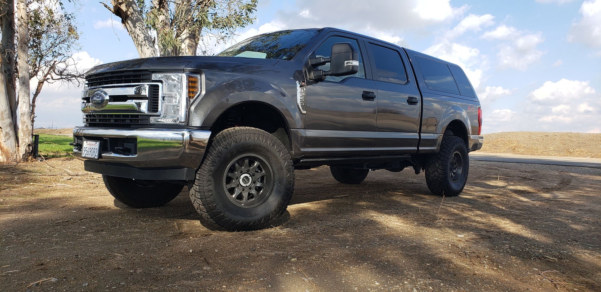

I'm not understanding the comments about Carli using the same coils on a gasser as they use on a diesel. When the 7.3 came out they developed coils specifically for the gasser. I have them plus the Carli add-a-pack in the rear.

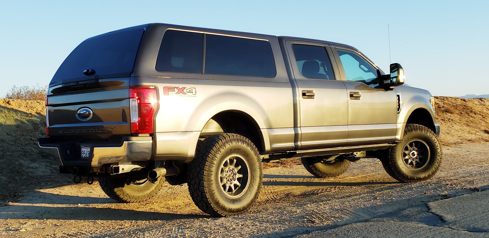

What brand and model of camper top?
ARE Z Series. Great fit and perfect color match.
