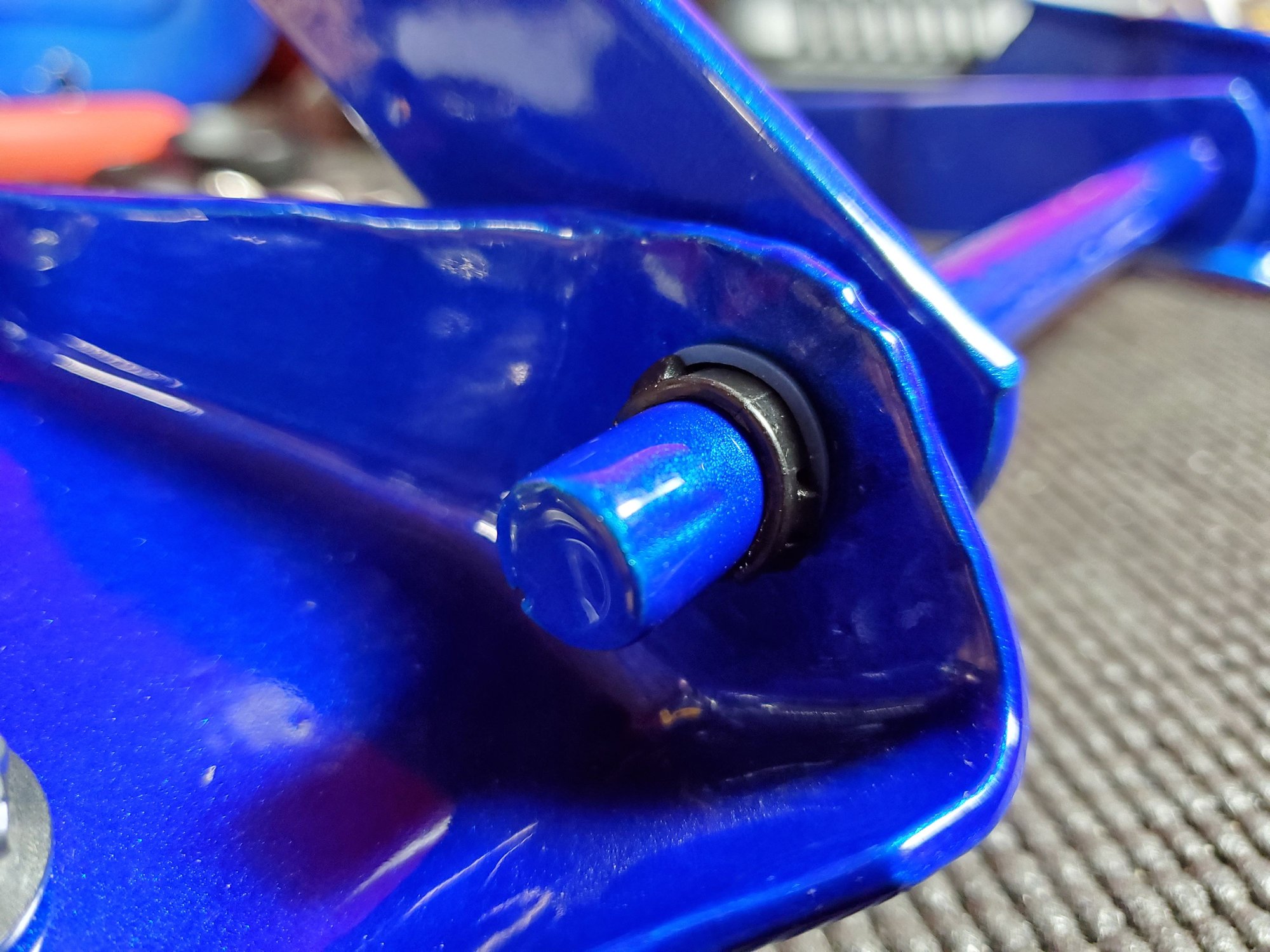

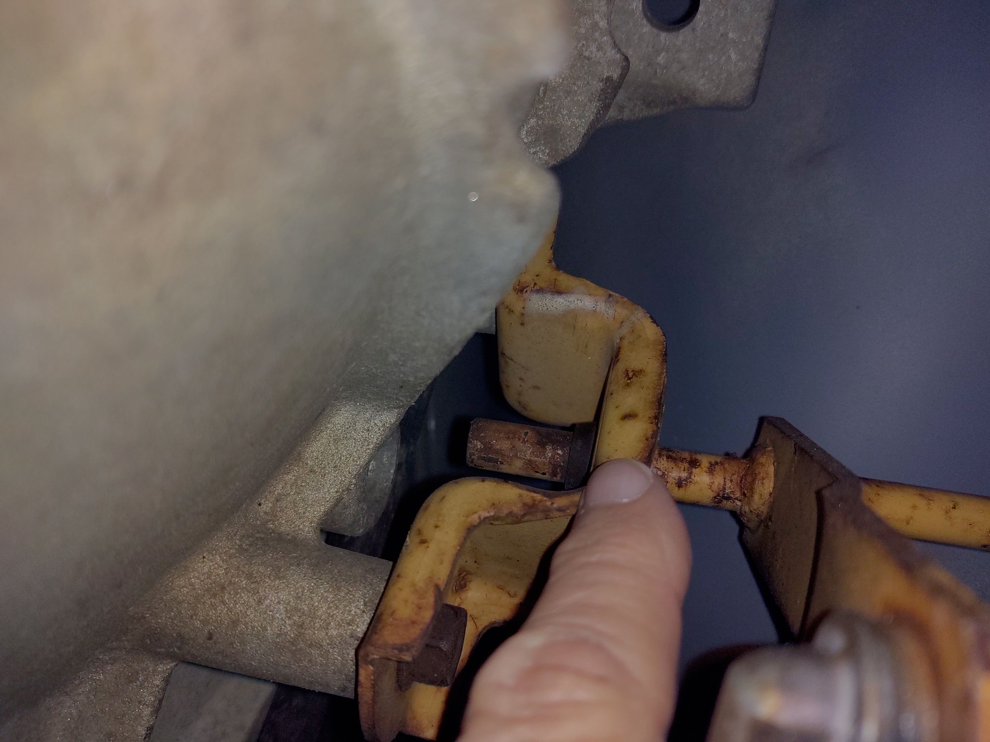

I'm in the process of completing some major updates to my truck and I am having a helluva time finding the bushings for the main link rod that is held in place with a bracket on the transmission and the other on the frame. I'm figuring the only solution is with a 3D printer but I'm hoping to find some NOS bushings so I can finish this up. Any help will be greatly appreciated. Thank you

ND, they were just delivered and they are not what I need. I need the large bushing for the main connecting rod as shown below. I had to heat this one up to make it soft enough to remove and now it is no longer useable. Are you able to come up with the p/n for this one? Thanks

I thought I was pretty clear from the outset that I'm looking for bushings. Not brackets. The arrows very clearly point to the bushing locations. Not sure how much clearer I can be. The only reason for the last image being late to the game is I thought I had lost it in my shop.
