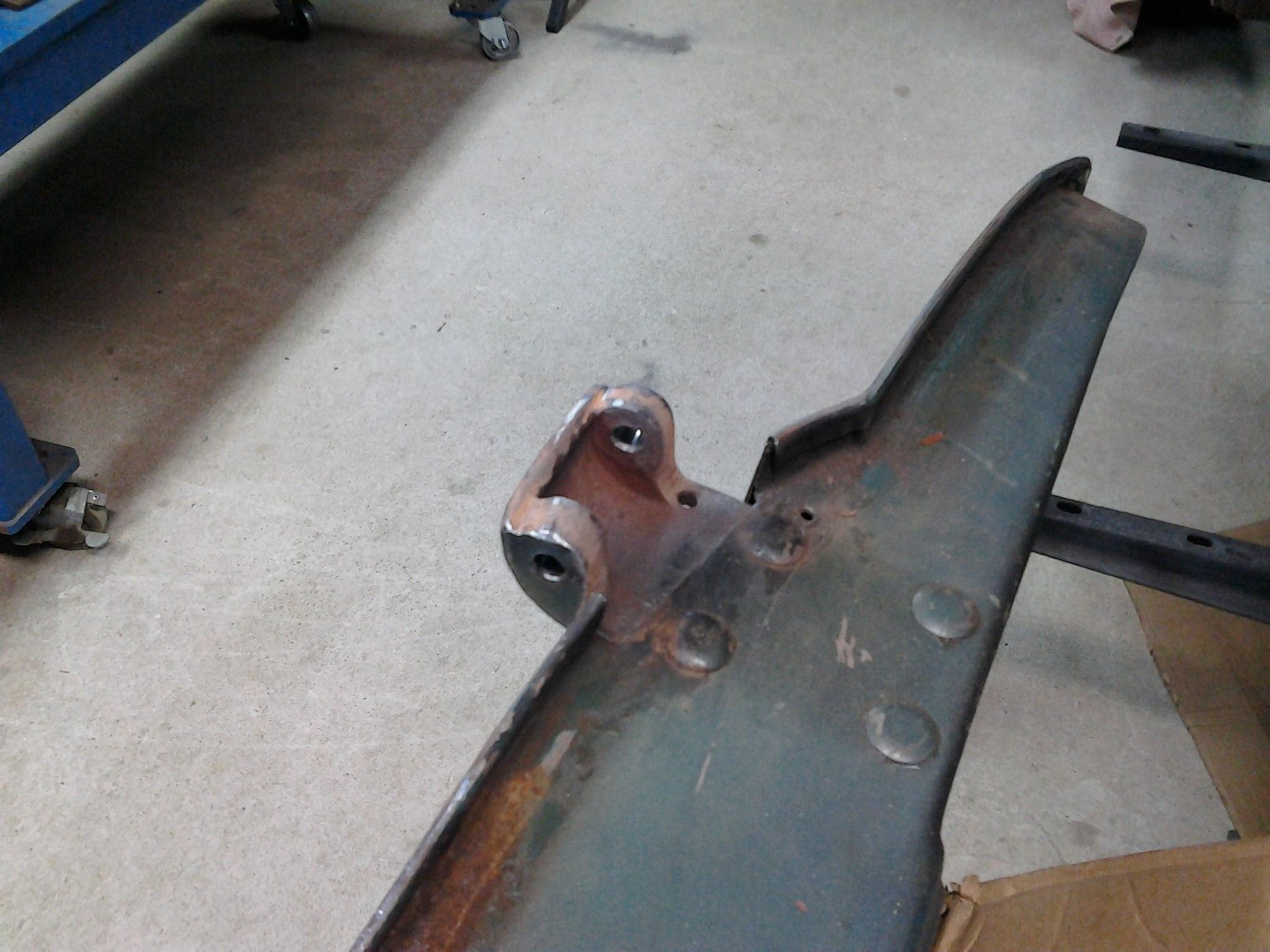

Mike, is this the part of the door hinge you are referring too?
Yes, I was assuming that I get that side when the hinges come. I maybe wrong........

LMC website shows both pieces when ordering replacement hinges......not sure how they attach to the door, maybe flat head screws or weld them?

A possibility to refasten the door part of the hinge would be to thread the hinge and use hurricane bolts with Locktite in lieu of rivets. No?
Some people call them sidewalk bolts.

I disagree with putting the hinges back on with Philips head unless you are doing an strict restoration. I have always upgraded mine to a allen head bolt that looks the same. I also beef up the door post triangles with nuts of same thread welded to back.As for the door side i have had both riveted and bolted doors on my trucks. What i noticed is the riveted ones are solid as the day installed but the bolted ones i beefed up. Im not sure if its a year or model difference why they're different.
