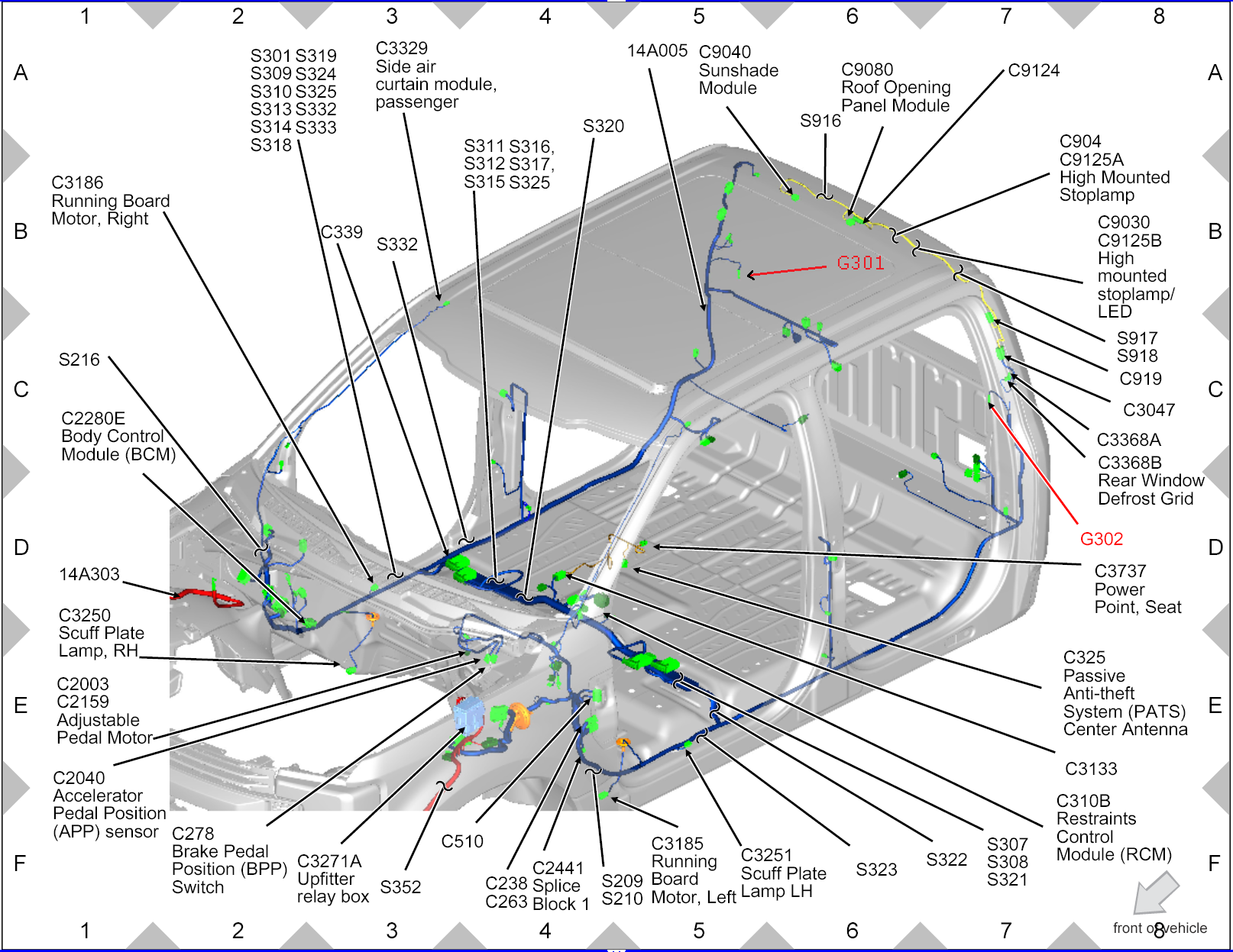

I would agree with going to the frame. On these truck to the body, no. If coming from the back seat area, G403 might be convenient.

I came through the floor right by g403, that would be a pretty easy point to get to with the bus bar. Again is there an advantage to adding this ground from the frame to the bus bar that is already grounded at the battery?

For my 2 amps (300w + 600w), I used the official ground points (G301 and G302) on the rear cab wall. I only needed 4awg gound wires, but these have worked fine for my install. Both runs were 3ft or less.
