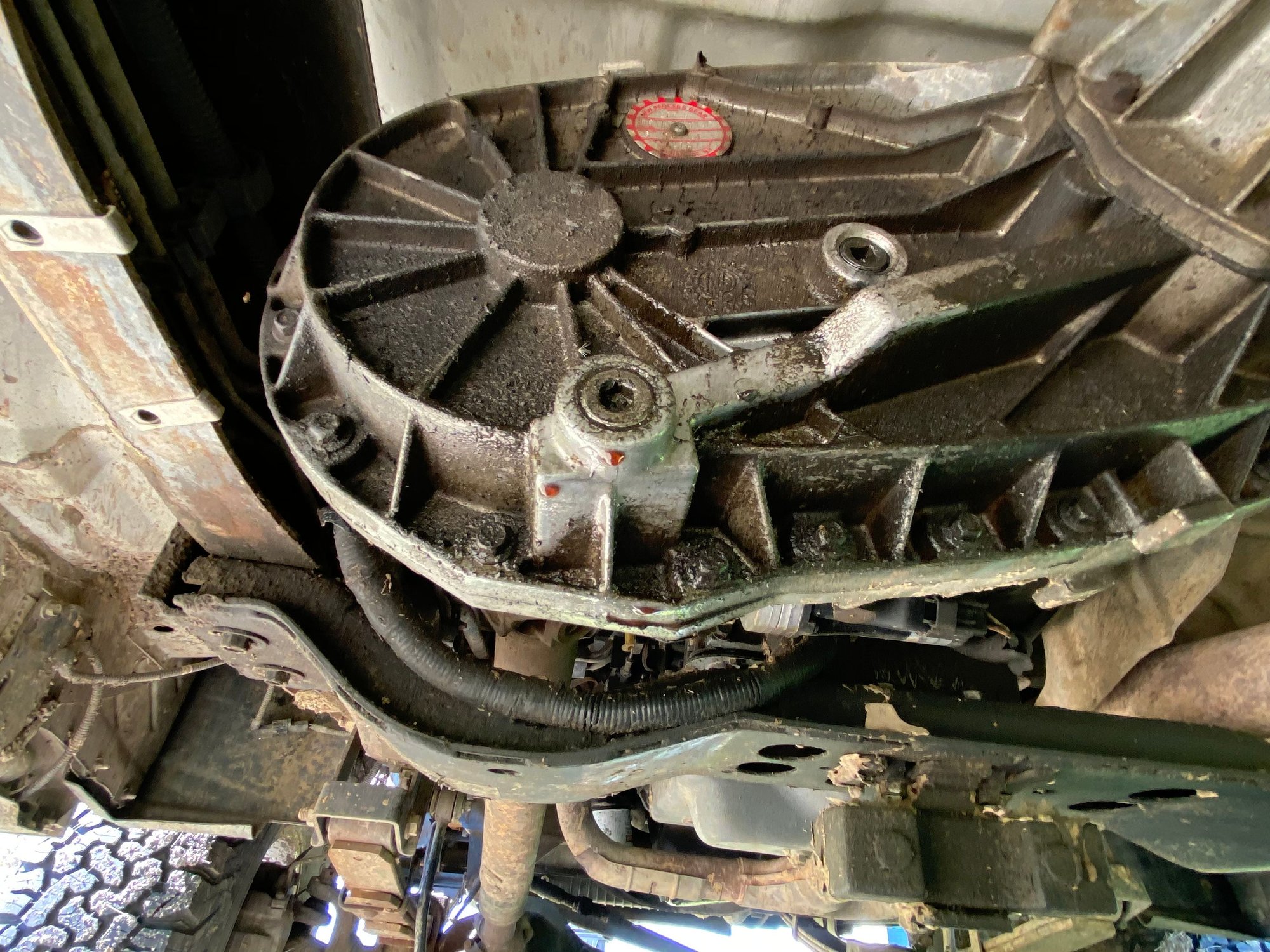

I've had this 2000 Ex 4x4 Ltd. for 6 months now, my 1st . 270k mi. I was crawling around underneath it to look at tags on my axles since I'm about to regear, and saw this fluid hangin out on the bottom of my transfer case. I wiped it clean, took the truck for a quick spin, came back and saw nothing, so I went on with the other things I needed to do. I went back out just a little bit ago, and it's the same picture all over again; three drops of fluid hanging there. What steps do I need to take from here to diagnose it? And will it hurt anything if I powerwash that crud off the back of my transfer case and start "fresh" with this whole process?

well based upon what I saw, That lower plug is to drain the transfer case. So it appears to me that is dripping from there. Use a racket and give it a tug to ensure it is tight. Then wipe and watch.
Might also be a good idea to take the top one out and verify the level.

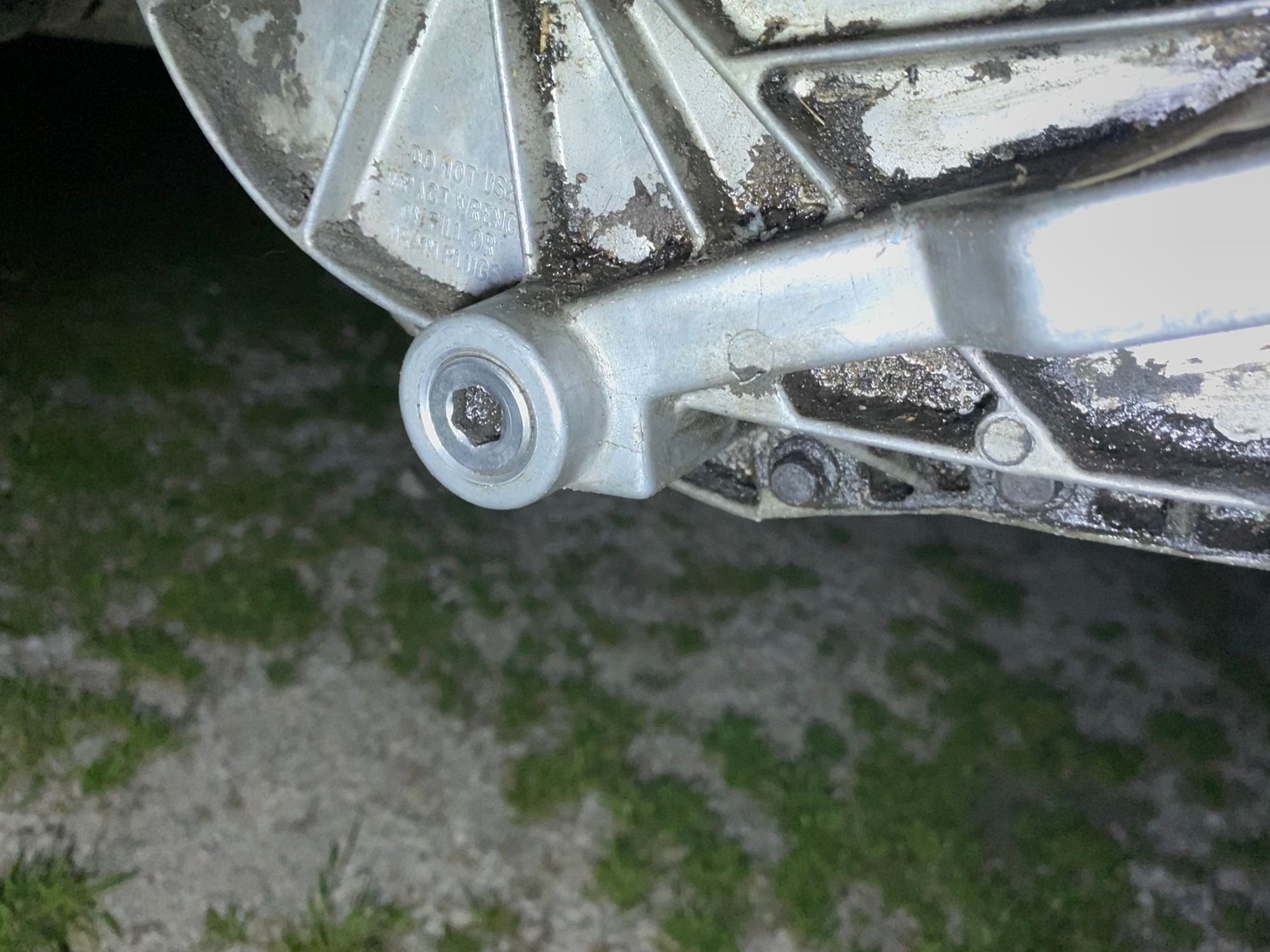

Take a real close look at the 3 o'clock position of the drain plug. Could be a crack hope it's not.

Reading that was enough to peel me away from Lethal Weapon 3 and investigate. I hit it with some brake cleaner, a little steel brush, and a few shop towels. It looks like the dark line from before was casting mark or something. Am I crazy?

that last pic looks like there are no issues with a crack or other obvious defects.
Still I would suspect something with the sealing of the plug. Now that it is nice and clean, monitor it.
