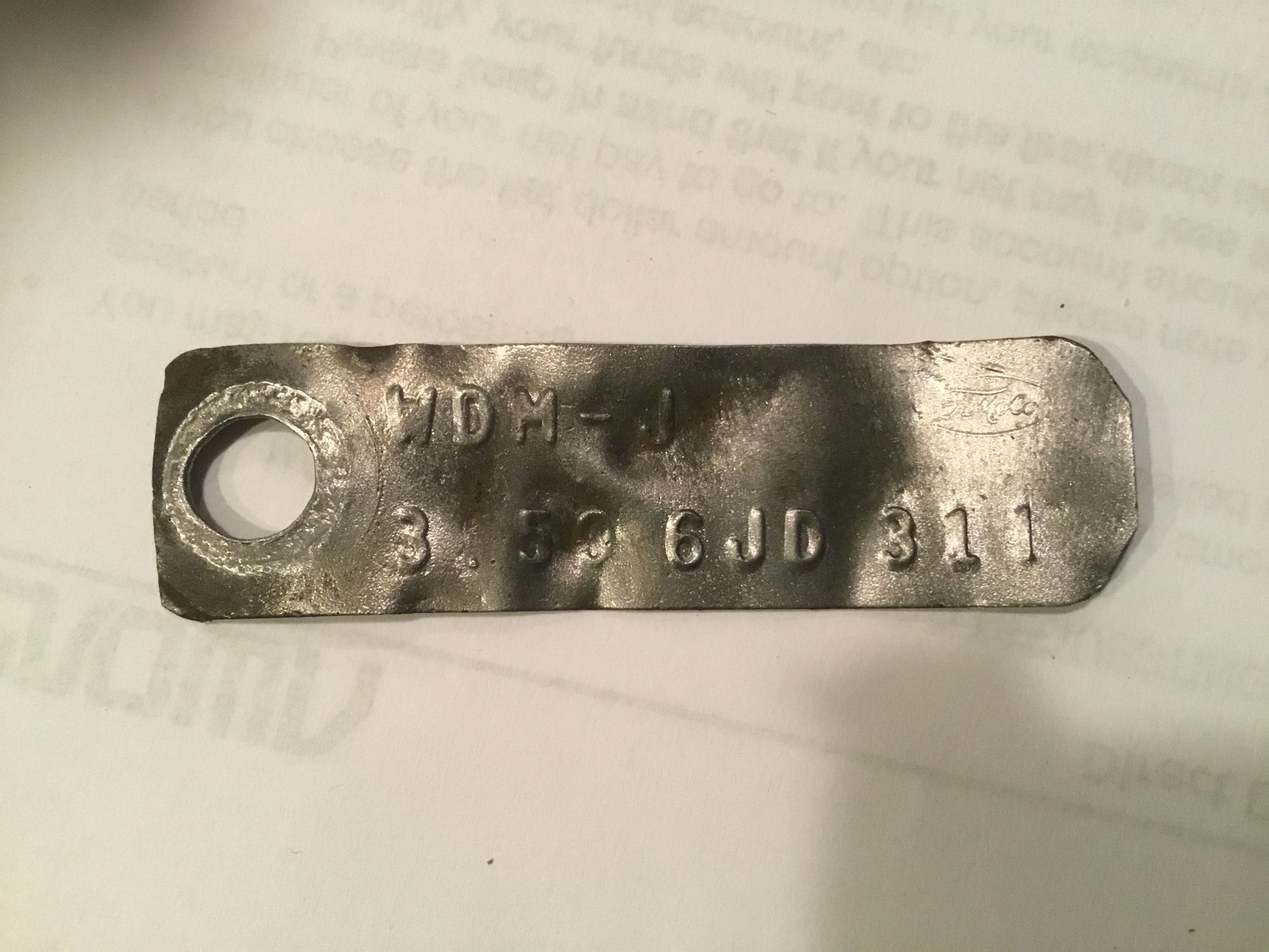

9” Rearend Tag Deciphere
Only thing I’ve concluded is it’s a 350 gear ratio. Anyone care to tell what the other stamping mean.

WDM-J = Ford 9" Rear Axle / 3.50-1 / No Limited Slip.
6JD = Assembled the 4th week (D) of September (J), 1966 (6).
311 = Assembly Plant code.

Thanks Bill, I knew you’d come thru again.

This will help me with looking for the correct axle bearing and inner seal.
