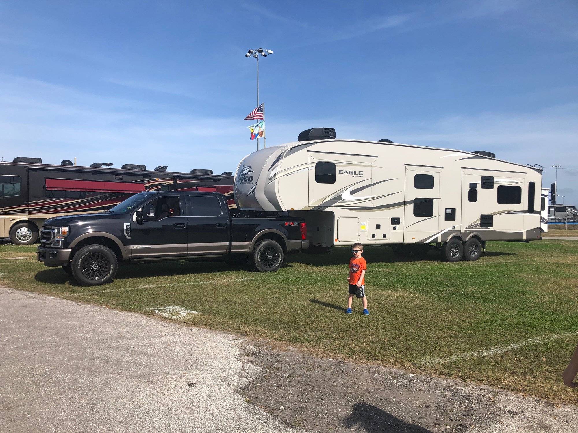

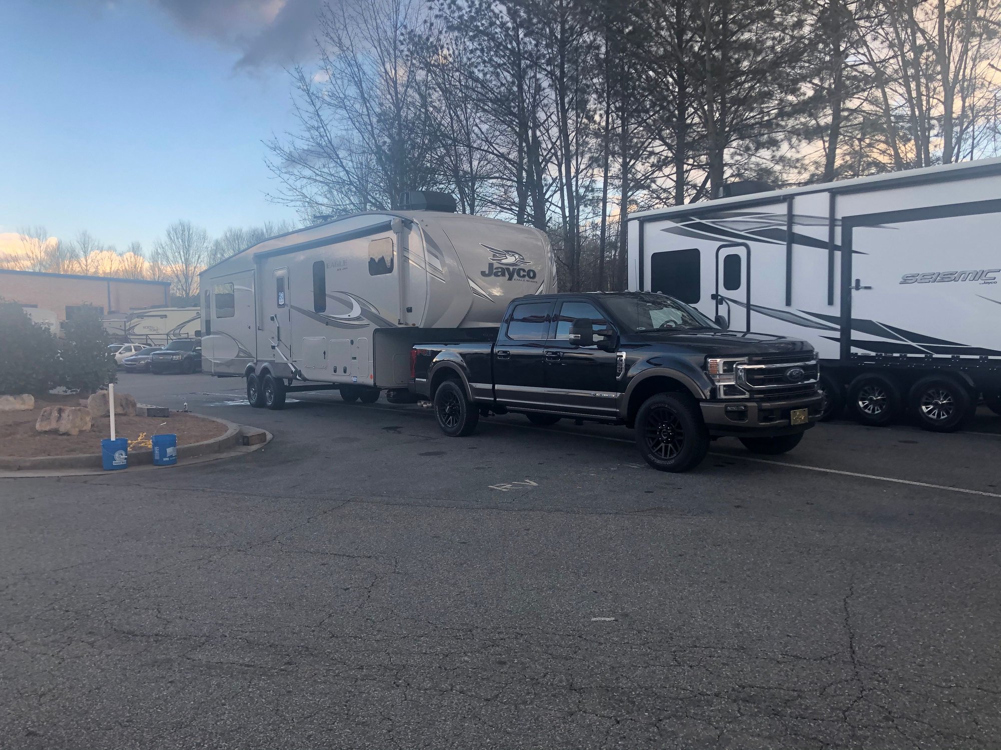

I have a 2020 F350 SRW. My 5th wheel squatted my truck too much also.
I didn’t want to fool with airbags. I installed Tembrens. I actually was going to install Sumo as well but felt like I couldn’t get an answer to the same question your asking.
I believe the Sumos would be great, but so far Tembrens have been perfect. They fixed the squat, so easy to install, no drama.
Went on a 2000 mile trip with no issues. Keep in mind the 2020 rear leaf spring block is shorter so the Tembrens/sumo sit much closer to your axle than the 17-19.
I was concerned but for my use I think it was a good thing. The below photos (Grass Photo is after Tembrens) are deceiving. Because the photo in the grass wasn't as level and I have a far greater load on the truck. 1820 lbs total and 640 lbs more on the rear axle that is CAT scales., generator, fully loaded trailer, fuel, etc. The picture in the parking lot was a completely empty truck, completely empty trailer (Brand new truck picking up new trailer from dealer).
In person the before was actually embarrassing, the after tembrens the truck sits almost perfectly level, not quite a half inch low in rear, but to naked eye it sits level.
After
Before
