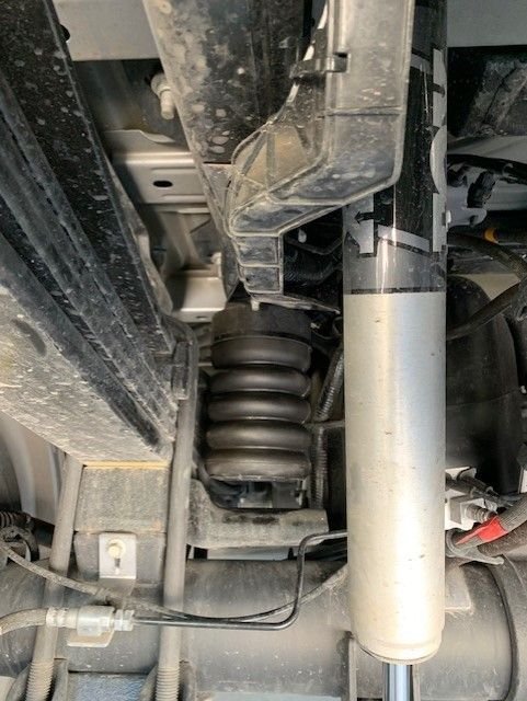

I got the black Sumo's installed today. I wasn't able to tow our fifth wheel but maybe will do a short test tow next week. I did hook up so I could see where it sits before and after the install. Without the Sumo's my deflection is right at 3 inches. With it I'm at 2 1/4 inches so I only gained 3/4 of an inch. At first I was disappointed but the more I looked at it I could see it did make a difference in how the truck sits. From a visual it appears level. Without the Sumo's the back end of the overload spring was firmly against the stop. With them I could get my finger in between the stop and the spring. I finally decided it is just right.
My first try was with all 3 spacers which gave me about a half inch between the springs and the bump stop. I did a test drive to see if it affected the ride. I really couldn't feel any difference but decided to take one of the half inch spacers out to give a little more clearance. I hooked up again and surprisingly the deflection didn't change so I'm leaving them where they are.
The first picture is unloaded, the second hooked up without the Sumo's and the third with them installed. Forgot to say my hitch weight is right at 3200 pounds.

I finally got to do a test tow with our fifth wheel today. I knew immediately the ride was way too harsh. I could really feel the bumps. The springs come with 2 half inch spacers and a one inch. I had already removed one of the half inch spacers so I removed the other one. Much, much better ride wise. In fact, it was smoother than it was with my previous 17 F350 dually.

Sounds like you are a happy fella, enjoy. I’m running just two half inch spacers. The instructions state to run a minimum of a half as the base plate is angled and the 1 inch is just a bit larger than the angle. I would take the 1 inch off and put the two ½ inch

The Superduty spring doesn’t need additional bolts like the one in the F150. Due to how they mount on the frame the SD version had a threaded rod attached already and you can adjust the spacers with the length provided.
They don’t have to touch empty as the post above mentioned as you he stated. Not only you can select the spring color (density) to obtain your desired effect but you can also adjust when it engages and how much compresión you have empty vs loaded.
I run two of the ½ inch spacers.

That defeats the purpose of the idea behind the Summospring. The idea is you set it and forget it. I understand that some people switch trailer, but most will have the SP set up for the heaviest trailer or the one they tow the most.
if you are going to add spacers when towing and removing when not, might as well go with airbags.
I’ll give you my example, I tow a 35 ft TT that is close to 9k loaded and a TW of 1,400 lbs. if I add all 3 spacers, that is two inches worth of spacers my truck will ride rougher even with the trailer connected and the hitch with just a few washers. The truck will also tend to oversteer. I can also feel them while empty.
with two ½ inch spacers the truck rides the best when hitched to the trailer and I don’t feel them when empty.
i have an equalizer 14k, I run 6 washers and 1 inch worth of spacers. This provides the best ride for me. I don’t tinker with the SP. they are set and forgotten about. Hitch up and go!
