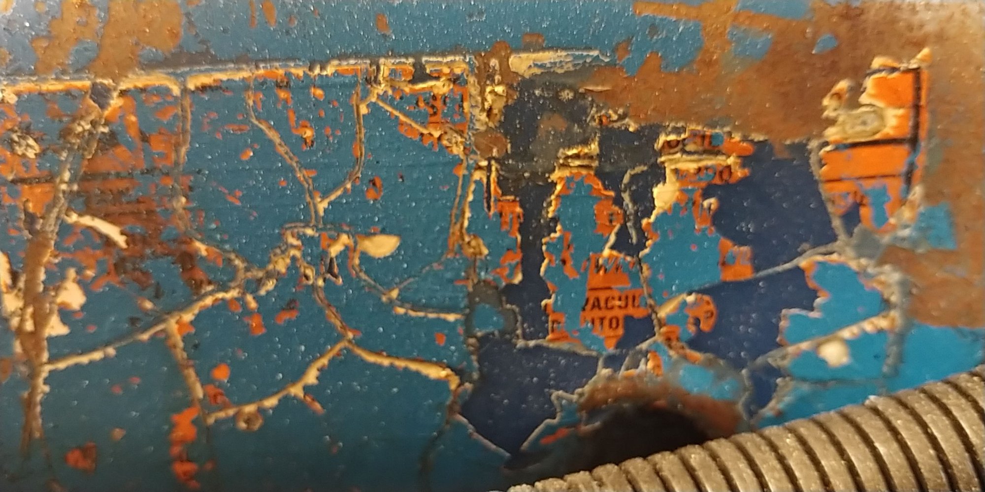

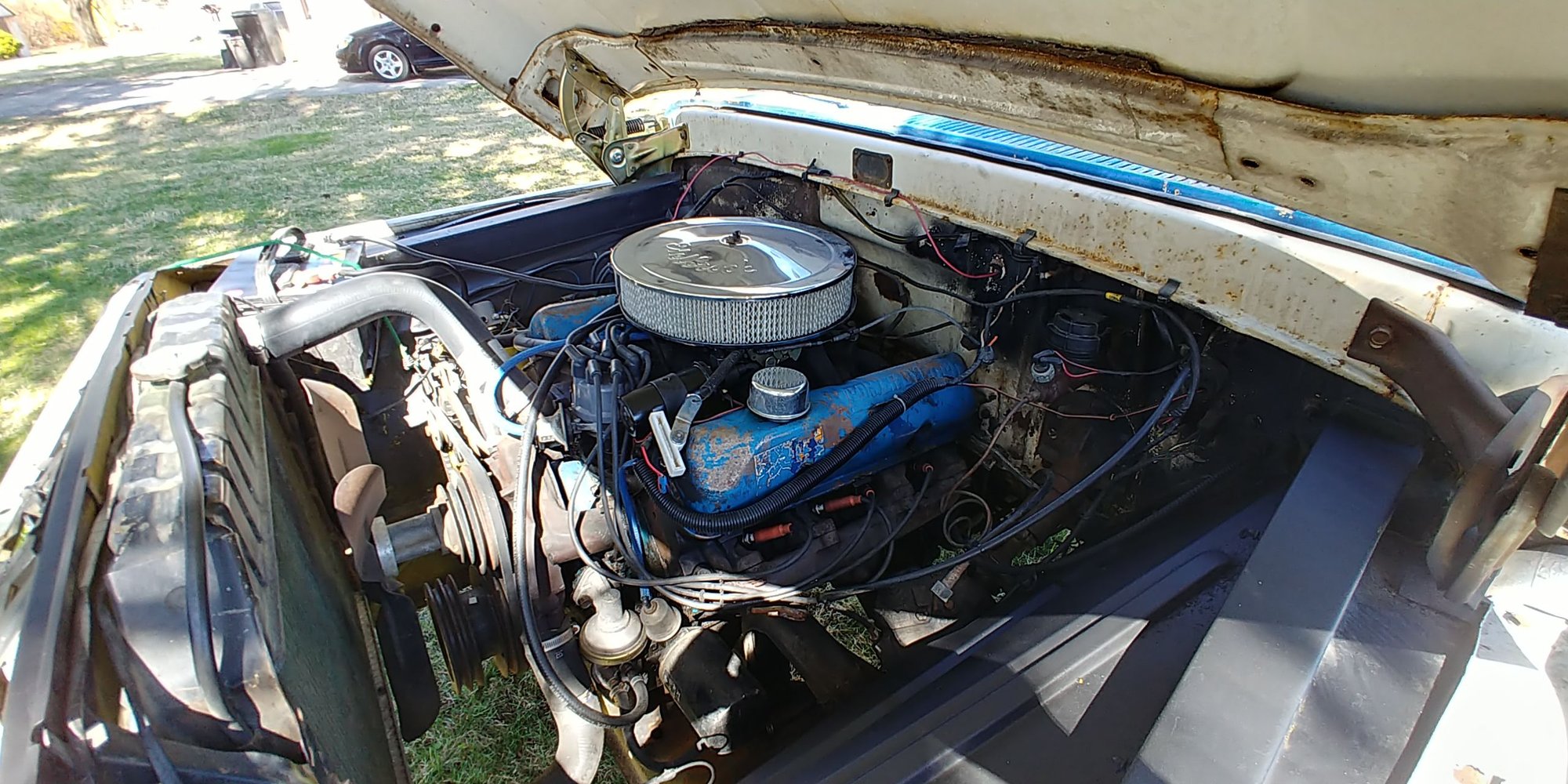

Hi All,
So back a couple months ago I bought this 1965 F250. The guy who I bought it from (who'd had it for decades) swore up and down it has a factory 390ci in it. As we all know, that would be impossible, and the VIN decodes as a 352ci. However, now that the weather is warmer and I have started working on the truck, I see that it has a non-stock C6 trans, and I am thinking that instead of the 352ci that it was born with, that it perhaps has had a 390ci dropped into it at some point. The interesting thing is that the passenger side valve cover has an emission stick on it (barely) that kinda looks like a 302ci sticker. I know it's tough, but can anyone ID this sticker? I looked around the internet but didn't find any 390ci sticker that was orange (they all appear to be white and blue).

Measure the stroke with a wooden dowel thru the spark plug hole.

From the extra pulleys on the crankshaft and water pump it probably came from an automobile also the dark blue paint showing on the valve cover was 66 and up. It looks like there is an external ignition ballast resistor. See if you can find a casting # on the block . As we all know just because if there is a raised 390 showing on the block does not mean that it is.

It doesn't look quite the same but the original 352s had this on the passengers valve cover
https://www.dennis-carpenter.com/en/...case-vent-deca

Post
The rocker cover has a 1970/ VECI (Vehicle Emission Control Information) Decal. So the rocker cover itself is minimum 1970.

Likes: 370
From: PHX AZ
That decal on air cleaner not valve cover. At least of all the original ones I have seen no decal on valve cleaner. Possible California may have been different. Although my '66 Ranger 352 was california DSO and it was on Air Cleaner

If you check all the casting numbers and date codes you should be able to determine better at least exact year, month then check the stroke for Cu In
Definitely have seen some variations with these things. I've seen it on the valve cover quite often.
Here's my valve covers. The few original 1966 I've touched didn't use a sticker but silk screened it on. You can see Dennis Carpenter lists that decal as 1960-1965 F-Series. Must have been cheaper to just silk screen it than to slap on a decal - and maybe held up better? Who knows. Dimensions are slightly different on the silk screen than the decals.
