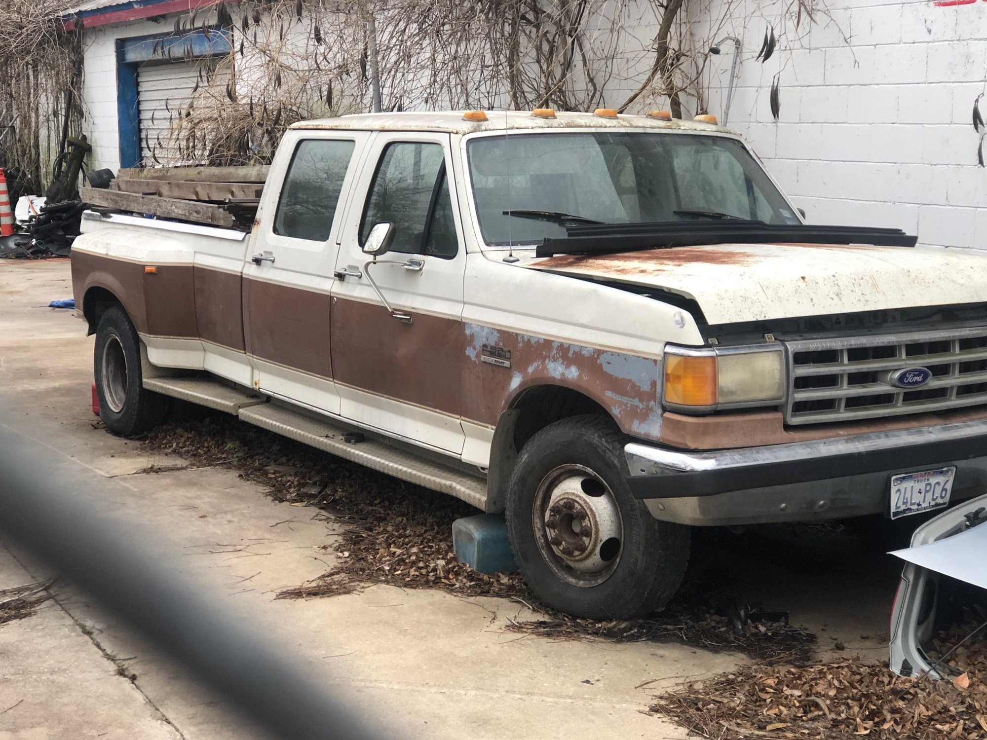

I recently got a new (to me) 1990 f350 with a E4OD. Except the transmission was missing... So i pulled one from my parts truck. The speed sensor was missing from the parts truck. So now i have the donor transmission in the f350 and a new speed sensor, but no speed sensor gear. Im hoping you gentlemen will know what color/tooth count gear i need for a 1990 F350 with a 7.3 diesel, E4OD and 4.10 gears on stock tires. Anyone know what the factory gear would have been?
additional info: the parts truck is an identical twin to my project truck so no worries about having the proper drive gear.
