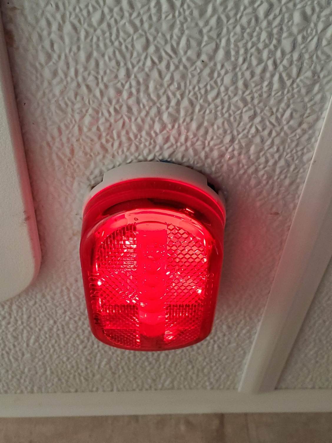

I'm almost done. Final photos tomorrow after the last trim pieces are up and the caulk is applied. I put the lights in tonight. The night light is an LED trailer marker light. The red LED bulbs that came in the fixture were too bright, so I added a short section of red LED strip lights inside the fixture. The lens snaps on so tight that I didn't even secure the strip light in the fixture.

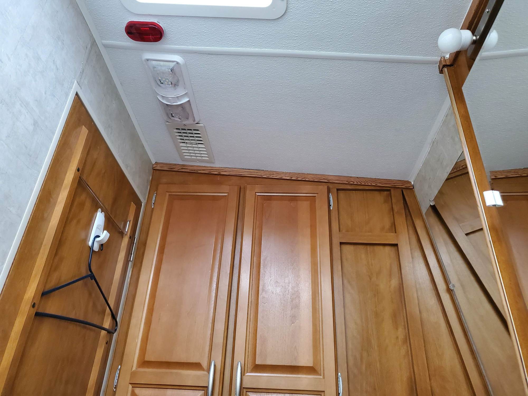

This project is complete, except for some retainers in the shower enclosure.
I went through three different types of trim before settling on the oak stop molding. It doesn't match the grain of the cabinets at all. But I needed something that was thick enough to cover up the gaps and strong enough to not fall apart when a staple was driven into it. The finish color is a close match. I used the same finish on some of the existing cabinet doors and it's close enough to not notice. In this picture you can see the new night light (red), new LED overhead light and the new register.
My lack of skill with trim is rivaled only by my poor skill with caulk. The white plastic molding you see on the left side of the picture had a good 1/2" gap on it. I used a heat gun to bend it closer to the wall (without melting the cheesy wall paper) and then used caulk to fill in the remaining gap. I broke one of the LED vanity bulbs. Geez, those things are expensive!

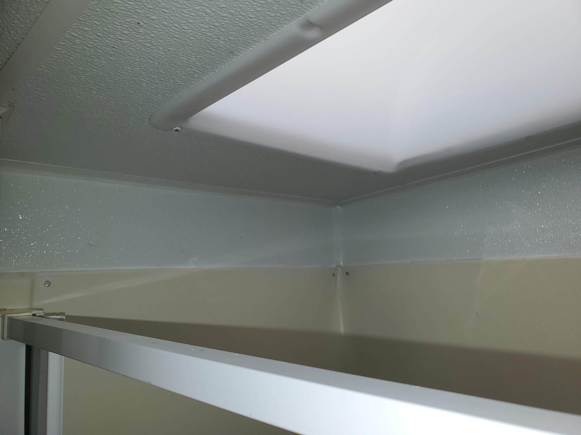

The sky light bottom cover still had the plastic protective wrap from the factory on it. I removed that and it looks like a brand new skylight. I didn't caulk around the skylight. I don't recall there being any caulk there when I took it down. The same panels used on the ceiling were also added above the shower enclosure, mainly because the wall paper was in such bad shape. It think it looks a lot better now and I have zero worry about water getting splashed above the shower enclosure. All joints were caulked to ensure that no humidity from the shower goes into the walls. The holes in the shower enclosure are - as near as I can tell - just automotive push retainer. The ones that were there were so brittle that the head shattered when I tried to remove it. Not one of the retainers came out whole.
